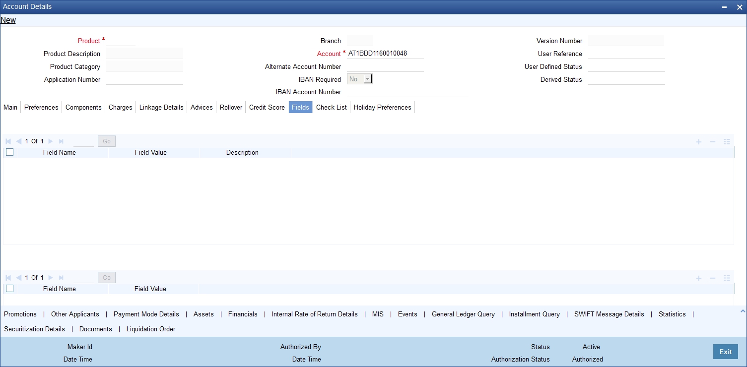

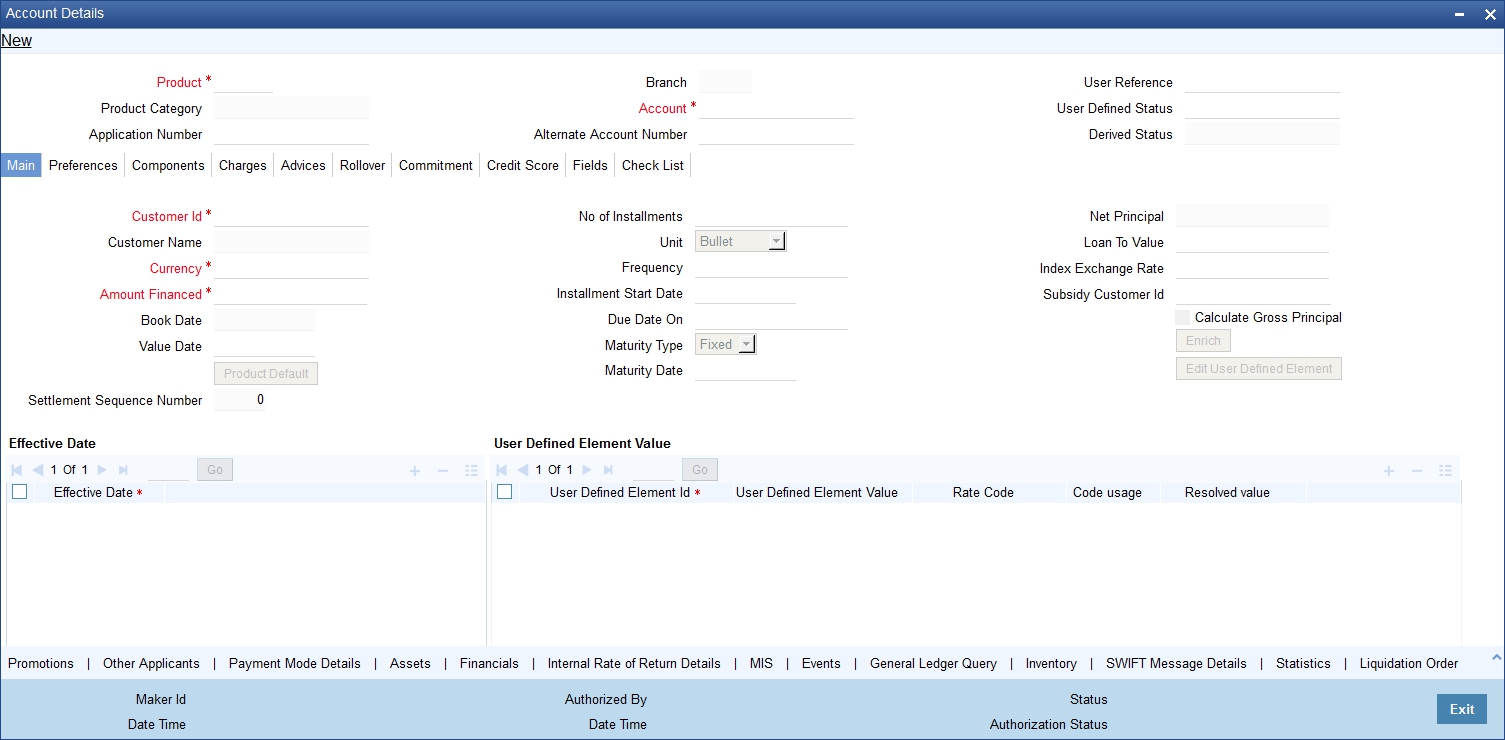

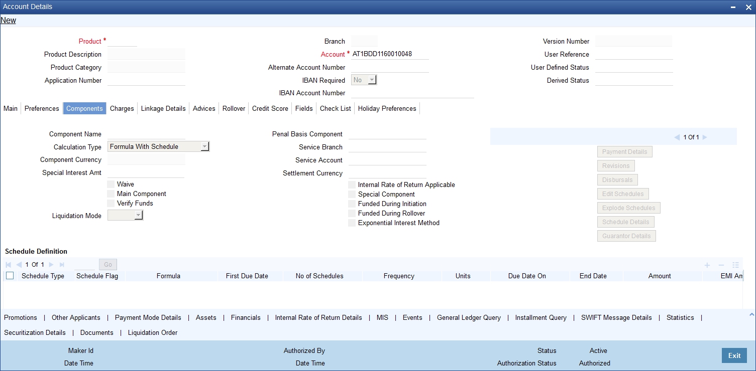

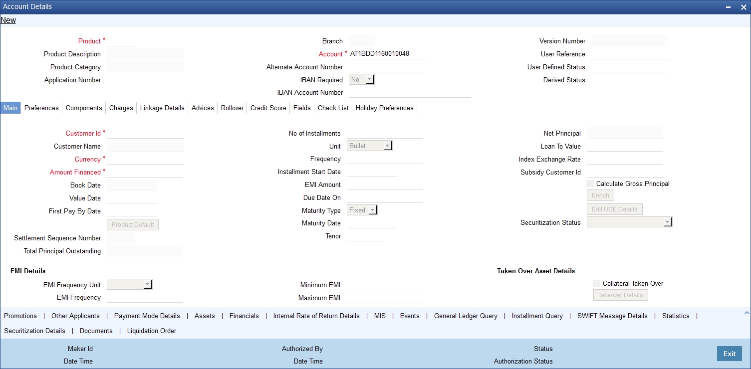

You can create a loan account using the ‘Account Details’ screen. You can invoke this screen by typing ‘CLDACCNT’ in the field at the top right corner of the Application tool bar and clicking the adjoining arrow button.
Click the ‘New’ button on the Application toolbar.
You can specify the following generic details in the Account Details screen:
Product
Click the option list to select a Product Code from the list of values. Double click on a Product Code to select a particular code. The product codes are maintained in the Product Definition screen.
Product Description
The system displays description of the specified product code.
Product Category
The system displays the product category in this field.
Application Number
The system displays the Application Number in this field
Note
This is applicable only if the origination of the loan is in Oracle FLEXCUBE or is interfaced.
Branch
The system displays the Branch Code of the branch into which the user has logged in, for which the UDE values are maintained.
Account
Based on the parameters that setup at the branch level, the account number would be either auto generated or would have to be captured in this field.
Alternate Account Number
Specify the alternate account number in this field. It can be an account number in the existing system from which the account has migrated to Oracle FLEXCUBE.
IBAN Required
Specify if IBAN is required for a loan account from the drop-down list.The options are:
IBAN
If IBAN Required is selected as ‘Yes’ the system displays the IBAN account number based on the IBAN format maintained in ‘Branch Parameters’ (STDBRANC) screen.
Version Number
System displays the version number of the loan account.
User Reference
A 16-digit User Reference Number is autogenerated and displayed here if the ‘Auto Generate User Ref No’ option is checked in the Branch Parameters. The format of the user reference number is BranchCode + ProductCode + Sequence number. You are allowed to modify the auto-generated User Ref No.
If the ‘Auto Generate User Ref No’ in Branch Parameters is not checked then the User Ref No will be blank by default and you have to specify it manually. Validations are done by the system not to save the account if an unsuppressed payment message is present which has the User Ref No as blank.
User Defined Status
After you enter the account number, the system displays the status of the account in this field. This is based on the products status maintenance rules.
If you have opted for status processing at the ‘Group/CIF’ level as part of your branch preferences, the system defaults the value of CIF status as available in the ‘Customer Maintenance’ screen. This status is the worst status among all the loans, savings accounts and current accounts for the customer within the current branch.
Derived Status
The system defaults the status of the individual loan account here. This is derived from the status maintenance rules of the product, during end of day operations.
You can capture the main details of the loan account in this tab.
Customer ID
To select a customer ID, click the option list. A screen called ‘Find Customer Details’ is displayed. You can enter search criteria in this screen. For example, you can enter the customer name or number and click on the ‘Search’ button. The system then fetches you all the details corresponding to the Customer name or account. Once you find all the details, double-click on the record to return to the account details screen.
Customer Name
On selecting the customer ID, the system displays the customer name.
Currency
To select a currency, click the adjoining option list. A list of currencies is displayed. Double click to select a currency.
Click ‘Product Default’ button after entering product code, customer ID, currency and amount financed. The system defaults other details maintained for the selected product. The system also defaults the schedule definitions from the product and computes the detailed schedules. After clicking the ‘Product Default’ button, you cannot change the product code. Also, the system prompts you to click the ‘Product Default’ button once again if you change ‘Customer ID’, ‘Currency’ or ‘Amount Financed’ fields.

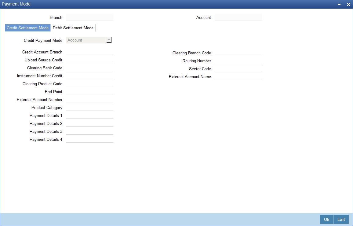

Settlement Sequence Number
The system displays the settlement sequence number during product default. The default value displayed will be zero. You can select a different value from the adjoining list of values and re default the product details.
Note
If the Payment By detail of settlement instruction fetched is maintained as Instrument/Local Clearing, then the system will display an override message while defaulting the settlement accounts. Payment Mode will be Account in settlement details irrespective of the ‘Payment By’ details maintained.

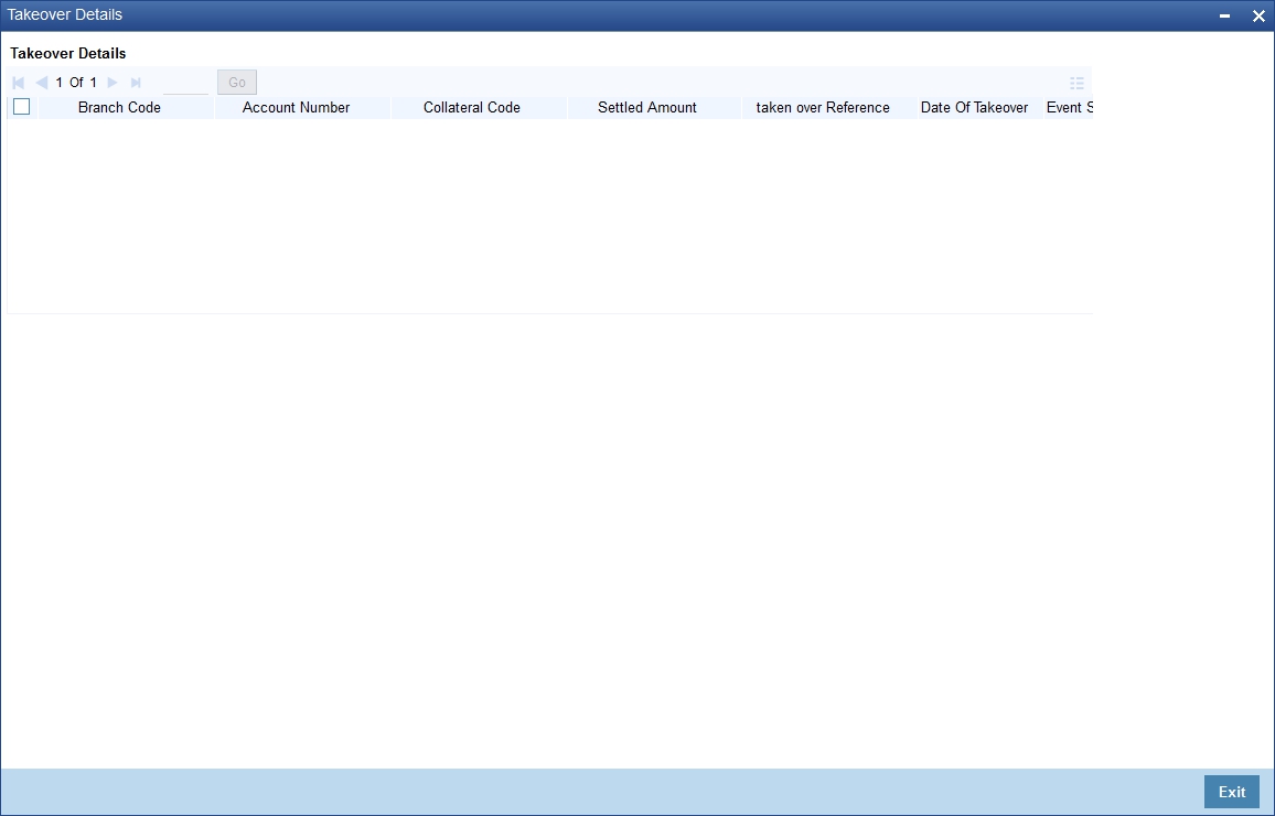

Collateral Takenover
This check box is checked if the collateral linked is been taken over.Click 'Takeover Details' button to view details of the take over.

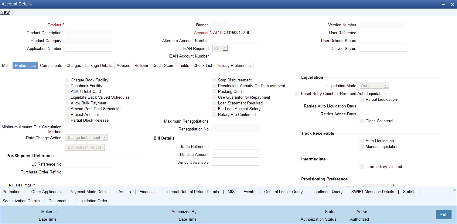

The defaults are maintained by the bank. Depending upon the combination of various preferences, the bank can have various account preferences. The defaults primarily are based on product definition and can be overridden.
You can specify the following details here:
Cheque Book Facility
Check this box to indicate that the cheque book facility should be allowed to loan account.
Passbook Facility
Check this box to indicate that the pass book facility should be allowed to loan account.
ATM/Debit Card
Check this box to indicate that the ATM/Debit card should be provided to the account holder.
Liquidate Back Values Schedules
Check this box to liquidate back valued schedules of a loan.
If this flag is turned on, during initiation, when a loan is input back dated and if there are any installment dues, then all those schedules with a due date less than the system date will be liquidated on initiation .
Allow Bulk Payment
Check this box to indicate whether the accounts under a commitment should be considered for bulk processing. Various disbursements are allowed for a corporate customer and these are treated as loans with separate products and EMI schedules. Assigning individual payments as Bulk payments provides the facility of viewing multiple loans under a single commitment.
Amend Past Paid Schedules
This preference determines if you can modify any feature such as interest rate, installment amount which affects already paid schedules. If you select this option then the paid schedules are recalculated and liquidations on them are recognized as pending as appropriate. Note that this option is applicable only to term loans.
Project Account
Check this box to track the working capital of the project.
Partial Block Release
The partial block release is defaulted from the product maintenance screen. However, this can be overridden at account level.
This field decides whether amount block placed on TD can be released partially (by the principal amount repaid as part of repayment) or not. If this field is not checked, then the block will be released on loan account liquidation only.
On save the system validates the linkage amount with available balance of term deposit. If the term deposit is less than the linkage amount then the system displays an error message as ‘Term deposit available amount is not sufficient for linking.’
On save the system marks a lien on the term deposit by the linkage amount, and with 'Amount Block Type' as 'Loan' and 'Reference No' as loan account number.
On save the system defaults ‘Block Reference No’ in Linkage Details as the amount block reference number of the term deposit account.
Min Amount Due Calc Method
Specify the minimum amount due calculation formula name maintained at the product level.On clicking the ‘Default Method’ button in the ‘Product Definition’ screen, the system will display the Min Amount Due Calc Method with the formula name.
For open line loans:
Rate Change Action
Select the rate change action from the adjoining drop-down list. The available values are:
The system defaults Change Installments as rate change action value. However, you can modify it. The value ‘Change Tenor’ is applicable only for amortized accounts.
Rate Change Action is applicable for ARVN and REVN operations.
Stop Disbursement
Check this box to indicate that the disbursement should be stopped.
Recalculate Annuity On Disbursement
Check this box to indicate that the annuity on disbursement should be recalculated.
Packing Credit
Check this box to indicate the possibility of linking CL Accounts to BC under this product.
For more details on the Packing Credit Sub System and Pre-Shipment Finance refer section ‘Specifying Purchase Details’ in chapter ‘Processing Bills’ of the ‘Bills and Collections’ manual.
Use Guarantor for Repayment
Check this box if you need to consider guarantor account for repayment of loans.

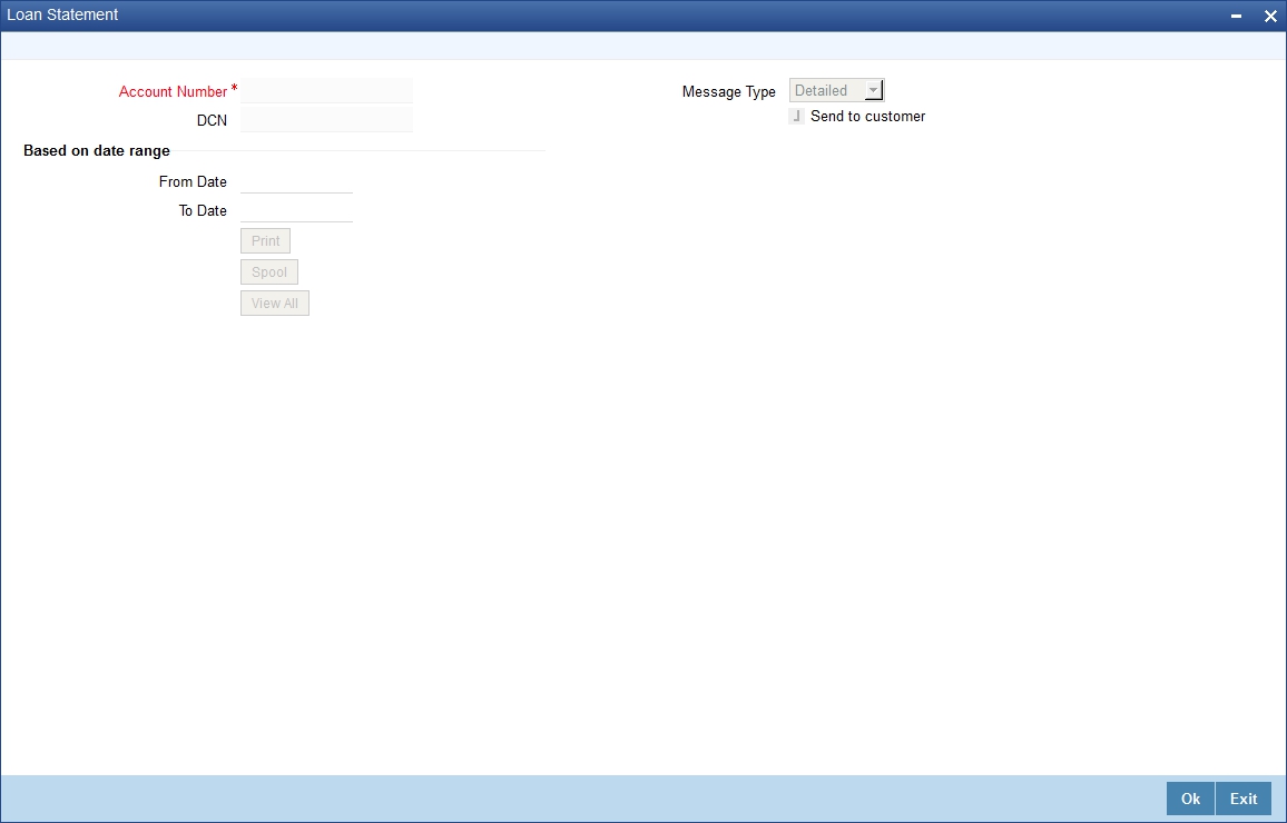

Loan Statement Required
The system defaults this value based on the product preferences. However, you can modify the default value. Check this box to indicate that the loan statement should be generated.
If this field is checked and the loan statement maintenance is not done at product level, the system will display an error at the time of saving the contract.
You need to have linked the ‘CLST_DETAILED’ message to the ‘DSBR’ event (for the product) in order to generate loan advice on each disbursal in the loan account.
For Loan Against Salary
The system defaults this value here based on the preferences maintained in the CL product. However, you can modify it at the account level

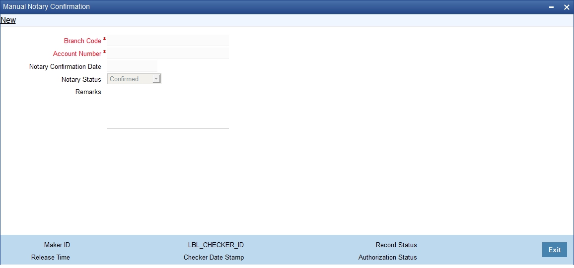

Notary Pre Confirmed
Check this box to indicate that you have already got confirmation from the notary, before creation of the loan.
If the value date of the account is on or before the application date, then ‘NCON’ will trigger INIT and DSBR event for auto disbursement product, else user will need to trigger manual disbursement post the notary confirmation. .
If the value date of the loan is beyond the application date, the system will trigger the NCON event online, once the value date is reached the INIT and DSBR events gets fired, if the loan is under an auto disbursement product.
You can also save a loan account with this option unchecked. Once you receive the confirmation, you can trigger the ‘NCON’ event manually using the ‘Manual Notary Confirmation’ screen.
Refer the section ‘Manual Confirmation by Notary’ in this chapter to see the steps required for getting confirmation from Notary.
Maximum Renegotiations
Specify the maximum number of renegotiation allowed for the account.

You can maintain the following liquidation preferences:
Liquidation Mode
The system defaults the mode of liquidation from the product level. However you can modify the same to indicate the mode of liquidation that you are maintaining. You can select one of the following options:
When a loan is securitized, the system performs following actions during Payments and Charges liquidation:
Reset Retry Count For Reversed Auto Liquidation
If auto liquidation has been reversed in an account, it will be retried depending upon the status of this field. If this option is selected, then the auto liquidation is retried.
Partial Liquidation
If you select this option, system will perform partial auto liquidation
Retries Auto Liquidation Days
When auto liquidation option is chosen and funds are not available, the number of times the system can retry auto liquidation is determined by this field
If blank, the number of retries is infinite.
Retries Advice Days
Number of retries for an advice is defaulted here from the product maintenance level; however, you can modify if needed. The value should be less than the value maintained for ‘Retries Auto Liquidation Days’.
Close Collateral
Check this box if you need to close the collateral on full payment, during auto liquidation.
Note
During auto liquidation, the system will check is this check box is checked and closes the collateral automatically
If Track receivable option is checked for an account, it tracks the amount to be liquidated as a receivable if funds are not available. So upon any subsequent credit, the receivables are blocked and allocated to the pending liquidation.
Auto Liquidation
Select this option to indicate that the Track receivable option is for Auto Liquidations. You can modify this during VAMI/rollover/renegotiation.
Note
This is defaulted from the product level
On schedule liquidation if there are insufficient funds in the settlement account to satisfy the liquidation and if both the product and the account are marked for receivable tracking then system initiates tracking of receivable.
If the account is marked for Partial liquidation, then liquidation happens to the extent of available funds, and the remaining amount is tracked.
If the account is not marked for partial liquidation, and the amount available in the settlement account is less than the due amount, then system won’t do any liquidation and starts tracking the full due amount.

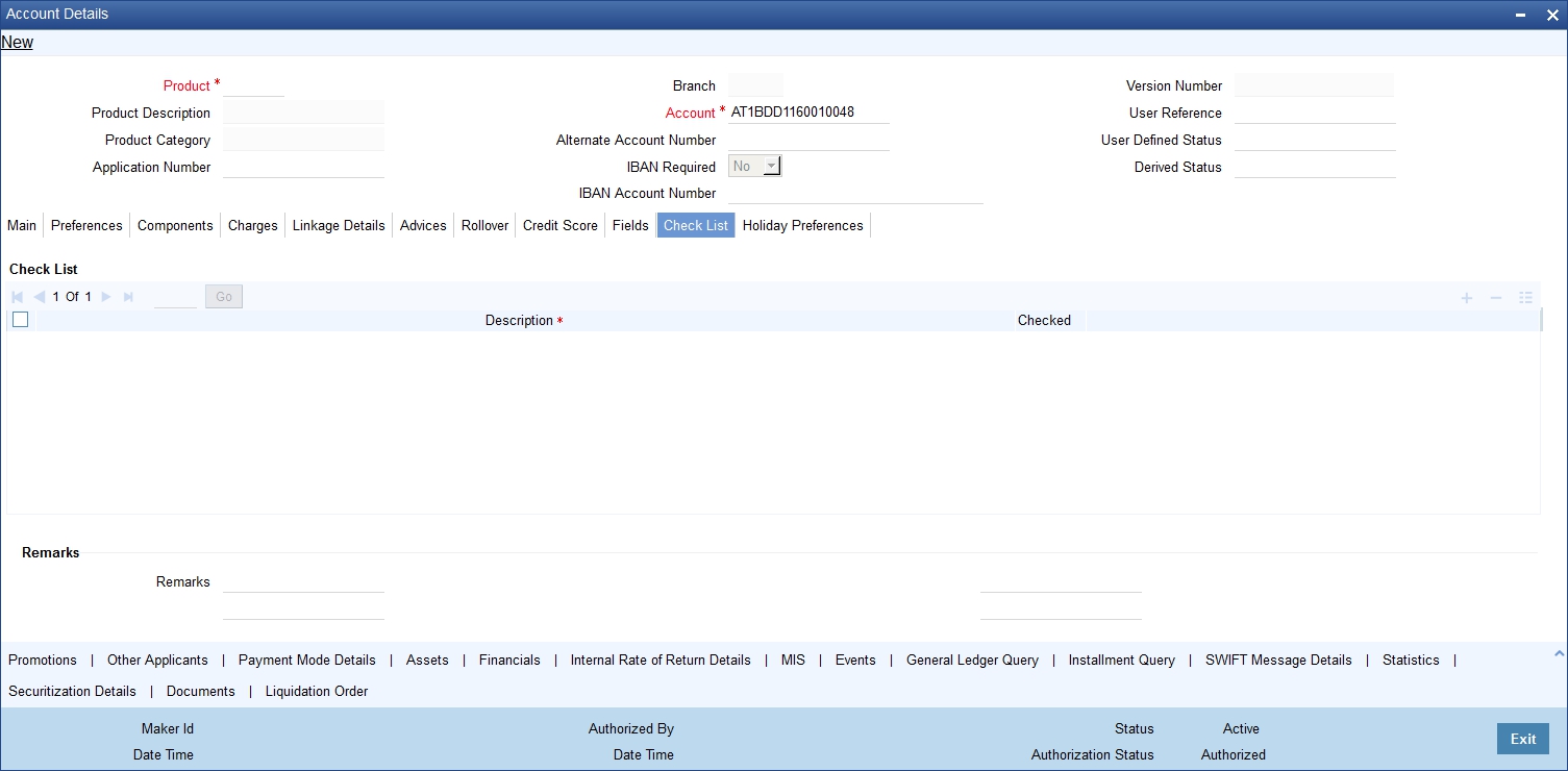

You can specify the following details for the generation of the loan statements:
Start Date
Specify the start date for the loan generation statement, using the adjoining calendar.
Frequency
Select the frequency of the generation of loan statement, from the adjoining drop-down list. The list displays the following values:
Frequency Unit
Specify the unit of frequency for the statement generation.
Note
If the above preferences are not maintained, the system will generate the loan statements as per the loan advices maintained in ‘Notices and Statements’ screen at the product level. If the Loan Statement details are not maintained at the product level, the system will not allow you to maintain the loan statement preferences for the contract. The system checks the product level preferences during EOD or BOD batches. You can also amend the loan statement preferences using ‘Value Date Amendment’ screen.

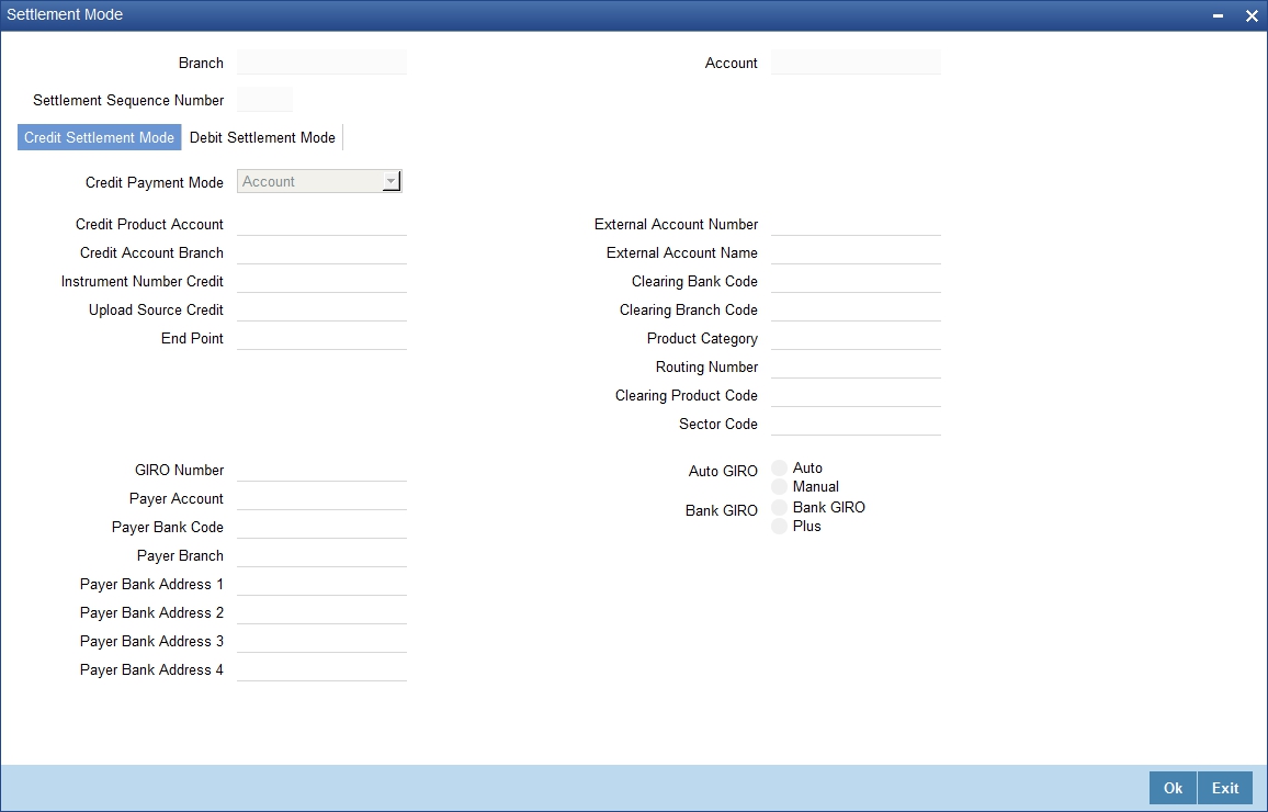

The system displays the following loan settlement details based on the values specified at ‘Value Dated Amendments’ level:

Clicking against the ‘Components’ tab in the ‘Account Details’ screen invokes the following screen:
You can specify the following details for the components:
Component Name
Specify the name of the component.
Calculation Type
To specify the manner in which the component should be calculated and liquidated. You can choose one of the following options:
Formula with schedule (Component Type - Interest)
Component Currency
The system displays the currency associated with the component in this field. The value is defined at Product level.
Special Interest Amt
Specify the amount for the special interest in this field.
Waive
Select this option to waive the component for the account
Note
The system does not select it by default.
Main Component
Check this box to indicate that the specified component should be main component.
Verify Fund
You can indicate whether the system should verify the availability of sufficient funds in the customer account before doing auto liquidation of the component
Capitalized
Select this option if the scheduled amounts are to be capitalized
Liquidation Mode
The system defaults the mode of liquidation from the product level. However you can modify the same to indicate the mode of liquidation of the component from the drop-down list. The following options are available for selection:
Note
This is applicable only if ‘Liquidation mode’ is selected as ‘Component’ at the account preference level.
Penal Basis Component
The system displays the Penal basis for calculating penalty component in this field.
Service Branch
Click the option list to select the branch that services the customer account
Double click on a value to select it.
Service Account
Click the option list to select the account in the service branch.
Double click on a value to select it. All modes except CASA needs service account. Adjustments etc. will be settled through this account.
Settlement Currency
Select the settlement currency for the option list. Click the adjoining option list to choose a settlement currency from the list of currencies. Double click on a value to select it.
In case of a subsidy loan, the system displays the settlement currency based on the subsidy customer ID specified in the ‘Main’ tab. However you can change it. The settlement currency is maintained as a default for both Credits and Debits.
Internal Rate of Return Applicable
Check this option to indicate that the component is to be considered for IRR calculation for the account. This field is applicable to interest, charge and fee components. For adhoc charge, charge, penalty and prepayment penalty components, the value will be defaulted from the product level and you will not be able to modify it.
This field will not be available for input if ‘Accrual Required’ and ‘IRR Applicable’ are left unchecked at the product level.
Note
Special Component
Check this box if the component is a special Interest type. This implies that the computed value of the component can be overridden with the entered value.
Funded During Initiation
Check this box if the component can be funded during the INIT event.
Funded during Rollover
Check this box if the component can be funded during the rollover process.
Exponential Interest Method

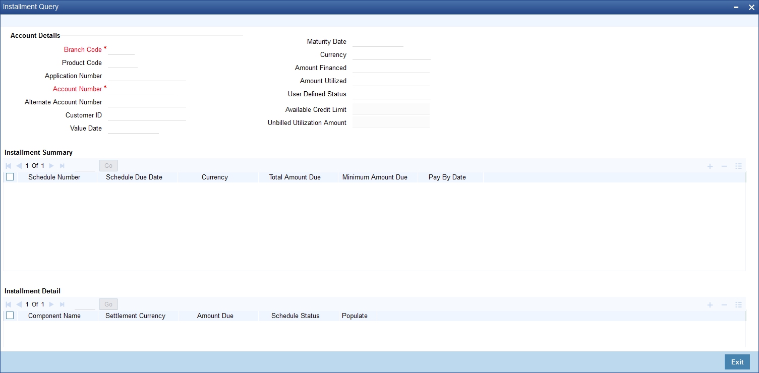

Schedule Number
The system generates and displays a sequential schedule number for installments.
Due Date
The system displays the due date of the payments and disbursements in this field.
Pay By Date
The system will display the pay by date.
Pay by date = (Schedule due date) + (Credit days maintained at product level)
On clicking the ‘Default Method’ button in the ‘Product Definition’ screen, the MAIN_INT schedules are exploded and the system will display the pay by dates based on the value of the First Pay By Date. If you have not entered the first pay by date details then the system will calculate the first pay by date as follows:
(First Schedule Due Date of MAIN_INT component) + (Credit days (product parameter for OLL))
Pay by date for bullet schedule (PRINCIPAL and MAIN_INT) will be the maturity date of the open line loan account.
Amount Settled
The system displays the settlement amount for the schedule in this field.
Amount Due
The system displays the amount due for the schedule in this field
EMI Amount
The EMI that should be repaid in this schedule is displayed in this field.
Click ‘Guarantor Details’ button under the ‘Components’ tab in the ‘Account Details’ screen, to invoke ‘Guarantor Details’ screen.
Note
If you check the ‘Use Guarantor for Repayment’ box and not specify the guarantor details, then the system will display an error message.
You can specify guarantor account details here.
Account
Account number for which repayment is due is defaulted here, from the ‘Account Details’ screen.
Component Name
Name of the component for which repayment is computed is defaulted here, from the ‘Component’ tab in the ‘Account Details’ screen.
You can specify customer details of the guarantor here.
Sequence Number
Serial number of the guarantor account is defaulted here. If multiple guarantor accounts are provided, then the system follows sequence number for the liquidation order.
Account No.
Select a valid customer id for the guarantor from the adjoining option list.
Customer Name
The customer name of the selected customer id is defaulted here.
You can specify account details of the guarantor here.
Sequence Number
Account No
Select a valid account number for the guarantor from the adjoining option list. This adjoining option list displays all valid accounts for a selected customer id maintained at the guarantor customer level.
Note
Account Branch
The current branch code of the selected guarantor account is defaulted here.
Currency
The currency of the guarantor account is defaulted here.
Note
Guarantor currency type can be different from component currency type.

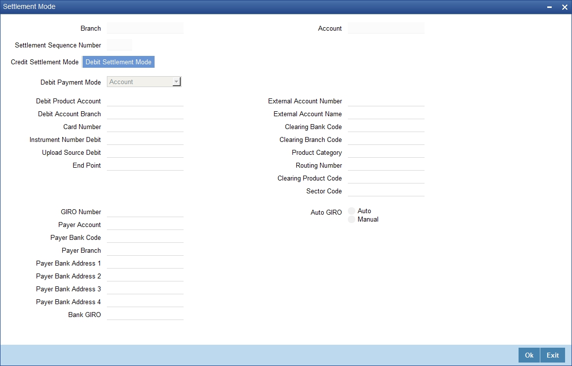

You can specify the details of payment mode in the ‘Settlement Mode’ screen. To invoke the screen, click ‘Payment Mode Details’ button under ‘Components’ tab in the ‘Account Details’ screen.
Here you can specify the following details:
Branch
Specify the branch in which the customer account resides.
Account
Specify the unique number of the account in the specified branch.
The system displays the settlement sequence number during product default. You can change the value from the adjoining list of values.
If the sequence number is altered, click on Re-default Settlement button for settlement account to get re-defaulted. If re-defaulting is done for principal component, then the message details will also be modified based on the new sequence number chosen.
You can specify the credit settlement details under the ‘Credit Settlement Mode’ in the ‘Settlement Mode’ screen.
Credit Payment Mode
Select the credit payment mode from the adjoining drop-down list. The list displays the following values:
Credit Product Account
Specify the account number of the credit product.
To view the joint holder’s details of an account and the mode of operation maintained at the account level, place the cursor on the Credit Product Account field and press Ctrl+J. The system displays the ‘Joint Holder’ screen.
For more information on the ‘Joint Holder’ screen refer to the section ‘Joint Holder Maintenance’ in the Core User Manual.
Credit Account Branch
Specify the name of the branch in which the credit account should be maintained.
Instrument Number Credit
Specify the instrument number that should be used for credit payment.
Upload Source Credit
Specify the upload source that should be used for credit payment.
End Point
Specify the end point maintained in the clearing system. The adjoining option list displays all valid end points maintained in the system. You can choose the appropriate one.
External Account Number
Specify the external account number.
External Account Name
Specify the name of the beneficiary who is holding the external account.
Clearing Bank Code
Specify the code of the external bank that should be used for clearing maintenance. The adjoining option list maintains all valid banks maintained in the system. You can choose the appropriate one.
Clearing Branch Code
Specify the branch code of the specified external bank that should be used for clearing. The adjoining option list displays all valid codes maintained in the system. You can choose the appropriate one.
Product Category
Specify the category of the product. The adjoining option list displays all valid products maintained in the system. You can choose the appropriate one.
Routing Number
Specify the routing number of the specified branch for clearing.
Clearing Product Code
Specify the product code that should be used for clearing. The adjoining option list displays all valid code maintained in the system. You can choose the appropriate one.
Sector Code
Specify the code of the sector that should be used for clearing. The adjoining option list displays all valid codes maintained in the system. You can choose the appropriate one.
Giro Number
Specify the GIRO number of the corporate customer.
Payer Account
Specify the account from which the amount should be paid.
Payer Bank Code
Specify the code of the payer’s bank that should be used for the payment of amount.
Payer Branch
Specify the branch of the specified payer’s bank that should be used for the payment of amount.
Payer Bank Address 1-4
Specify the address of the bank that should be used for the payment of the amount.
Bank GIRO
Indicate the type of bank GIRO that should be used for corporate customers. You can select one of the following:
Auto GIRO
Indicate the type of the Auto GIRO for automatic direct debit. You can select one of the following values:
Exchange Rate
For a customer availing any Relationship Pricing scheme, the customer specific exchange rate derived by adding the original exchange rate and the customer spread maintained for the relationship pricing scheme gets displayed here.
You can change the defaulted rate provided the change is within the variance level maintained for the underlying product.
If Relationship Pricing is not applicable, Exchange Rate will be the same as the Original Exchange Rate.
For more details on customer specific exchange rates, refer the section titled ‘Specifying Pricing Benefit Details’ in Relationship Pricing user manual.
Negotiated Cost Rate
Specify the negotiated cost rate that should be used for foreign currency transactions between the treasury and the branch. You need to specify the rate only when the currencies involved in the transaction are different. Otherwise, it will be a normal transaction.
The system will display an override message if the negotiated rate is not within the exchange rate variance maintained at the product.
Negotiated Reference No
Specify the reference number that should be used for negotiation of cost rate, in foreign currency transaction. If you have specified the negotiated cost rate, then you need to specify the negotiated reference number also.
Note
Oracle FLEXCUBE books the online revaluation entries based on the difference in exchange rate between the negotiated cost rate and transaction rate.
The base or actual exchange rate between the account currency and settlement currency gets displayed here.
If the Credit Payment Mode is External Account, then you can specify the payment details in the following fields:
While creating outgoing payment during auto disbursement process, the payment details are passed to the PC transaction.
You can specify the debit settlement details under the ‘Debit Settlement Mode’ in the ‘Settlement Mode’ screen.
Debit Payment Mode
Select the Debit payment mode from the adjoining drop-down list. The list displays the following values:
Note
If the Debit Settlement mode is selected as PDC, then the other debit settlement details are not maintained.
If the debit Settlement is PDC then the liquidation mode of the component should be manual.
The Debit Settlement can be chosen as PDC only when contract is amortized.
Debit Product Account
Specify the account number of the debit product.
To view the joint holder’s details of an account and the mode of operation maintained at the account level, place the cursor on the Debit Product Account field and press Ctrl+J. The system displays the ‘Joint Holder’ screen.
Debit Account Branch
Specify the name of the branch in which the debit account should be maintained.
Instrument Number Debit
Specify the instrument number that should be used for debit payment.
Upload Source Debit
Specify the upload source that should be used for debit payment.
End Point
Clearing Bank Code
Product Category
Routing Number
Sector Code
Payer Account
Payer Bank Code
Payer Branch
GIRO Number
Bank GIRO
Auto GIRO
Exchange Rate
Note

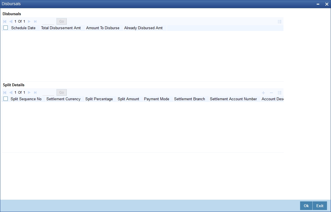

Oracle FLEXCUBE allows you to maintain split details for schedule-wise auto disbursement in a loan account, only if you have set the disbursement mode to ‘Auto’ in the account preferences tab of the Product Maintenance screen (CLDPRMNT).
In the Account Details (CLDACCNT) screen, click ‘Product Default’ button after entering product code, customer ID, currency and the amount. The system defaults the product level component and schedule details of the selected product in the component tab of the account details screen After you click ‘Product Default and ‘Enrich’ buttons, the system disables the schedule definition section in the component tab. However you can modify the disbursal amount and the number of schedules for the disbursal by clicking ‘Edit Schedules’ button.
You can view the disbursement schedule and maintain the schedule-wise CL split details for auto disbursement in the Disbursal screen. To do this, first select the principal component in the component tab and then click on ‘Disbursals’ button. The screen is as shown below:
The system displays the list of Schedules for the disbursements and their corresponding Disbursement amounts.
Schedule Date
The system displays the due date of the schedule.
Total Disbursement Amt
The system displays the total disbursement amount for the specified CL account.
Amount to Disburse
The system displays the amount to be disbursed.
Already Disbursed Amt
The system displays the amount which has been disbursed.
Note
Oracle FLEXCUBE allows auto disbursal only for the principal component.
You can maintain the following split details:
Split Percentage
Specify the split percentage of the disbursement amount.

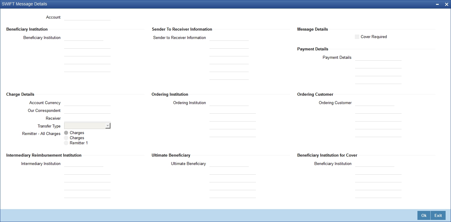

Click on the Message details button to view the swift message details for each split disbursal. The swift party details will be populated based on the settlement sequence provided for each split disbursal. You can view and edit the party details.
For details on Message Details, please refer to the section ‘SWIFT Message Details Button’ in this chapter.
Select the Principal Component. Click ‘Disbursals’ to see the Disbursal schedule. This gives the list of Schedules for the disbursements and their corresponding Disbursement amounts.
You can check the details of the due date of the schedule and the Amount to be disbursed from the Sch Due date field and the Amount To Disburse field respectively.

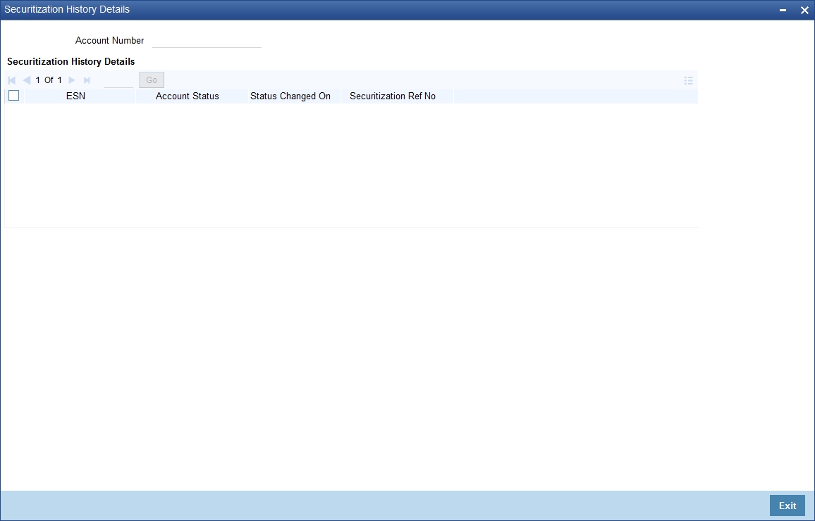

If any disbursal results in a status change for the account, the system will update the current status for the account in the ‘Derived Status’ field. During end-of-day batch processing, it will update the ‘User Defined Status’ for the account with the worst status that is available for all accounts and loans for this CIF and post the required accounting entries for the change.
During Amendments/Disbursements, post securitization the system raises an alert message saying ‘The loan account has been securitized’.
Note
In such cases, you need perform the amendments/disbursement after getting the approval from SPV.

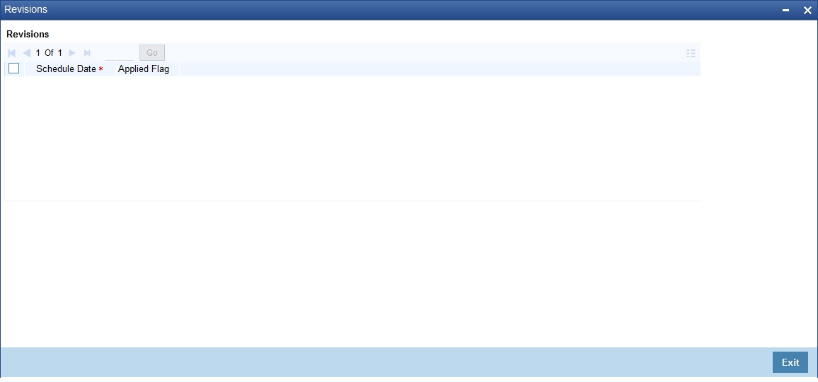

Select a component which has rate revision defined. To view the details of the Rate revision schedule, click the ’Revisions’ button. This lists the details of the revisions done on the Components.
This lists the revision date against the component name. This also has an application option which displays if the revision was applied or not.
You can check the details of the name of the component that is revised and the date when it has been revised from the field Component name and Revision date respectively.

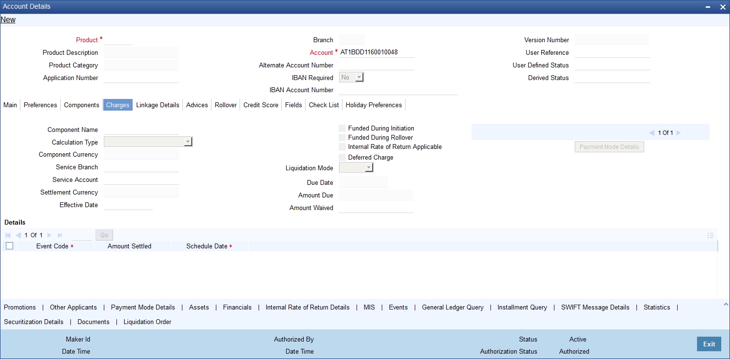

This module is used for calculating and applying charges on an account. To calculate the charges that we would like to levy on an account, we have to specify the basis on which we would like to apply charges. For example, we may want to apply charges on the basis of the debit turnover in an account. When we define a Charge product, we have to specify the Charge basis.
When we apply the charge product on an account or an account class, charges for the account will be calculated on this basis..
The following details are captured:
Component Name
System displays the component name here.
Calculation Type
Component Currency
The system displays the currency associated with the component. The component currency is defaulted from the Product level.
Service Branch
The branch that services the account - Any Valid, Open Branch
Service Account
Denotes the account in the service branch. A valid open account in the service branch .The service account is needed for all modes apart from CASA. The adjustments etc will be settled through this account.
Settlement Currency
Click the option list to choose the details of the currency in which the payments are to be made in this field. A list of currencies is displayed. Double click on a value to select it.
Effective Date
Enter the details of the date from which the charge is applicable in this field
Funded during Initiation
Select this option if the component can be funded during loan initiation
Select this option if the component can be funded during the rollover process
For each component, the following details are displayed:
Deferred Charge
If this option is checked, the charge defined for the charge component is deferred. This is defaulted from the Loan product maintenance and you cannot modify this.
Due Date
The date on which the charge was applied
Amount Due
Enter the details of the amount due for repayment in this field.
Schedule Date: The scheduled date for repayment in this field

Taken Over Collateral
The system displays the taken over collateral as ‘Yes’ if the collateral is taken over. The system defaults the status as ‘No’ if the collateral is not taken over.

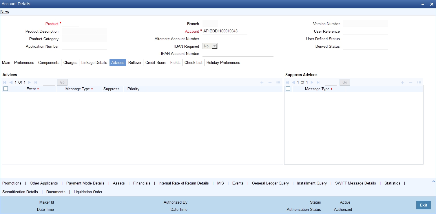

Advices that may be generated whenever the account level status changes or whenever a particular event is fired can be linked at the Product level. Priorities of the advice can be changed and also a particular advice for an event can be suppressed.
Generation of an advice across the life of the account can also be suppressed.
You can specify the following Advice details:
Message Type
The system displays all the advices for all the events for the account. The list will include all the advices that are defined at the product level
Suppress
This field allows you to suppress the generation of the advice for a particular event. The options are ‘Yes’ and ‘No’.
Priority
Click the option list to select the priority of generation. A list of values is displayed. Double click on a value to select it.
The options are High, Medium or Low
The generation of an advice across the life of the account can be suppressed.
Message Type
Click the option list to select the type of advice, the generation of which can be suppressed across the account. A list of values is displayed. Double click on a value to select it.
The list includes advices defined at the product level
You can suppress the Payment Message defaulted in case you do not need a credit through swift message.
The message is automatically suppressed if the Principal Credit Settlement account is changed to a GL or if the receiver in ‘Swift Msg Details’ screen is not valid to receive the message i.e, if the Customer Type of the Receiver party is not a Bank.
Also, if the settlement mode for PRINCIPAL component is anything other than CASA, the swift message is automatically suppressed.
If the Transfer Type is chosen as blank i.e, neither Customer Transfer nor Bank Transfer, then PAYMENT_MESSAGE will become CREDIT_ADVICE by Swift(MT910) if the Receiver is a bank and the credit settlement account is a current account.

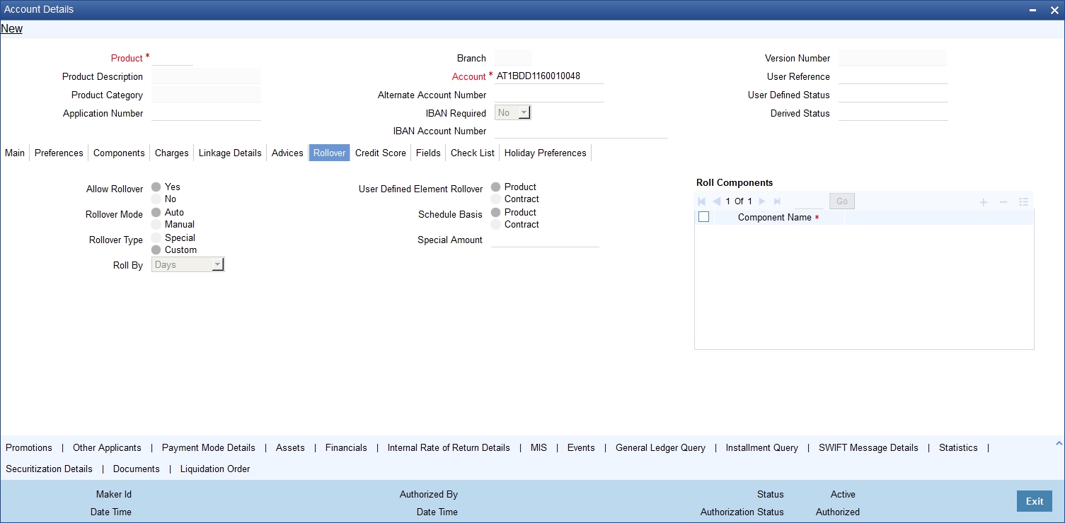

You can maintain the following details here:
Allow Rollover
Select the required option to indicate if rollover should be allowed for the loan or not. The options are:
Rollover Mode
This option is used to determine if the Rollover is system driven or not .You can select either of the following options:
Note
By default, the system selects the ‘Auto’ option
The system by default does not select the option Contract
Roll By
Specify the basis for rollover. It could be any of the following:
Rollover Type
Select either of the following options:
User Defined Element Rollover
Select the required option to determine if at the time of rollover the UDE value would be defaulted from the product or from the account /Contract
Note
Schedule Basis
This flag will determine if at the time of rollover the schedule would be defaulted from the product or from the account/Contract
Note
You can maintain the following detail here:
Component
This option is applicable when Rollover Type is Custom. The option list provided will display the components relevant to the account from which you can choose the components that are to be rolled over.

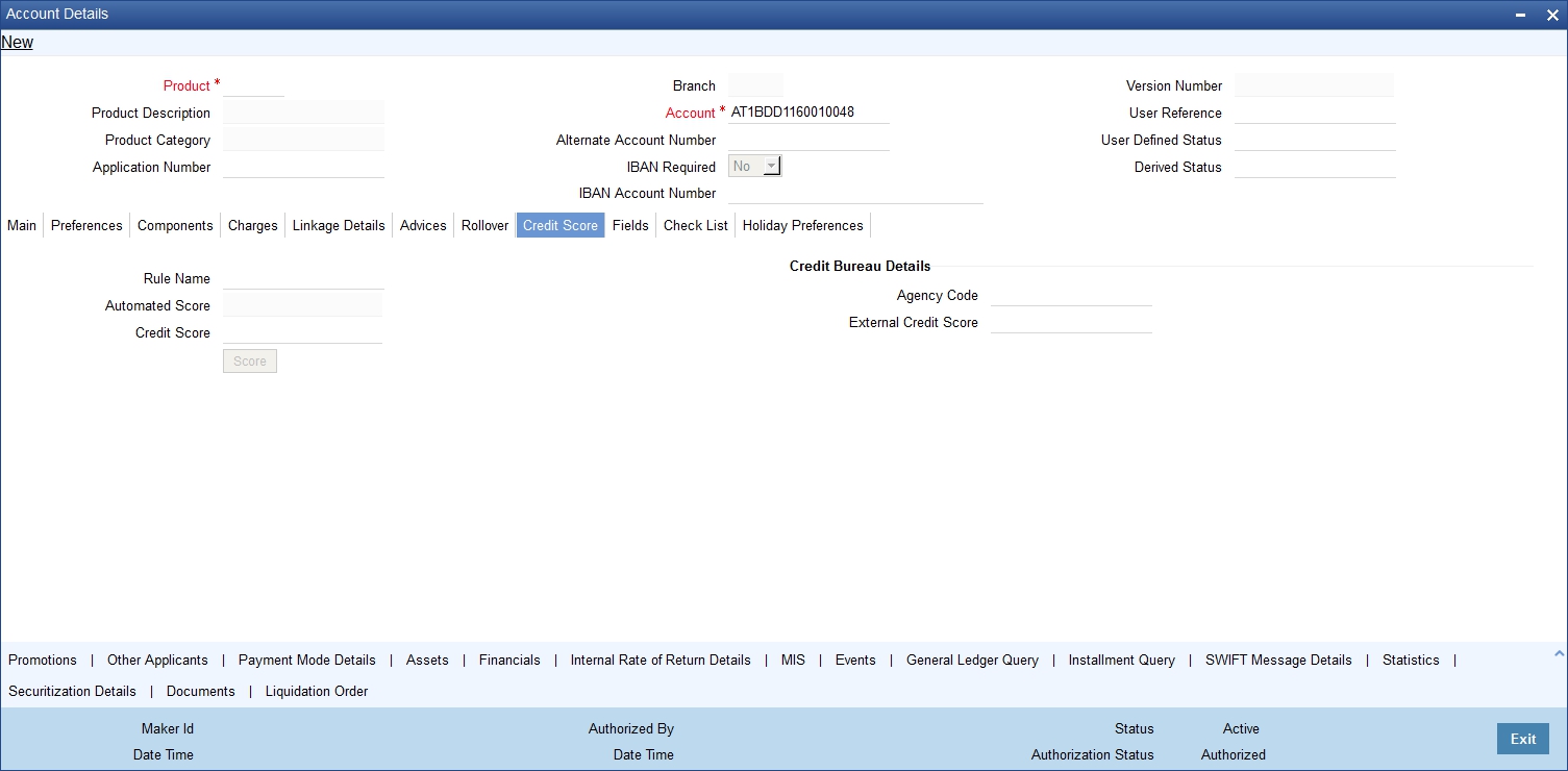

Click ‘Credit Score’ tab to specify the details for calculating the credit score.
You need to specify the following details here:
Rule Name
The rule associated with the loan product gets defaulted here. You can modify this, if required.
Automated Score
The credit score calculated by the system based on the rules maintained at the product level gets displayed here
Agency Code
Select the code of the external agency, to be approached for calculating the score
External Credit Score
The score as calculated by the external agency is displayed here
Click ‘Score’ to auto-generate the credit score for the customer. Click ‘External Score’ to auto-generate the credit score for the Bureau.
The User Defined Fields are defined at the Product level. These fields are available in the UDF button at the time of account creation.
The following details are displayed/captured here:
Field Name
The UDF descriptions defaulted from the Product screen are displayed. The system displays all the UDF descriptions defined at the Product level
Field Value
Specify the UDF value in this field. This is applicable only if the user input or list of values is defined at the time of creation of the UDF

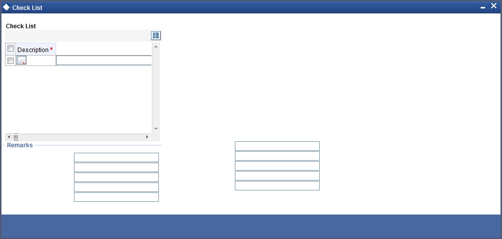

The Check lists are maintained in the ‘Check List Maintenance’ screen and are linked to different events of the contract. The checklist maintained for the BOOK event is available in the Checklist button at the time of account creation.
The following details are captured here:
Description
The description of the check list maintained for the BOOK event is displayed here
Checked
Check this box to indicate that the check list item has been verified
Remarks
Specify any additional remarks about the check list or the account in this free format text field

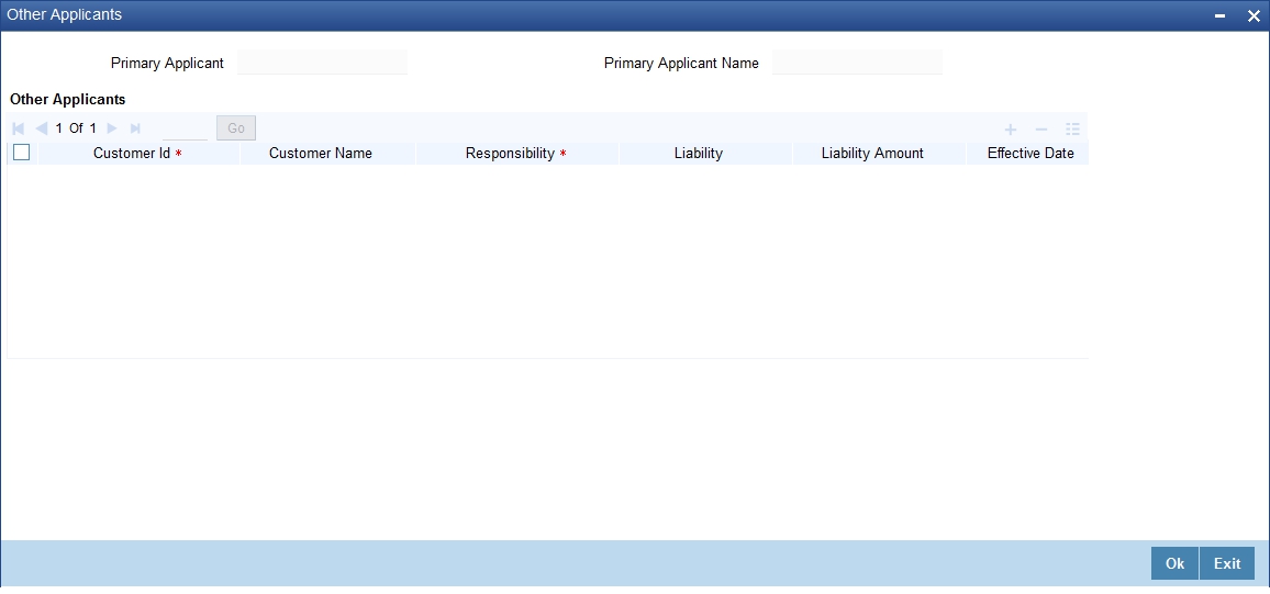

You can maintain the primary and other applicants details in the ‘Other Applicants’ screen. Click the ‘Other Applicants’ button to invoke the screen.
You can maintain the following details of the Primary applicants:
Primary Applicant
This detail is defaulted from the main screen. Enter the Customer ID of the primary applicant in this field
Primary Applicant Name
After you enter the Customer ID, the system displays the Name of the primary applicant in this field
The details of the liability parties to the account are maintained in this field. Other Applicants of a loan include Co-signers and Guarantors.
You can specify the following details of the Co-applicants:
Customer ID
To select the customer ID of the co-applicant, click the option list. A list of customer IDs is displayed. Double click to select the customer ID of the co-applicant.
Customer Name
After you enter the name of the Customer, the system displays the name of the customer in this field.
Responsibility
Select the details of the co-applicants and their responsibility as a Co-signer or as a guarantor from the option list. You can enter the details like the guarantor, co-signer, main addressee, advice notice receiver, and borrower etc., who is relevant to a joint account relationship. During initiation of the account, the primary customer is defaulted to ‘Borrower’ with 100% Liability and value date as the effective date. You are allowed to maintain multiple applicants (customer id) for a loan with the same responsibility (Borrower).
Note
While there is no processing impact, the difference will become important when the original debtor is absconding and the loan is unpaid etc.
Liability
Specify the contribution of the co-applicants to the Loan. You can specify the Liability of the co-applicant if any, in case of a Loan default. You can also specify the percentage of interest split among different co-applicants. It is not made mandatory to maintain ‘Liability %’ for the responsibility ‘Borrower’. There could be borrowers with 0% liability.
Note
The sum of ‘Liability %’ for all the customers of a loan to be equal to 100%
Liability Amount
The system calculates and displays the upper limit of the liability in terms of the amount in this field. You may override the computed value.
The debit and credit settlement mode details for the account can be maintained in the ‘Settlement Details’ screen. You can invoke this screen by clicking the ‘Payment Mode’ button in the ‘Main’ tab.
The options for debit mode are CASA, Credit Card, Debit Card, Clearing, External Account, Electronic Pay Order, Internal Check, Instrument, GIRO and Cash/Teller.
The options for credit mode are CASA, Clearing, External Account, Instrument, and Cash/Teller.
The card must be a valid card whose number can be checked with a modulo logic or maintenance file
Product or Account: If the payment mode is Account, this field specifies the CASA / GL account to be debited. If the payment is through Instrument / Cash, it denotes the teller product to be used.

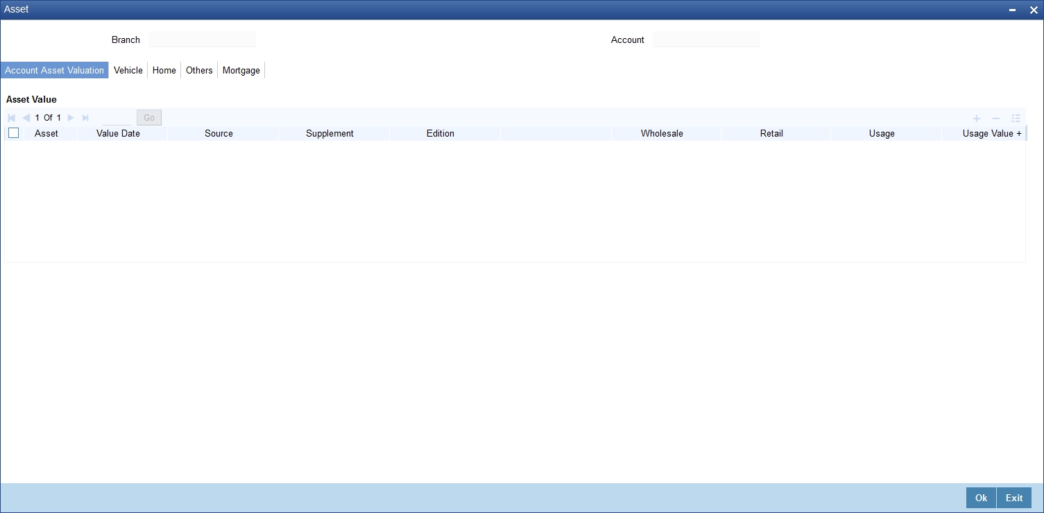

You can capture valuation details of the asset in this tab.

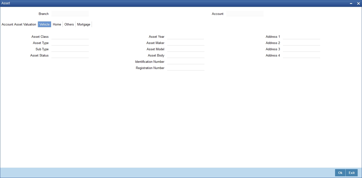

Here, you can specify the following details related to your assets like vehicle, home, etc.
Assets
Select the type of asset from the drop-down list. The following values are provided for selection:
Value Date
Specify the valuation date for the selected asset, or select the date by clicking the ‘Calendar’ button.
Source
Specify the source associated with the asset selected
Supplement
Specify the supplement of the valuation source used for the valuation
Edition
Specify edition of the valuation source used for the valuation
Wholesale
Specify the wholesale rate associated with the asset selected
Retail
Specify the retail rate associated with the asset selected
Usage
Specify usage level at the time of the valuation
Usage Value +
Specify the initial usage value
Total Transaction Value
Specify the total transaction value of the asset.
You can capture details regarding the asset of type ‘vehicle’ in this tab
You can specify the following common details associated with asset of type vehicle:
Asset Class
Select the class associated with the asset selected, from the option list. The following options are provided:
Type
Specify the type of the selected asset here
Sub Type
Specify the subtype associated with the asset, if any
Asset Status
Select the status of the asset selected, from the option list. The following options are provided:
Asset Year
Specify the year of association with the selected asset
Asset Make
Specify the make of the selected asset. For vehicle, you can specify the manufacturing company name and for home you can specify the name of the builder or developer.
Asset Model
Specify the model of the selected asset.
You need to specify the following details additional related to vehicle type of asset:
Asset Body
Specify the body number associated with the vehicle
Identify Number
Specify the unique identification number associated with the vehicle
Reg#
Specify the registration number of the vehicle
Address
Specify the address associated with the asset

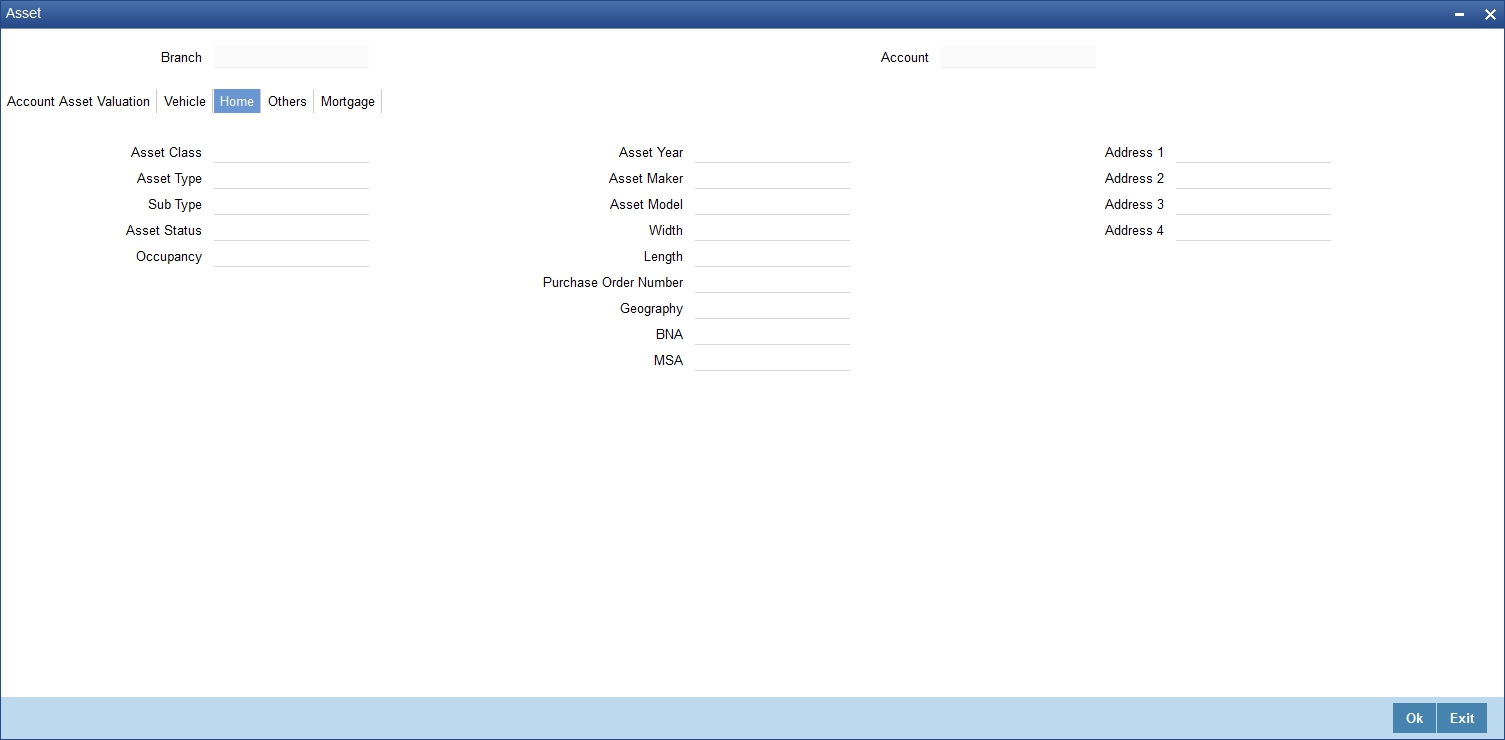

You can capture details regarding the asset of type Home in this tab
You can specify the following additional details for home type of asset:
Occupancy
Specify the number of people occupying the house
Width
Specify the width associated with the selected asset
Length
Specify the length associated with the selected asset
Purchase Order Number
Specify the post office number of the location of the property
GEO
Specify the property GEO code (Geospatial Entity Object Code) for the asset
BNA
Specify the census tract/BNA code (Block Numbering Area) for the asset
MSA
Specify the metropolitan statistical area (MSA) code for the asset
Click ‘Ok’ to save the details.

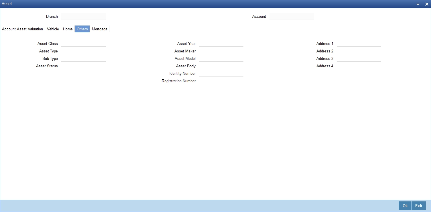

You can capture other asset details here.
Specify the following details:

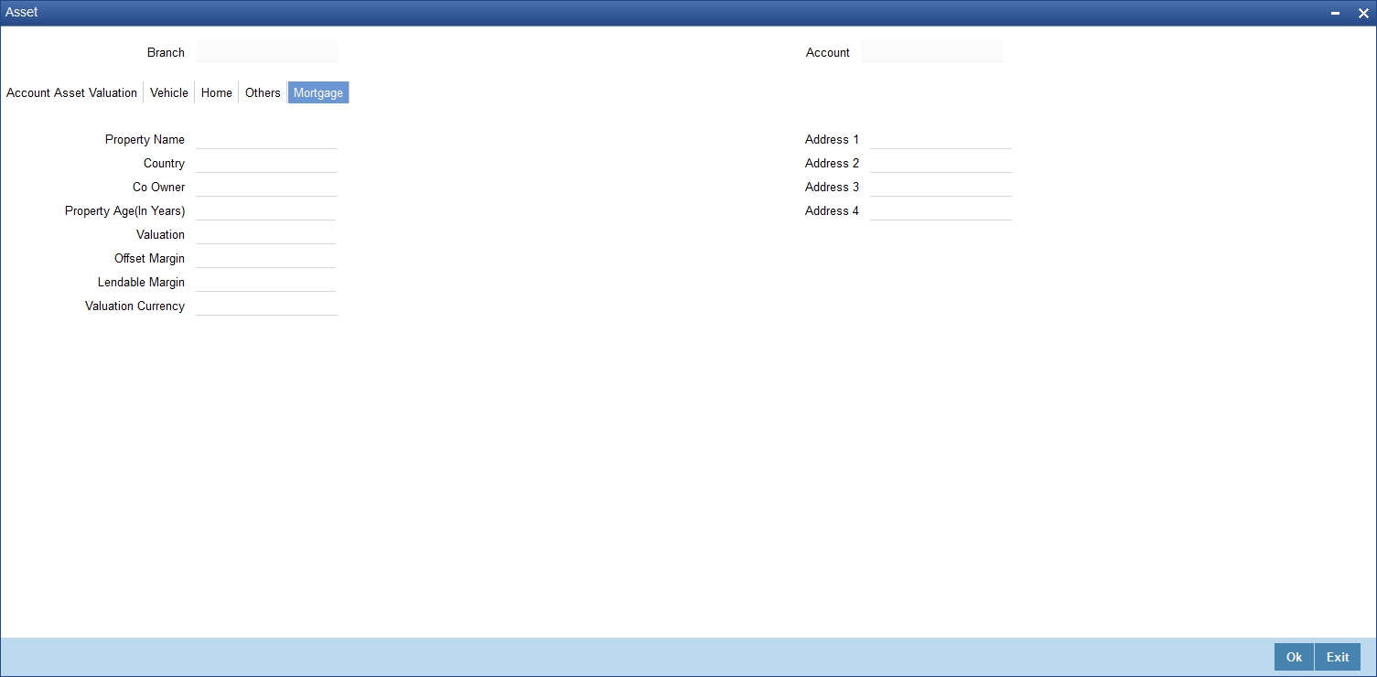

You can capture details regarding the asset of type Mortgage in this tab.
Here you can specify the following mortgage type asset:
Property Name
Specify the name of the mortgage property.
Collateral Category
Specify the category to which the collateral belongs.
Country
Specify the name of the country to which the mortgage property belongs.
Co-Owner
If the property is jointly held, specify the name of the co-owner of the property.
Property Age (in Years)
Specify the age of the property in terms of number of years.
Valuation
Specify the actual value of the mortgage property.
Offset Margin
Specify the offset margin of the mortgage property.
Lendable Margin
Specify the margin that should be allowed for lending.
Valuation Currency
Specify the currency in which the property has been valued. The option list displays all valid currencies maintained in the system. Choose the appropriate one.
Property Address
Specify the address details of the property.

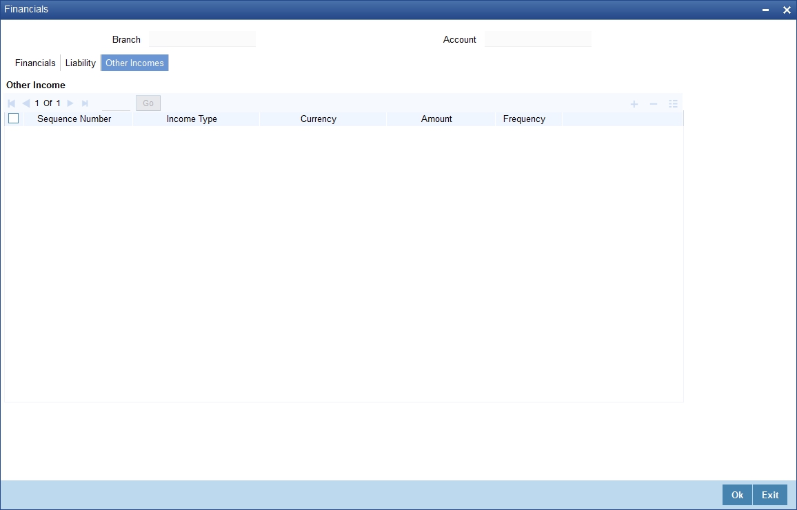

You can capture the income or liability details of the customer in the ‘Financials’ screen. To invoke this screen, click ‘Financials’ in ‘Account Details’ tab of the Account Details screen.
You can specify the following details related to the customer’s income here:
Finance Type
Select the type of the income from the option list provided
Finance Source
Specify the source of the income
Currency
Select the currency associated with the income, from the option list provided
Amount
Specify the amount associated with the income
Comment
Specify any remarks or comments for the income

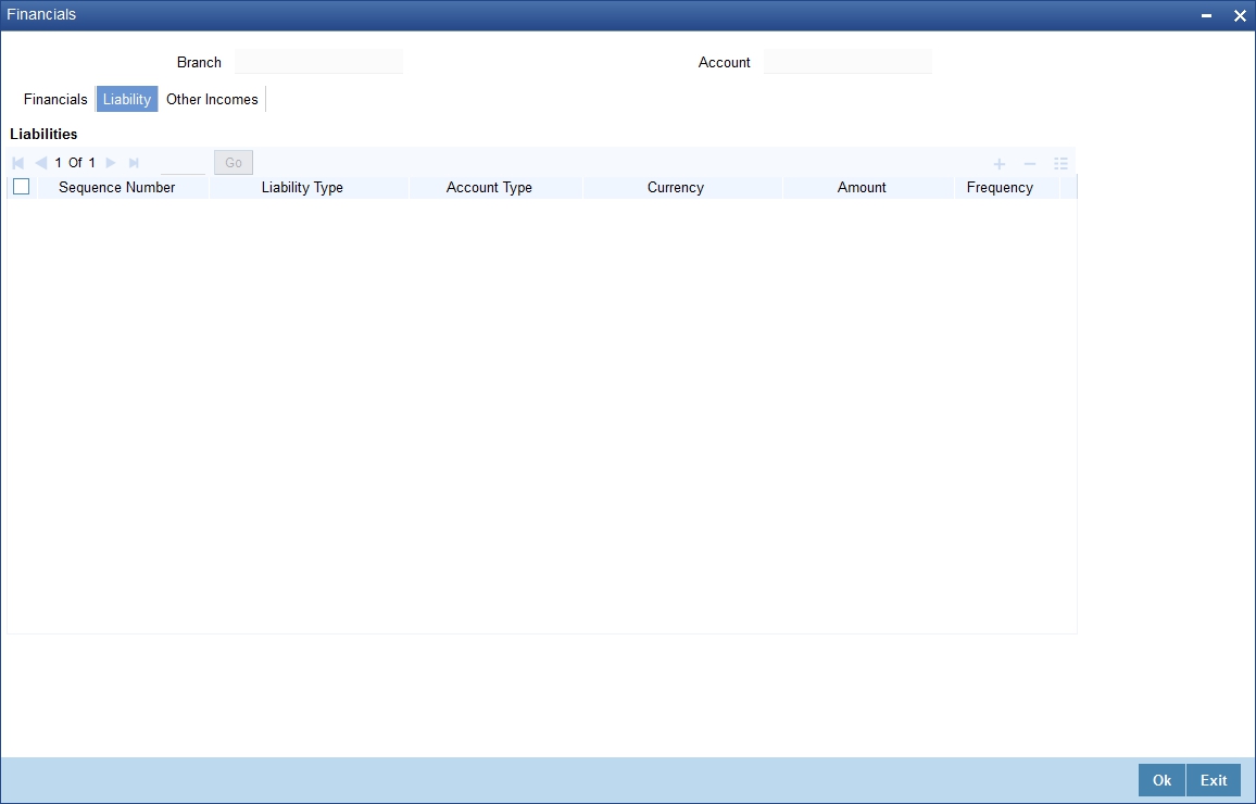

Here you can specify the following details related to the customer’s liability:
Liability Type
Select the type of the liability from the option list provided
Account Type
Specify the account type associated with the liability
Currency
Select the currency associated with the liability, from the option list provided
Amount
Specify the amount associated with the liability
Frequency
Select the frequency at which payments are made towards the liability. The following options are possible:
Account Balance
Specify the current amount outstanding
Comment
Specify any remarks or comments to be associated with the liability
You can also capture the details related to other sources of income, if exists
Seq No
Specify the sequence number here
Income Type
Specify the type of income here. You can also select the income type from the adjoining option list.
Currency
Specify the currency of the income here. You can also select the currency from the adjoining option list.
Amount
Specify the amount of income here
Frequency
Select the frequency of the income here from the drop-down list.
Click Ok to save the details.

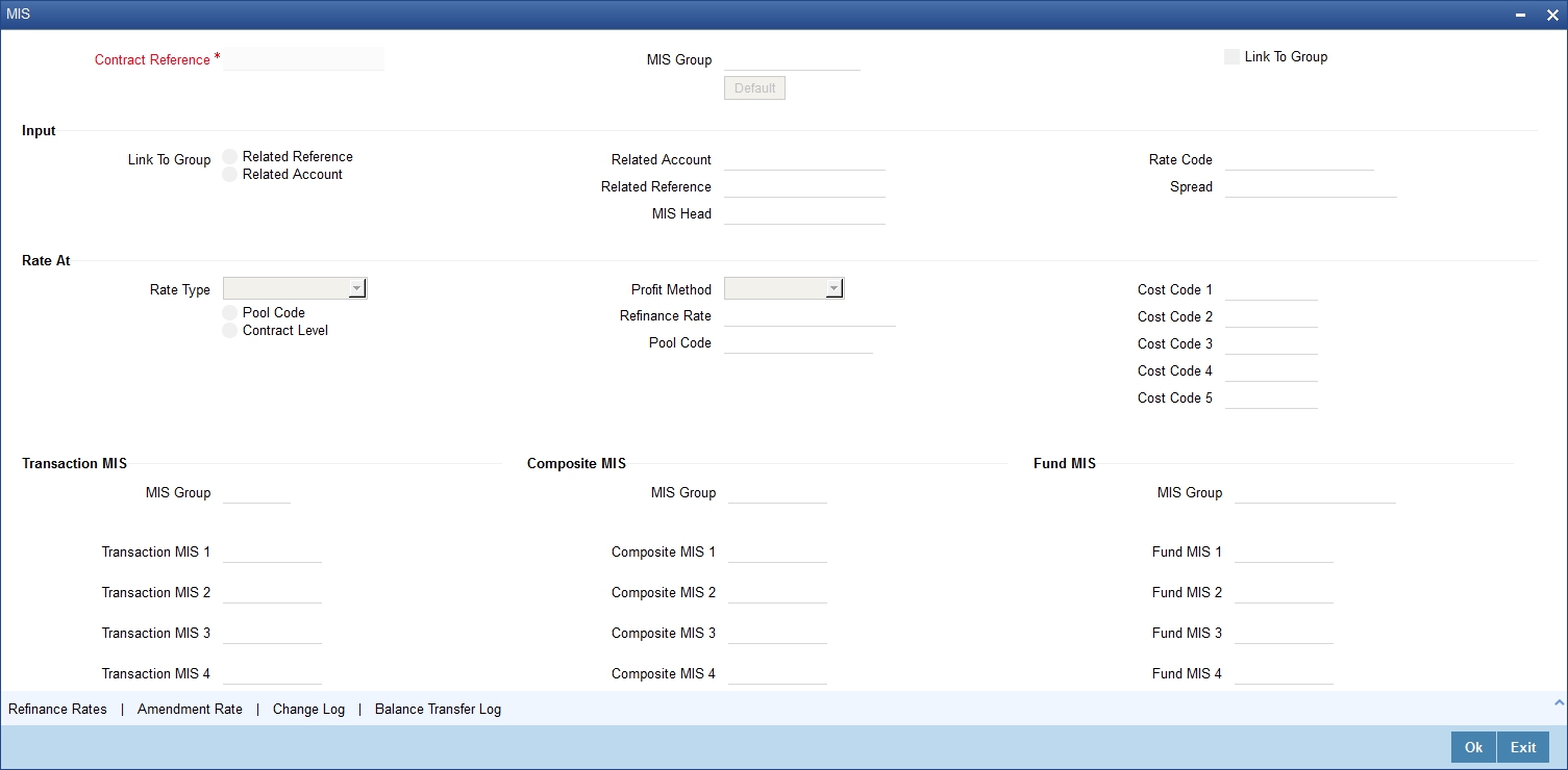

You can maintain MIS details in the ‘MIS’ screen. You can invoke this screen by clicking the ‘MIS’ button in the ‘Account Details’ screen.
For more details on this screen refer section ‘Defining MIS details for an account or contract’ in the chapter ‘Defining MIS Details for a Customer, Account Class, Account, Product, and Contract’ in the ‘Management Information System’ User Manual.

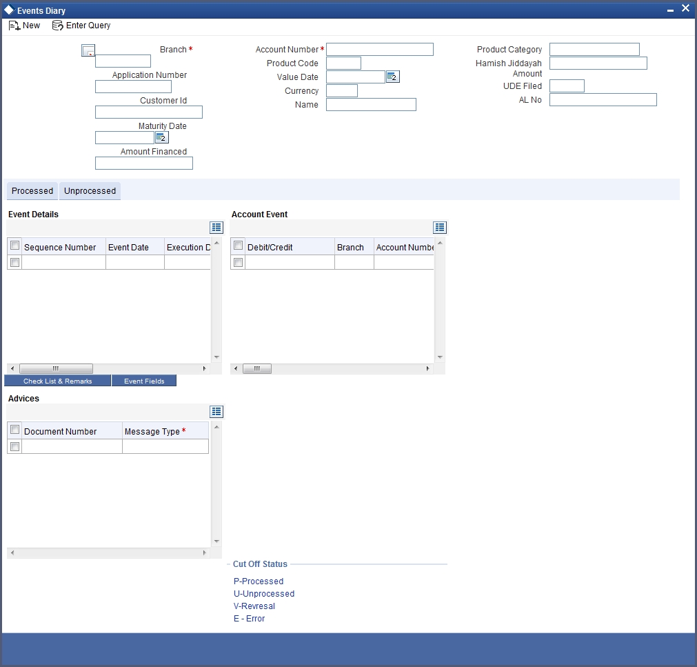

An ‘event’ may be defined as any action starting from application entry to collections. This module captures the details of events applicable to the account. The screen displays both processed and unprocessed events.
The following details are displayed here:
The processed events are all the events which have already taken place. This displays the details like the sequence number of the event. The date on which the event was processed, the value date, the event code, the cutoff status, and a brief description of the event. The screen also displays the details of the events according to the events selected.
Event checklist is a list of items that pops up when an online function is triggered.

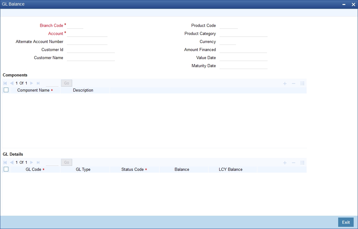

You can view the general ledger details in the ‘GL Balance’ screen. You can invoke this screen by clicking the ‘General Ledger Query’ button in the ‘Account Details’ screen.
The information displayed includes:
Click ‘Installment’ button to access the Installment query screen. The installment query screen displays the details of the installments for the account. The information displayed includes the account details, installment details and the installment summary.
You can invoke the ‘Installment Query’ screen by typing ‘CLDINSQR’ in the field at the top right corner of the Application tool bar and clicking the adjoining arrow button..
The following installment details are displayed:
The following account details are displayed:
The following installment summary details are displayed:

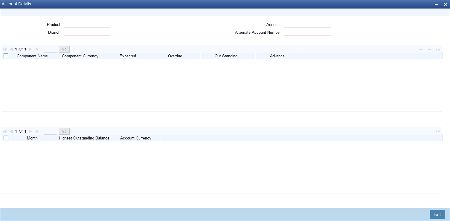

You can view the current status of an account in the ‘Account Details’ screen. You can invoke this screen by clicking the ‘Statistics’ button in the ‘Account Details’ screen.
Once you select an Account Number, the system displays the following details pertaining to the current status of the account:
The Account creation and any other change to an account is updated the audit trail of the record. In the audit trail, the Account status details are also displayed. An Account can be active or uninitiated. Once it is active, it can be reversed, deleted or liquidated based on the operations on it. This is displayed on the screen.
You can view the data collected for the last 12 months including the current month Highest Outstanding balance.
You can view the securitization details in the ‘Security History Details’ screen. You can invoke this screen by clicking ‘Securitization Details’ button in the ‘Account Details’ screen.
Here the system displays the securitization details such as Securitization Event, Status, Date and Security Reference Number on which the loan contract has been a part.

You can capture the SWIFT related details in this screen. You can invoke this screen by clicking the ‘SWIFT Message Details’ button in the ‘Account Details’ screen.
The following swift message related details can be viewed in the above screen:
Swift messages are not generated in the following situations:

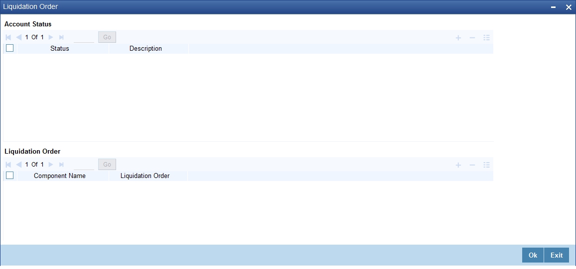

Click on the Liquidation Order button to invoke the Liquidation order screen. In this screen you can maintain the liquidation order for the account as the status maintained at the product level.
Status
Select the status code from the adjoining option list.
Description
The system displays the description of the status code.
Component
Select the component maintained for the product from the adjoining option list.
Liquidation Order
Specify the liquidation order of the component.
You can specify values in this screen only if you modify liquidation order for a particular status specified at product level.

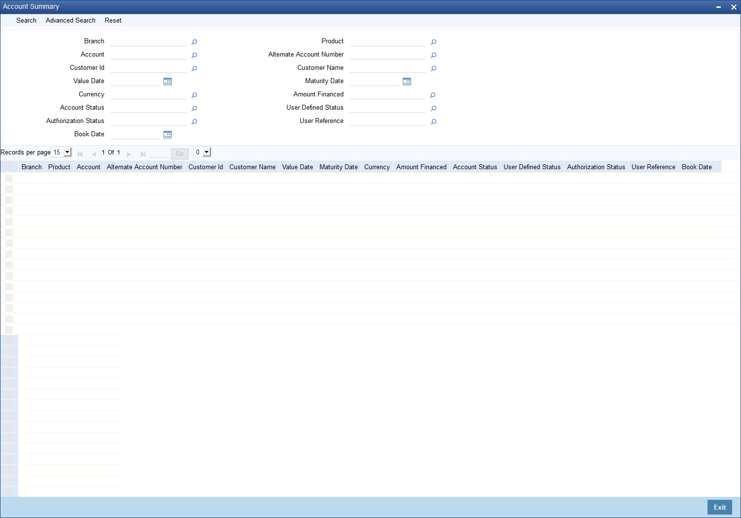

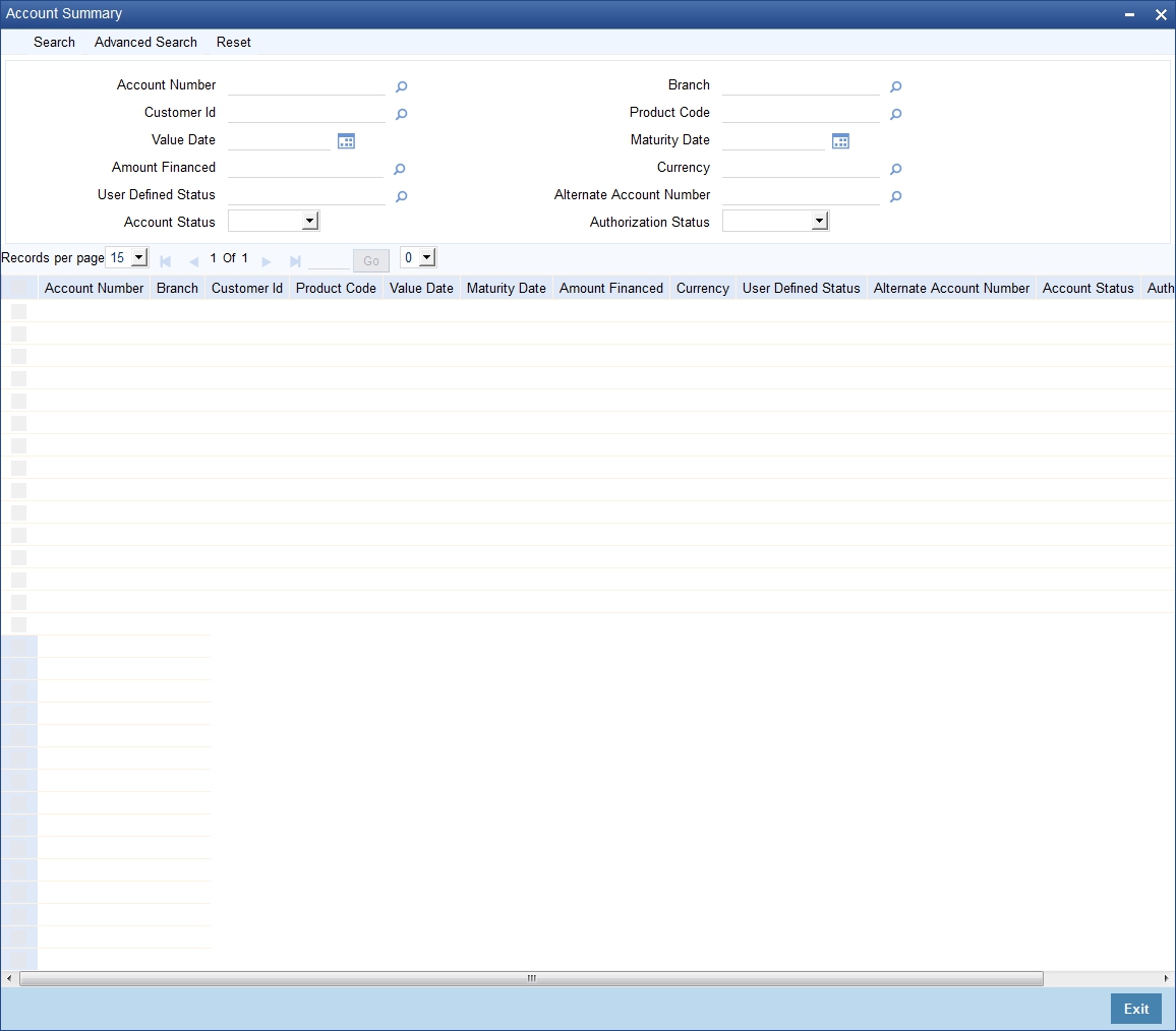

You can view the loan account details using ‘Account Summary’ screen. You can invoke this screen by typing ‘CLSACCNT’ in the field at the top right corner of the Application tool bar and clicking the adjoining arrow button:
You can click ‘Search’ button to view all the pending functions. However, you can to filter your search based on any of the following criteria:
Click ‘Search’, the system displays the following details based on the specified search criteria:

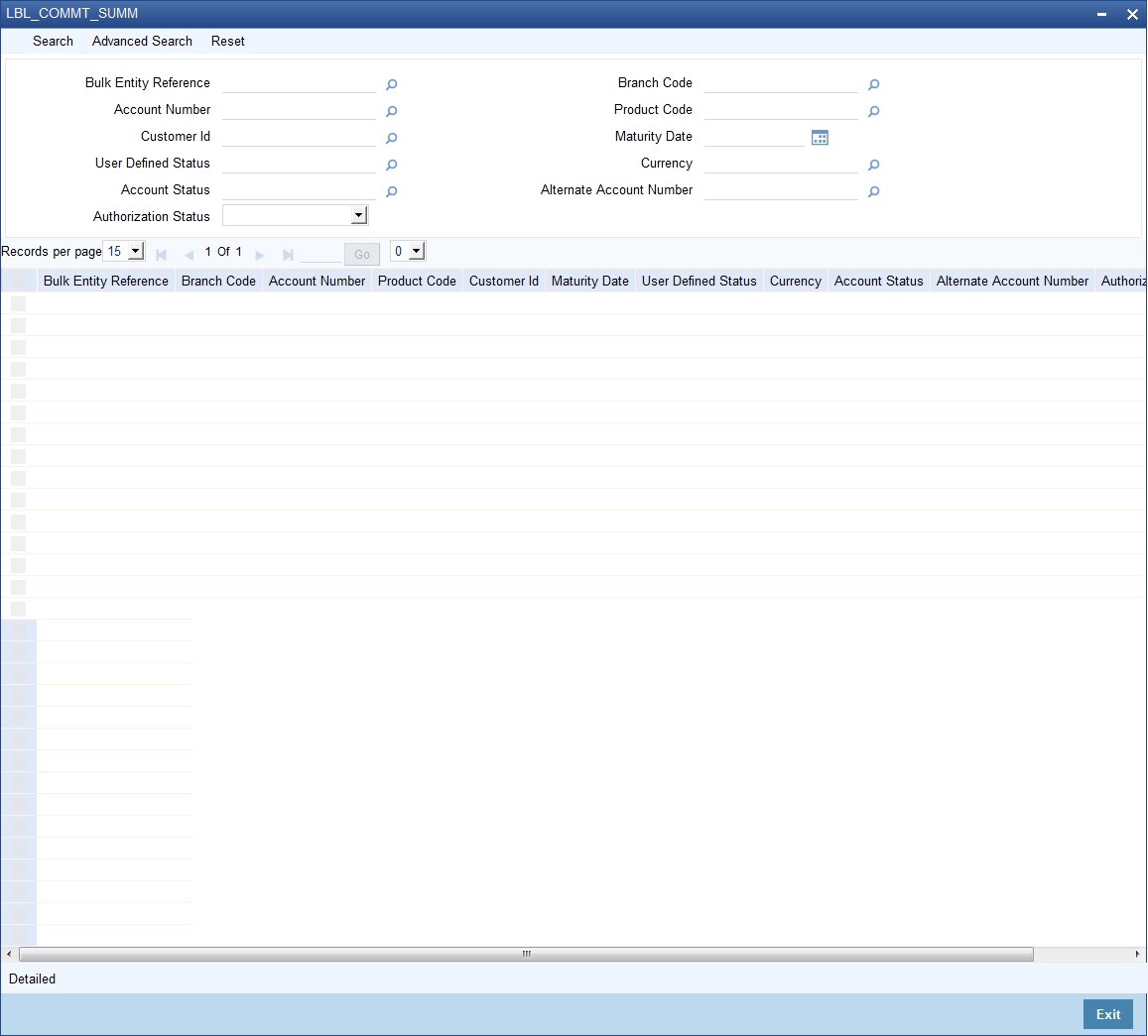

You can view the commitment account details using ‘Commitment Summary’ screen. To invoke this screen, type ‘CLSCMTMT’ in the field at the top right corner of the Application tool bar and click the adjoining arrow button.
Account Number
Select the account number from the option list.
Customer Id
Select the customer id from the option list.
Value Date
Specify the value date.
Amount
Select the amount financed.
User Defined Status
Select the user defined status from the option list.
Account Status
Select the status of the account from the drop-down list.
Branch Code
Select the branch code from the option list.
Product Code
Select the product code from the option list.
Maturity Date
Currency
Select the currency of the transaction from the option list.
Select the alternate account number from the option list.
Authorization Status
Select the authorization status of the contract from the drop-down list.
When you click ‘Search’ button the records matching the specified search criteria are displayed. For each record fetched by the system based on your query criteria, the following details are displayed:
Click ‘Advanced Search’ to display the screen below:
You can query a contract based on any of the following details:
Oracle FLEXCUBE allows you to generate the loan statements along with the time period on an ad-hoc basis. You can generate the loan statement using ‘Loan Statement’ screen. You can invoke this screen by typing ‘CLDLSTMT’ in the field at the top right corner of the Application tool bar and clicking the adjoining arrow button.
Account Number
The system will display all the authorized, active and liquidated CL accounts in the current branch. However, you can amend this field.
Message Type
Select the specific message type for loan statement from the drop-down list. Following are the options available in the drop-down list:
Send to Customer
Check this box to send a message to a customer.
From Date
Specify the ‘From Date’.
If you have not specified the ‘From’ date, then the system will default the ‘From’ date as CL account book date.
Note
‘From Date’ cannot be greater than the current system date.
To Date
Specify the ‘To Date’.
If you have not specified the ‘To’ date, then the system will default the current date.
To process the request, click ‘OK’ button. Then click ‘Report’ button’ to generate the report. System generates the report based on the options selected.
You can generate the message by checking ‘Send to Customer’ checkbox, before generating the report. This message is stored in the outgoing browser. If the message generation fails, then the system will display an error message.
The following information is available in the Loan Account Statement.
Opening Balance:
The Opening Balance for the loan account is the opening balance of the loan based on the given ‘From Date’. The opening balance will be the Principal Outstanding for the loan plus Overdue Interest (if any) plus Penalty (if any) as on the ‘From Date’.
Closing Balance:
The Closing Balance for the loan statement is computed by adding the debit entries and subtracting the credit entries to the opening balance for the given period.
Note
The period between From Date and To Date/Current Date, whichever is earlier, is considered for calculation.
Running Balance:
The running balance is computed based on the previous entry’s balance and the current entry’s credit or debit. The running balnce is generated for every Credit and Debit entry in the loan account,
Interest Application:
Debit entry is displayed based on the interest schedule due dates.
If there are multiple interest components, separate debit entries for each of the components as on their corresponding due dates are displayed.
Note
For ‘Discounted’ loans, the interest is displayed as received in advance as part of disbursement event for both debit and credit entries.
If the account is in any status other than Normal and if accrual has been stopped or if contingent accrual is set, still interest application would be shown in the statement as on the schedule due dates.
Penalty Interest:
System displays the debit entry for the penalty amount as on the payment date along with the respective credit entry on the same payment date if,
If the Penalty is unpaid, a debit entry (as on the ‘To Date’/Current System date whichever is earlier) for penalty is shown in the loan statement.
If the penalty component is of non accrual type, only credit entry is shown in the loan statement.
Charge:
Debit and credit entry for the charges associated with the events for the given period are displayed.

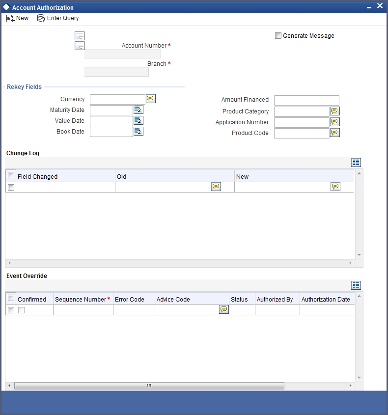

After entering the loan/commitment account details click ‘Save’ icon to save the account details.
To authorize an account, click ‘Authorize’ icon on the Application toolbar. The ‘Account Authorization’ screen is displayed.
The loan account number and the branch details are defaulted here.
The following detail needs to be selected, as required:
Generate Message
Check this box if you want swift messages to be generated either for a customer transfer or a bank transfer along with a cover. The generated message can be viewed in the messages browser. Even if the box is left unchecked you can go to messages browser at a later point of time and generate the message.
If the message generation fails for some reason, the account is authorized and you have to go to the browser to manually generate the swift message.
All other advices related to BOOK/INIT/DSBR events are not generated at this point and you need to go to the message browser to do the same.
Note
You cannot authorise a contract from the contract screen in the following cases:
High value transactions may require multilevel of authorization. The levels of authorizations are defined in the ‘Product Transaction Limits’ screen. You can use the ‘Multilevel Authorization Detailed’ screen for authoring a contract n-1 times. However, final authorization can take place only in the contract screen.
For more details, refer the ‘Multilevel Authorization of Contract/Loan Account’ section in the ‘Procedures’ User Manual.

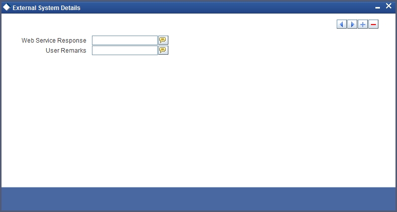

OFAC check enables the application to call an external web service to perform black list check for customer and customer accounts and give warnings appropriately while transacting with black listed customers. You can also capture your remarks before overriding the black list warning.
Click ‘OFAC Check’ button to view the OFAC check response in the ‘External System Detail’ screen On clicking ’OFAC Check’ button, system will build the request XML and call the web service. The ‘External System details’ screen displays the response is received from the external system and you will be also allowed to enter your remarks in this screen. The response received will also be sent to Oracle FLEXCUBE Database layer for any further interpretations of the same. This button can be made visible while carrying out the actual customization. Request building response interpretation in the database layer needs to be done as part of customization to enable this.
Here, you can view /capture the following details:
External System Response
The response from the external system regarding the black listed customer is displayed here.
User Remarks
Specify your remarks regarding the black listed customer here.

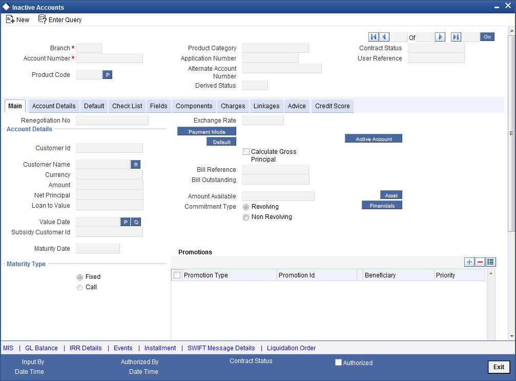

During Loan processing, it is required to capture loan details and not initiate till verification of documents, etc. This module creates a loan account in an inactive state. Inactive loans are input by a separate screen similar to the Accounts screen or by Uploads. After manual verification the account is entered as an inactive account. The account is activated once the requisite documents are received.
You can invoke this screen by typing ‘CLDINADT’ in the field at the top right corner of the Application tool bar and clicking on the adjoining arrow button.
The system captures the following details and generates an inactive account:
Modifications are allowed on inactive loans even after authorisation and there are no restrictions on inactive loans modifications. Loan details are handed off to other systems. Messages such as Loan advice or Promissory Notes can also be generated.
It is possible to modify an inactive loan and save it even after authorisation. When the account is activated it will be an unauthorized account and behaves like an account directly created /uploaded into the system. It is possible to delete the same too. The user can change all loan account properties.
Click ‘Active Account’ button to activate the loan. This changes the funded status of the loan. Once activated, the account cannot be deleted after authorisation and cannot be unlocked after one save.
Accounting entries and limit updates are not called when the loan is inactive. Accounts queries do not display inactive accounts and Inactive accounts views do not show active accounts.
If an account is created after its value date, it behaves as a Back valued loan entry. If it is created after its maturity date, it behaves like an overdue account.
Inactive loans are created with a sequence that is different from the account mask maintained. Upon activation, the account mask is used to create a new account. Hence the account number of an activated account differs from its inactive version.
Inactive loans are activated by clicking on Activate Account button or through an upload. Upon loan activation, Limits Utilizations are updated. Accounting entries are passed for disbursement and for any upfront changes as defined in the product.
The earmarked amount field shows the total earmarking and an earmarking reference number is captured. Upon the actual loan initiation, utilization is made on the line and real entries passed.
Inactive loans can be deleted even after the authorisation of Inactive loan account. In Bank Parameters, Site specific parameters are provided to control the automatic deletion of Inactive loans. An Inactive Loan processing supports this deletion.

You can query CL accounts linked to the L/C in the ‘Commitment/Limits Summary’ screen. You can invoke this screen by typing ‘CLSENTTY’ in the field at the top right corner of the Application tool bar and clicking the adjoining arrow button.
You can query a record using the following options:
The following details get displayed:
In this screen, click a child record to invoke ‘Account Details’ screen.
Retail lending accounts linked to a loan or commitment can be queried for by using the Limit/Commitment summary screen.
To invoke this screen type in ‘CLSENTTY’ in the field at the top right corner of the Application tool bar and click the adjoining arrow button.
You can select a particular record to view based on the limit/commitment parameters fed in the screen and the base entity type.
To view a particular record from the list click on the desired record from the list displayed. Only the detailed records of the accounts for the current branch are available for view.
Usually a notary confirms the collaterals (linked to the loan) before loan account creation. In case, the confirmation from notary is not received before loan account creation, you can initiate confirmation manually using the ‘Manual Notary Confirmation’ screen. You can invoke this screen by typing ‘CLDNOCON’ in the field at the top right corner of the Application tool bar and clicking the adjoining arrow button.
Branch Code
Specify the unique identifier of the branch where the loan account (for which notary confirmation needs to be updated) is created. The adjoining option list displays all branches maintained in the system. You can select the appropriate one.
Account Number
Specify the loan account number / commitment account number for which notary confirmation needs to be updated. The adjoining option list displays all loan accounts/commitment accounts (for which the “Notary Confirmation Required” check box is checked at the product level,and “Notary Pre Confirmed” check box is unchecked at the account level) maintained in the system. You can select the appropriate one.
Notary Confirmation Date
The system displays the current system date as the date of confirmation.
Notary Status
Select the notary status from the adjoining drop-down list. This list displays the following values:
If the notary status is ‘Confirmed’, then the system will trigger NCON event during authorization. If the notary status is ‘Reject’, the system will trigger NREJ event which in turn triggers the reversal of the contract during authorization.
Remarks
Enter the remarks for confirming or rejecting the collateral details.
