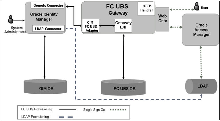

The Oracle FLEXCUBE - Oracle Identity Manager Interface helps in integrating the two systems for user provisioning and de-provisioning services.
Oracle Identity Manager (OIM) automates user provisioning, identity administration, and password management. OIM manages the entire life cycle of user identities and entitlements and helps to control user access across all resources in the organization.

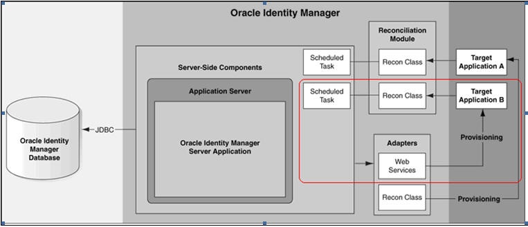

The integration between Oracle FLEXCUBE and Oracle Identity Manager is done via a Generic Technology Connector (GTC). The GTC provides for provisioning and reconciliation tasks via the following components:
For sample GTC configurations refer Annexure A.
The tasks performed by OIM in this deployment configuration are as follows:
You can have certain operations regarding User Identity Management using the OIM GTC. The requests for these operations are sent from OIM GTC and are as follows:
OIM GTC is used for both user provisioning/de-provisioning services and for reconciliation in Oracle FLEXCUBE.
For user provisioning and de-provisioning services the Oracle FLEXCUBE Gateway user upload services is used. Reconciliation is done using the ‘SMBOIMHF’ EOD activity in Oracle FLEXCUBE.

OIM- Oracle FLEXCUBE integration will remain functional with or without the Oracle FLEXCUBE Single Sign on mode.

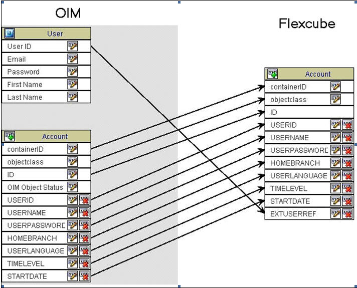

The data sent from OIM to Oracle FLEXCUBE for user provisioning will contain only the following:
The data sent from OIM to Oracle FLEXCUBE for user provisioning is illustrated below.

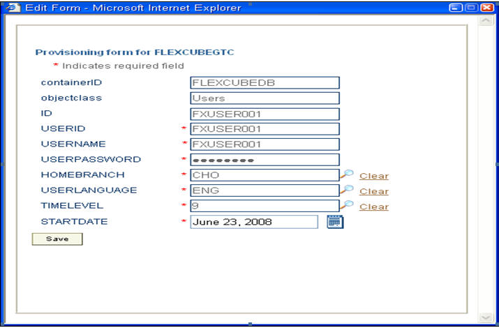

The data for provisioning is collected from the OIM user creation form. The fields to be collected - such as User ID, User Name and User Password – are defined in the ‘Provisioning form for Oracle FLEXCUBE GTC’.
The ‘Provisioning form for Oracle FLEXCUBE GTC’ is filled up by the OIM Administrator. OIM Administrator uses Direct Provisioning to provision Oracle FLEXCUBE to any OIM user.
The Field values like Name, Password, and User Id in the provisioning data form shall be pre-populated from the OIM user maintenance form.
The Provisioning process flow is illustrated in the diagram shown below.

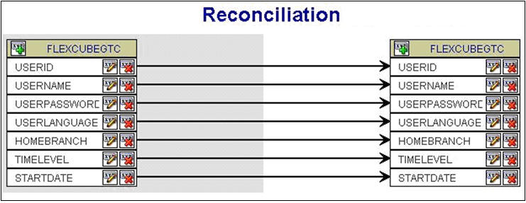

The data for reconciliation contains the same set of mandatory fields used for user provisioning.

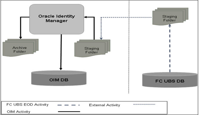

The EOD activity ‘SMBOIMHF’ creates the handoff file for reconciliation. The handoff file will be in CSV (Comma Separated Values) format.
Handoff File Name
The Handoff file name has two parts which are:
Handoff File Format
The Handoff file will be in Comma Separated Values (CSV) format and will contain the following:
Sample Handoff file
##FC UBS user data 2008-05-06
USERID,USERNAME,USERPASSWORD,TIMELEVEL,HOMEBRANCH,STARTDATE,USERLANGUAGE
TESTUSER1,TEST USER, 56A04A86FADBA54D2AD649D98E3FB63F,9,CHO,31-DEC-07,ENG
TESTUSER2,TEST USER, 3FE06AFE34C9A53E0320E74E43FB3F45,9,CHO,31-DEC-07,ENG
The Reconciliation process flow is illustrated in the diagram shown below.

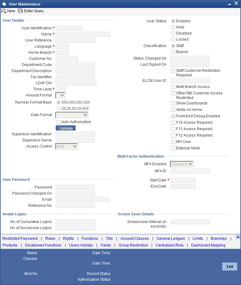

You must maintain an ‘OIM Admin User’ in Oracle FLEXCUBE to serve as Maker Id for user provisioning and de-provision. You can maintain the OIM Admin User reference in the ‘External Identifier’ field.
The ‘External Identifier’ field is available in the ‘User Maintenance’ screen where you can maintain other details of the Oracle FLEXCUBE User as well.
