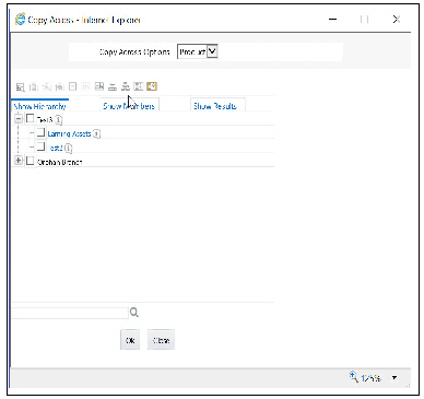

4.    Select the defined product assumptions using the check boxes corresponding to each product (or Node on the hierarchy) that you want to include in the copy process.
5.    Click the Copy Across icon.
On the Copy Across details page, select the listed currencies either individually using the corresponding check boxes or in total using Select All.
6.    Specify an interest rate code for each selected currency. This is necessary because each interest rate code is specific to a single currency. When copying product assumptions across currencies, you must define the interest rate code for each target currency to replace the interest rate code used for the source currency assumptions.

7.    Click Apply to initiate the copy process and to return to the Assumption Browser page.
