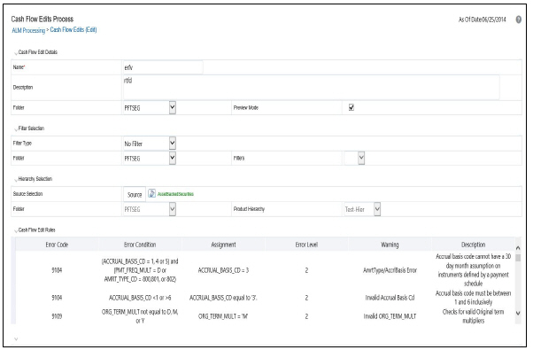

Cash Flow Edit Rules
The Cash Flow Edit Rule section provides a summary of all seeded cash flow edit rules. Users can refer to this list to understand the validations that are applied to the cash flow fields on the instrument records and also view the default values that are applied when errors are found.
1.     Navigate to the Cash Flow Edits Summary page.
2.    Click Add button.
The Create Cash Flow Edits Process page is displayed.
3.    Complete standard steps for this procedure. For more information, see Creating Rules  section.

4.    (Optional) Select a Filter.
5.    Select the Instrument tables or use a hierarchy to make Product member selections.
