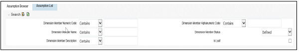

Assumption List Tab
Assumption List Tab is present next to the Assumption Browser in all the screens which have assumption browser. This tab provides search capability with the help of five fields:
·        Dimension Member Code
·        Dimension Member Name
·        Dimension Member Description
·        Dimension Member Status
·        Is Leaf
Dimension Member Code, Name and Description provide filter criteria for search such as: Contains, Starts With, Ends With, Exactly Matches.
Dimension Member Status is a drop-down list containing values such as: Defined, Not Defined, Inherited, Defined and Inherited, and All.
Is Leaf is a checkbox which can be toggled.
Search button initiates search on the assumption browser based on the filter criteria provided in the above mentioned fields. Reset restores default search criteria.
The search results will flatten the hierarchy and display all of the products that meet the input criteria. Use the pagination widget to display the number of products per page (up to a maximum of 99). You can proceed to edit or create new rules in the assumption list tab.

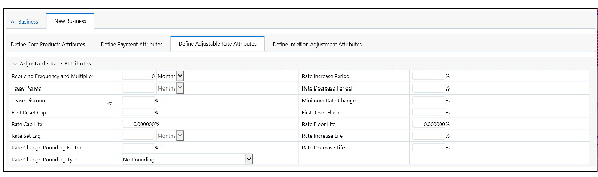

The New Business tab
Assumptions made on the New Business tab impact forecast business only. These assumptions are used together with the other Forecast Assumption rules including Forecast Balances, Pricing Margins and Maturity Mix to determine the behavior of your forecast instruments. There are five sub-tabs within New Business setup including:

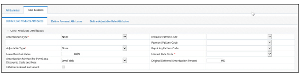

·        Define Core Product Attributes

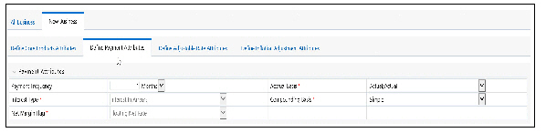

·        Define Payment Attributes
·        Define Adjustable Rate Attributes

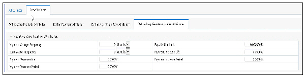

·        Define Negative Amortization Attributes
·        Define Other Mortgage Attributes *

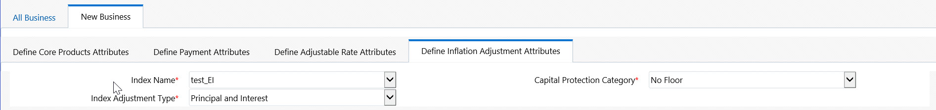

·        Define Inflation Adjustment Attributes **
Note
Note: * This tab will be displayed only if you are mapped to ADCo LDM functionality and currency is selected as USD.
** This tab will be displayed, if Inflation Indexed Instrument option is selected in Define Core Products Attributes tab for New Business.

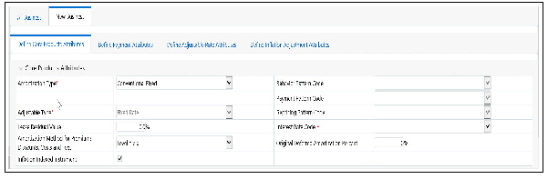

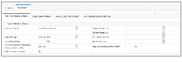

New Business Fields
Following is a listing of new business fields used in the Product Characteristics rule > Core Product Attributes tab.
Field
Description
Amortization Type
Method of amortizing principal and interest. The choices consist of all standard OFSAA codes and all additional user-defined codes created through the Payment Pattern and Behavior Pattern interfaces, as given below:
·        Conventional Fixed
·        Conventional Adjustable
·        Balloon Payment
·        Adjustable Negative Amortization
·        Non-Amortizing
·        Rule of 78's
·        Level Principal
·        Payment Pattern
·        Behavior Pattern
·        Lease
Adjustable Type
Determines the repricing characteristics of the new business record. The choices consist of all standard OFSAA codes plus Repricing Pattern. The standard OFSAA codes are as follows:
·        Fixed Rate
·        Floating Rate
·        Other Adjustable
Lease Residual Value
For Lease instruments, this value specifies the residual amount as a percent of the par balance.
Amortization Method for Premiums, Discounts and Fees
Determines the method used for amortizing premiums, discounts or fees. The available codes are:
·        Level Yield
·        Straight Line
Behavior Pattern Code
Lists all user-defined behavior patterns created through the user interface.
Payment Pattern Code
Lists all user-defined payment patterns defined through the user interface.
Repricing Pattern Code
Lists all user-defined reprice patterns created through the user interface.
Interest Rate Code
Defines the pricing index to which the instrument interest rate is contractually tied. The interest rate codes that appear as a selection option depend on the choice of currency. The interest rate code list is restricted to codes which have the selected currency as the reference currency. If the default currency is chosen, all interest rate codes are available as a selection.
Original Deferred Amortization Percent
The initial deferred balance expressed as a percent of original par balance.
Check box to model instrument as Inflation Indexed.
Following is a listing of new business fields used in the Product Characteristics rule > Payment Attributes tab:
Field
Description
Payment Frequency
Frequency of payment (P & I), Interest or Principal). For bullet instruments, use zero.
Interest Type
Determines whether interest is calculated in arrears or advance or if the rate is set in arrears. There are three interest types:
·        Interest in Arrears
·        Interest in Advance
·        Set in Arrears
For conventional amortization products, interest in arrears is the only valid choice.
Rolling Convention
Reserved for future use.
Accrual Basis
The basis on which the interest accrual on an account is calculated. The choices are as follows:
·        30/360
·        Actual/360
·        Actual/Actual
·        30/365
·        30/Actual
·        Actual/365
·        Business/252 *
Compounding Basis
Determines the number of compounding periods per payment period. The choices are the following:
·        Daily
·        Monthly
·        Quarterly
·        Semi-Annual
·        Yearly
·        Continuous
·        Simple
·        At Maturity
Net Margin Flag
The setting of the net margin flag affects the calculation of net rate. The two settings are:
·        Floating Net Rate - the net rate reprices in conjunction with the gross rate, at a value net of fees.
·        Fixed Net Rate - the net rate equals a fixed fee equal to the net margin.
Note
* A Holiday calendar selection is required if business/252 accrual basis is selected. Business/252 accrual basis is only applicable to the recalculate option of the holiday calendar rule. If user selects the shift payment dates, the payment will still be recalculated for the non holiday/weekend date.
Following is a listing of new business fields used in the Product Characteristics rule > Adjustable Rate Attributes tab:
Field
Description
Repricing Frequency
Contractual frequency of rate adjustment
Tease Period
The tease period is used to determine the length of tease period.
Tease Discount
The tease discount is used in conjunction with the original rate to calculate the tease rate. The tease rate is the original rate less the tease discount.
First Reset Cap
This indicates the maximum delta between the initial rate and the first reset for mortgage instruments that have a tease period. This rate will be applicable at the tease end period, prior to the first reset. After this, the periodic and lifetime cap value will be applied. The value of this field will be automatically populated from Product Profile window if the product is mapped to Product Profile and value is defined for First Reset Cap.
For example:
Current Rate = 3.5% (from the instrument record)
Margin = 0.3 %
First Reset Cap = 0.5% (from the instrument record)
First Reset Floor = 0.1% (from the instrument record)
Scenario 1: If New Forecasted Rate = 5.1% (Forecast Rates Assumption)
Fully indexed rate (after applying minimum rate change, rounding effects) is higher than the (Current Rate + First Reset Cap). So, the new rate assigned will be 3.5% + 0.5% = 4.0%
First Reset Floor
This is the initial minimum value for mortgage instruments that have a tease period. This floor rate will be applicable at the tease end period, prior to the first reset. After this, the periodic and lifetime floor value will be applied. The value of this field will be automatically populated from Product Profile window if the product is mapped to Product Profile and value is defined in for First Reset Floor.
Rate Cap Life
Maximum rate for life of the instrument.
Rate Set Lag
Period by which the rate lookup lags the repricing event date.
Rate Change Rounding Factor
Percent to which the rate change on an adjustable instrument is rounded.
Rate Change Rounding Type
Method used for rounding of interest rate codes. The choices are as follows: no rounding, truncate, round up, round down, round nearest.
Rate Increase Period
Maximum interest rate increase allowed during the cycle on an adjustable rate instrument.
Rate Decrease Period
Maximum amount rate can decrease during the repricing period of an adjustable rate instrument.
Minimum Rate Change
The minimum required change in rate on a repricing date.
Rate Floor Life
Minimum rate for life of the instrument.
Rate Increase Life
Maximum interest rate increase allowed during the life of an adjustable rate instrument, used to calculate rate cap based on forecasted rate scenario. If both rate increase life and rate cap are defined, the process uses the more restrictive rate.
Rate Decrease Life
Maximum amount rate can decrease during the life of an adjustable rate instrument, used to calculate the rate floor based on the forecasted rate scenario. If both rate decrease life and rate floor are defined, the process uses the more restrictive rate.
Following is a listing of new business fields used in the Product Characteristics rule > Negative Amortization Attributes tab:
Field
Description
Payment Change Frequency
The frequency at which the payment amount is recalculated for adjustable negative amortization instruments.
Equalization Frequency
Frequency at which current payment necessary to fully amortize the instrument is re-computed.
Payment Decrease Life
Maximum payment decrease allowed during life of a negative amortization instrument.
Payment Decrease Period
Maximum payment decrease allowed during a payment change cycle of a negative amortization instrument.
Equalization Limit
Maximum negative amortization allowed, as a percent of original balance. E.g., if principal balance should never exceed 125% of original balance, this column would equal 125.0
Payment Increase Life
Maximum payment increase allowed during the life of a negative amortization instrument.
Payment Increase Period
Maximum payment increase allowed during a payment change cycle on a negative amortization instrument.

Define Inflation Adjustment Attributes tab
When Inflation Indexed Instrument check box is selected, the Define Inflation Adjustment Attributes tab is enabled. For more information on Inflation Indexed Instrument calculation, refer to Oracle Financial Services Cash Flow Engine Reference Guide.
Note
The Define Inflation Adjustment Attributes tab will be enabled if Adjustment type is selected as Conventional Adjust, Conventional Fixed, Level principal, or Non-Amortizing.
Tab
Field
Behavior
Index Adjustment Attributes
Index Name
Lists all Economic Indicator defined through user interface.
Capital Protection Category
Determines Capital protection to be provided to Inflation indexed instruments. The choices are:
·        No Floor: No Floor does not provide any downside protection.
·        Floor of 1: Floor of 1 provides protection from downside movement.
·        Max during Life: Max during life gives maximum advantage using maximum Index factor for calculation.
Index Adjustment Type
Determines type of Index adjustment. The choices are following:
·        Principal and Interest
·        Principal Only
·        Interest Only
Note
 For more information on cash flow calculations associated with Inflation indexed instrument, refer to Oracle Financial Services Cash Flow Engine Reference Guide.
