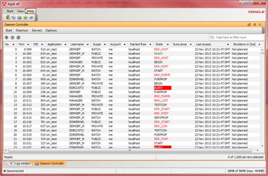

7.3.2.2 Connect to the Java Daemon
  1. In Agile e6, click the button to open the Java Daemon administration tool.
    The Daemon Controller window opens at the bottom of the screen.
  2. In the Daemon Controller window, click Start.
  3. Select Connect to daemon...
    The Connect to daemon window is opened.
  4. Enter your information in the fields:
    • Daemon on host
    • Port number
    • Daemon password
  5. Click Connect.
    In the Daemon Controller screen, a list of all servers is displayed.
    COLUMN NAME DESCRIPTION
    No. Amount of servers.
    Port Port number between server and client.
    PID PID of the server process started on this machine.
    Application Name of the application used by the server.
    Username Name of the Agile e6 user who is using the server process.
    Scope Three scopes are possible:
    • Private
      Connection between one client and the server.
    • Batch
      Batch connection between client and server.
    • Public
      Connection between multiple users and the server.
    Account Account name of the user on the client machine.
    Started from IP address of the client.
    State
    • BEGIN
      Begin of initialization.
    • FREEPORT
      Reserved a free port.
    • SERVPROP
      Server Properties set up.
    • START
      Started Start command.
    • TESTCON
      Established test connection.
    • FURPROP
      Set further properties (VIEW, LANGUAGE).
    • READY
      In ready state.
    • BUSY
      Busy (blocked by a long running call).
    • CHECK
      Check (getting number of connections).
    • ERR_HOST
      Error: Could not get the host address.
    • ERR_STORE
      Error: Could not store the new AxalantServer.
    • ERR_PORT
      Error: Could not get a free port.
    • ERR_START
      Error: Could not execute start command successfully.
    • ERR_CON
      Error: Could not create connection to server.
    • ERR_FURPR
      Error: Could not set further properties (VIEW, LANGUAGE).
    • ERR_LOST
      Error: Server lost.
    • ALERT
      Alert (may be lost).
    Runs since Time server was started.
    Last access Last time the client and the server connected to each other and exchanged data.
    Shutdown [ms] Shutdown in ms if a public server is no longer in use.
7.3.2.3 Working with the Daemon Controller
The following functionalities are available:
  • Double-clicking the Daemon Controller window banner
    By double-clicking the window banner, the Daemon Controller can be extended over the complete Agile e6 window. Or it can be reduced to the bottom of the Agile e6 window.
  • Search
    • General filter
      The general filter allows filtering rows for the entered search term.
    • Column filter
      Every column in the Daemon Controller has a filter functionality. Each column filter lists all terms available in the respective column.
  • Administration of the server
    You can administer the servers from:
    • Servers menu
    • Context menu
    • Toolbar buttons
      All three options allow to:
      • Refresh
        Refreshes the server list.
      • Information
        Additional server information can be displayed for one or more selected rows.
        When selecting more than one server, the information in the Server Information window is displayed below each other.
        The information in the Server Information window is read only!
      • Shutdown server
        This option shuts down the selected server, but not the Java Daemon.

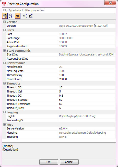

7.3.2.4 Configuring the Daemon
  1. To open the Daemon Configuration, open the Daemon menu.
  2. Select Configuration.
    The Daemon Configuration screen is opened.
    • The Daemon Configuration window displays the current Java Daemon configuration and allows modifying certain properties.
    • By highlighting a property, its description is displayed in the description area.
    • The search field at the top of the window offers comprehensive search functionality.
    • At the top, the following display buttons are available:
      • Categorized
        Displays the properties in categories.
      • Alphabetic
        Displays the properties alphabetically.
      • Show/Hide Description Area
        Shows or hides the description area at the bottom of the window.

    • Every property value that is not grayed out, can be changed.
      1. Double-click the respective value.
      2. Enter new value.
      3. Click OK.
      Modifications are only valid for the current session and are not stored in the Daemon configuration file jade.ini. After shutting down the Daemon, these changes are lost.
7.3.2.5 Refresh Frequency Rate
The Daemon Controller allows setting a new time value for refreshing the server list. This value defines after which time interval the server will be refreshed.
The new value is only valid on the used client machine and will be stored in the local Java configuration file jacc.ini. After a restart of the client, the changed value is still valid.
Default refresh frequency rate = 60000 milliseconds
  1. Open the Options menu.
  2. Select Properties.
    The Set daemon controller properties screen is opened.
  3. Select Server list refresh frequency (milliseconds).
  4. Enter a value.
  5. Click Set property.
