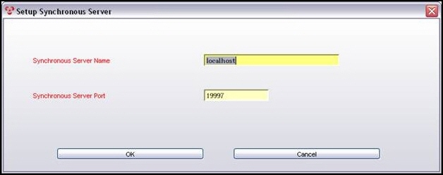

The Agile EDM Connector can be run in two modes: asynchronous and synchronous mode.

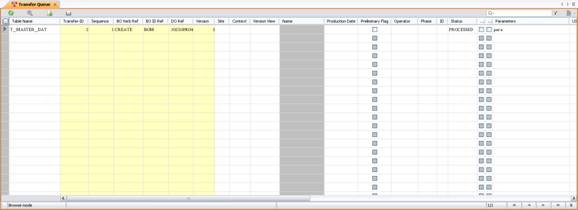

In the asynchronous mode, the transfer requests (request to export data to EIP) are written into the transfer queue inside Agile EDM. These transfer requests are executed by a background Agile EDM process some time later. After execution of the transfer request, appropriate result and status information is written back to the transfer queue.
In the synchronous mode, the transfer requests are written to the transfer queue, too, but in this case, the Agile EDM client (Java, or Web Client) is blocked until a response comes back from the synchronous Agile EDM connector. The synchronous mode may especially be used in cases where a process inside Agile EDM (e.g. Release of a BOM) depends on the outcome of the message transfer to an external system via EIP.
A special feature called XML Snapshot has been provided, which works similar to the synchronous mode as described above. The XML Snapshot feature can be used to synchronously retrieve the data (e.g. BOM) from Agile EDM and store it in the Agile EDM database, instead of sending it directly. This allows bridging the gap between the creation of the transfer request and actually retrieving the data (e.g. BOM) in order to send it to an external system.

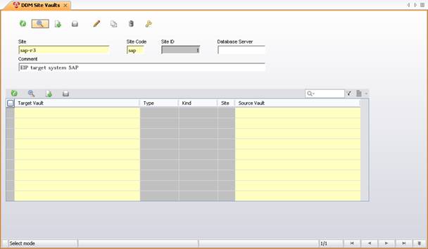

Site Management configuration can be used if you have one EIP running with one Agile EDM Connector that will feed two or more target systems, e.g. two ERP systems or one ERP system and BPM.
The standard workflow definition in eai_ini.xml is then not sufficient anymore as only the first workflow with the Agile EDM Connector as a source connector will be used. As a result, the additional workflows with the same Agile EDM Connector is not taken into consideration (see Workflow Section). The Site Management inside Agile EDM allows predefining the target connector name and therefore allowing the EIP to pick the proper workflow definition.
The Integration Platform uses the site configuration table defining the target system (connector name) of the sent data record(s).
Note: Only the fields Site and Site Code are mandatory for using Site Management with EIP. It is also recommended to fill in the Comment field. |
The site name will be used later on to find the target connector from a workflow definition in the Enterprise Integration Platform. The site ID can be used for assigning it to the data record, which should be transferred.
In the above example, the Site Code is "erp" and the Site name is "erp". An entry in the Agile EDM Transfer Queue could then be created or assigned to the Site Code "erp". Whenever the Agile EDM Connector finds an entry with the code "erp", it looks for the respective site name ("erp"), which it takes for defining the name of the target connector (also "erp"). Of course, the appropriate <workflow> definition has to exist in eai_ini.xml (source connector "plm" and target connector "erp"), which defines the mapping files (pipes) in addition.
Note: Please keep the site names in sync with the target systems (logical connector names) inside the Enterprise Integration Platform! |

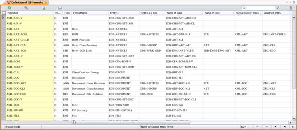

The XML-Interface is used as a layer between the Agile EDM Connector and Agile EDM. It serves as an XML-based input/output service in order to retrieve data from Agile EDM (query and checkout operations) and bring data into Agile EDM (insert, update, checking and delete operations). Following customizing needs to be done in Agile EDM before you can use the XML-Interface:
The IEF formats are used to describe the EXI schemas, i.e. which entities, relationships and forms must be used for saving and retrieving the data.
The IEF formats allow defining schema hierarchies by connecting different formats via the fields "Format master-entity" and "Assigned entity". The Integration Platform automatically exports all EXI schemas into an external XML Schema File (XSD) when launching the Integration Platform in test mode. EXI does NOT use any IEF format to field assignment of the IEF tool. The fields are directly retrieved from the corresponding DataView forms, as defined in the IEF format (name of mask). The external file name of the XML schema file <path> and the query string <bor-query-string> for the formats (e.g. "XML%") can be configured in the bor_plm.xml file of the Integration Platform. Below are some sample settings in section in the bor_plm.xml file:

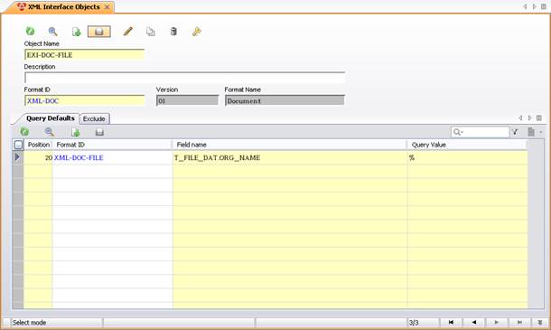

The XML Interface introduces the notion of XML interface objects. These interface objects are a high level definition of XML schema hierarchies, including the possibility to predefine query defaults and exclusion of schemas. The interface object refers to the top-level schema (IEF Format), which should be used for a query operation. All schemas (IEF formats), which are linked to the top-level schema via the field "Format master-entity", are part of the schema hierarchy. When EXI/EIP is trying to resolve the structure underneath the top-level schema it always looks for child schemas, which point to the parent schema via the name of the parent schema as value in the field "Format Master Entity". That way you can build up a multi-level hierarchy of schemas in order to export multi-level structures via EXI/EIP.
Note: Interface Objects are only used for queries right now. |
The tab "Query Defaults" allows predefining query values for all schemas (and their respective fields as defined in the DataView form), which are part of the schema hierarchy. Below example defines that only GIF-files should be queried. It is also possible to use DataView defaults as query values. Simply refer to the default via "#<default name>". The XML Interface then tries to replace it with the respective default value based on the logon user! The tab Exclude allows excluding certain schemas, which are part of the schema hierarchy, but should not be included in that specific query scenario as described by the interface objects.

Before you can use the synchronous connection, you also need to set up the server host, where the ECI-Server is running as part of the Integration Platform. This is done by adapting the Agile EDM defaults EIP-SYNC-HOST and EIP-SYNC-PORT inside your Agile EDM environment. EIP-SYNC-HOST should contain the name or IP address of the server, where the Integration Platform is running. EIP-SYNC-PORT should contain the port number of the ECI-Server. The parameters for connecting to the synchronous server can also be set up inside Agile e6 in a setup mask (see screenshot).
The provided port number should correspond with the number, which is configured in the <port>-element of the synchronous Agile EDM Connector in the configuration file eai_ini.xml (example below):
<synchronous name="plm-sync" version="2.2.0" active="true" class="com.eigner.eai.connector.plm.sync.PlmSyncConnector">
<port>19994</port>
<connector>plm</connector>
<borlocation="${eai.conf}/bor_plm_sync.xml"/>
</synchronous>
Note: To verify if the synchronous connection is using the correct host and port, you may activate the module trace for module EER. The trace contains the used values for the connection to the synchronous Agile EDM Connector. |

The Transfer Queue is a container for all replication requests, which must be transferred by the Enterprise Integration Platform. It provides a link to the data record (Data Object) via the C_ID of this record. Status information is provided in order to see whether the queue entry had already been processed.
Following fields in the transfer queue are relevant for the export of requests:
| Field name | Description |
| Transfer- ID: | ID of this Transfer Entry. Multiple entries can share the same ID as long as they have different sequence numbers. |
| Sequence: | Sequence of this Transfer Entry. This information is only useful if multiple entries have the same transfer ID. The sequence number defines the order how they will be processed inside one transaction (transfer ID) by the Enterprise Integration Platform. |
| BO Verb Ref: | The Business Object (BO) Verb Reference is the operation (e.g. CREATE, UPDATE, QUERY, DELETE), which should be performed in the target system. This BO Verb must match the settings inside the configuration file of the Agile EDM Connector of the Enterprise Integration Platform. |
| BO ID Ref: | The Business Object (BO) Reference is the name of the Business Object (e.g. ITEM, DOCUMENT, and ECO), which will be exported. This BO name must match the settings inside the configuration file of the Agile EDM Connector of the Enterprise Integration Platform. |
| DO Ref: | The Data Object (DO) Reference refers to the internal C_ID of the data record, which should be transferred, e.g. T_MASTER_DAT.C_ID. In case the relations need to be exported (like Bill of Materials or Item-Document Link), it refers to the C_ID of the parent record. |
| Version: | This is the version of the data record in its respective table, e.g. T_MASTER_DAT. This value is taken over from the C_VERSION field, e.g. T_MASTER_DAT.C_VERSION. Note: This field is currently not used by the Enterprise Integration Platform! |
| Site: | This field contains the 3-letter ID of the target site. The Enterprise Integration Platform automatically gets the respective site name from the site table when reading the queue entry and adds it as a target to the Transfer XML Data Object (XDO).
Note: Please refer to the documentation about the XDOs for further information. |
| Preliminary Flag: | Defines whether preliminary records should be included when exporting data or not. |
| Context: | Context, which must be set before retrieving the transfer data as defined in the transfer queue, e.g. BID. |
| Production Date: | Production Date, which should be set if the version view "Production" has been set and before retrieving the transfer data as defined in the transfer queue, e.g. BID. |
| Version View (read only): | Shows the description of the version view which is set in the next field. |
| Version View: | Version view which should be set before retrieving the transfer data as defined in the transfer queue, e.g. 2 -> Development. |
| ID: | Connector ID which needs to be configured for a specific Agile EDM Connector for retrieving this entry from the transfer queue. Please see the section about the Agile EDM Connector. |
| Status: | This shows the status of the queue entry. Possible values are:
SNAPSHOT: a data snapshot was generated and stored in PLM (see XML Snapshot Feature) INIT - new entry in the queue; entries in transfer queue will only be processed by the Agile EDM Connector when this status is set! READ - already read by the Enterprise Integration Platform SENT: data was sent to the Integration Platform ERROR - error when reading the entry, e.g. because of wrong configuration of the Agile EDM Connector PROCESSED - was sent to the target system and return data was received |
| Synchronous Flag: | This flag shows whether this entry needs to be processed synchronously or asynchronously by the Enterprise Integration Platform. For more information, refer to the usage of the Synchronous Agile EDM Connector. |
| Snapshot Flag: | This flag defines whether a XML snapshot record was created for this queue entry. For more information, refer to "Usage of the XML Snapshots". |
| Parameters: | The Parameters field allows to provide additional information to the Enterprise Integration Platform, which could be used, e.g. in the mapping engine. The values should be provided as "name=value" pairs separated by semicolons, e.g. para1=123;para2=abc;para3=xyz The Agile EDM Connector will convert them to attribute "name=value" pairs in the <params> section of the XML Message, e.g. <params para1="123" para2="abc" para3="xyz"/> |
| Userexit (USX) on Success: | This field contains the name of a callback LogiView procedure, which will be called after a successful transfer. A successful transfer is recognized, when the Status field has the value "PROCESSED" and the External Status field has the value "S" (for Success).
The name of the LogiView procedure is automatically entered in that field, when a new queue record is created. You can change the name of the LogiView USX in the LogiView procedure EP_REP_QUEUE/QueuePRA. |
| Userexit (USX) on Error: | This field contains the name of a callback LogiView procedure, which will be called after an unsuccessful transfer. An unsuccessful transfer is recognized, when the Status field has the value "PROCESSED" and the External Status field has the value "E" (for Error).
| Log ID: | This is the ID of the transfer entry inside the Enterprise Integration Platform queue. Please refer to the documentation about the queue of the Enterprise Integration Platform to obtain more information about a queue entry. |
| External Status: | This is the status of the transfer operation from the Target System. For instance, if a Material Creation Operation could not be performed in the target ERP system, the external status E will be returned. Following statuses are possible:
"S" for Success "E" for Error Note: Please be aware that this status is used to define, which callback userexit (OnError or OnSuccess) is used! |
| External Code: | Message (Error) code that was returned from the external system. The content of the external code is peculiar to the system which is returning the message. |
| External Result: | This is the message from the target system based on the result of the transfer operation. |
| External Result Data: | XDO result data returned from the target system (stores the result data only to the maximum field size of 2000 characters!). |
| User: | This is the name of the Agile EDM user who created this replication request. |
| Date: | This is the time and date in UTC, when this transfer record was created. |
Following functions are available in the No-Select Menu of the Transfer Queue (besides the standard functions like Insert or Query):
| Command | Description |
| Show open records only | Only shows the queue entries with status INIT |
| Show read records only | Only shows the queue entries with status READ |
| Show errors only | Only shows the queue entries with status ERROR |
| Show processed records only | Only shows the queue entries with status PROCESSED |
Following functions are available in the Select Menu of the Transfer Queue (besides the standard functions like Update or Delete):
| Show data record | Shows the data record (e.g. item master), which must be transferred in the standard list of the respective entity (e.g. EDB-ARTICLE). |
