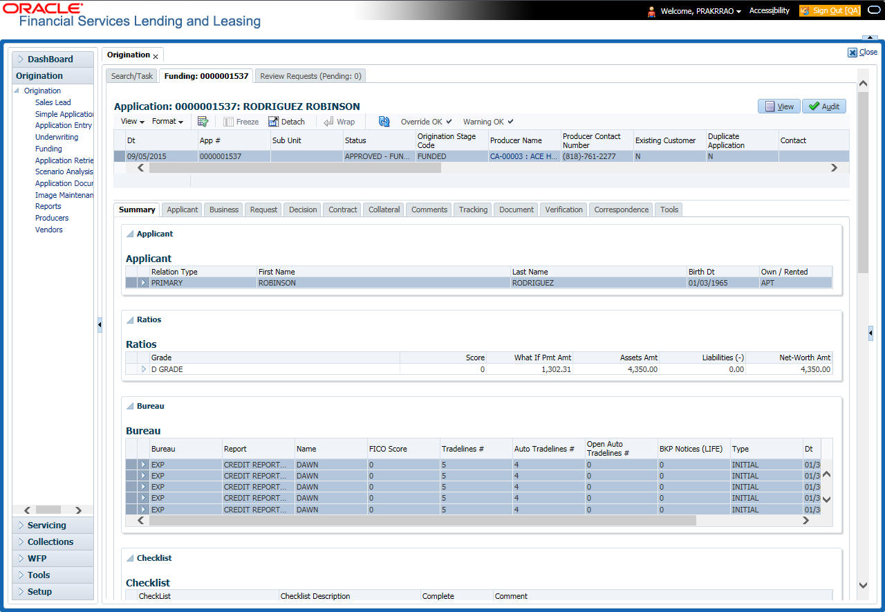

8.4 Summary Tab
The summary screen provides a unified view of the application details without navigating to the respective screens/ sub-tabs.
Using this screen, the user can view the applicant details, asset details, ratios (only for Primary Applicant), trade-In, requested details, approved details, itemization, decision history, alerts, comments, and checklist details in the respective section.
To view the Summary
  1. Open the Funding screen and load the application you want to work with.
  2. Click Summary.
For details on this screen refer Summary Tab section in Underwriting chapter.

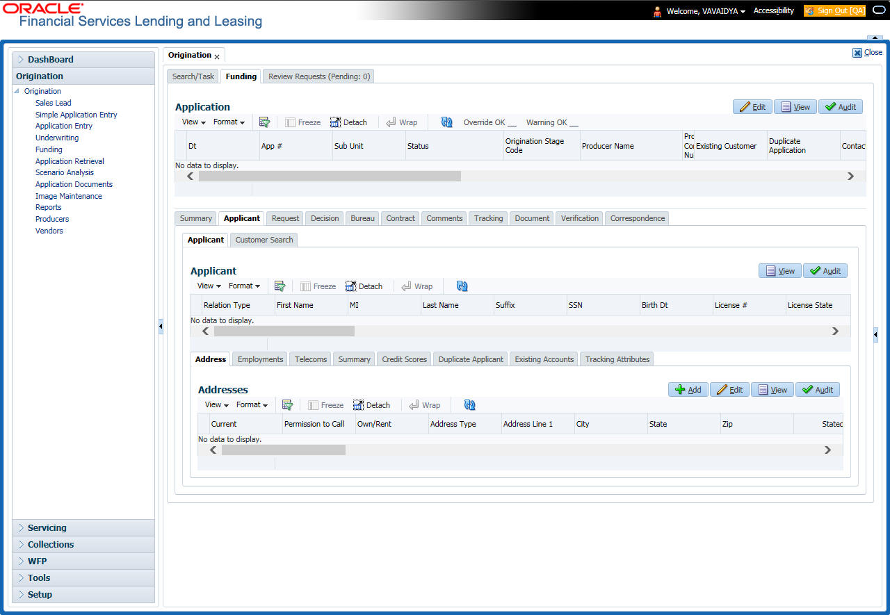

8.5 Applicants Tab
Having selected and loaded an application, you can use the Applicants link to view information about the applicant (s). This is information that was recorded on the Application Entry screen or gathered during the credit pull. You can edit the data from the Application Entry screen at anytime in the following steps. Remember to save your work with each change. Information from the credit bureau pull is available to view only.
To verify information about an applicant
  2. In the Funding tab, click Applicants.
  3. In the Applicants Details section, select the applicant you want to verify and click Edit.
For details on this screen refer Applicant Tab section in Underwriting chapter.

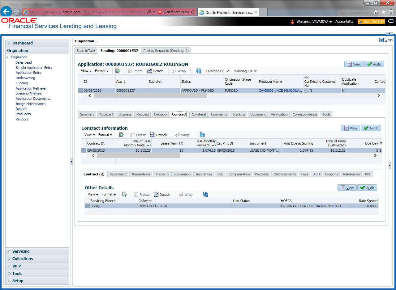

8.10 Contract Tab
The screens associated with the Contract link are the core of the funding process. They allow you to perform the important task of completing the truth-in-lending details. These screens include information mandated by Regulation Z; information about the financed amount, the payment schedule, the total of these payments, the finance charge, the resulting annual percentage rate (calculated according to Federal/Central bank guidelines; that is, within 125% of the Treasury OCC calculated APR) for the conventional Lease, and internal rate of return for Islamic Lease. Use the Lease packet to supply the required information.
In completing the truth-in-lending details on the Contract link, you will enter Lease information. The truth-in-lending details must be completed before a Lease can be funded.
The tabs opened from the Contract link share the following sub tabs:
On clicking Calculate, you can calculate the Lease amount, rate, term and payment. You can use the calculator available in Tools section for completing this step. For detailed information on using the Calculator tools, refer “Tools” chapter in the document.
To enter the contract details
  2. On the Funding screen, click the Contract tab.
  1. Using the information in the contract packet, complete the Contract section.
(The system calculator may used when completing this section. For more information, see the Tools chapter.)
  1. In this section, you can perform any of the Basic Operations mentioned in Navigation chapter.

  1. Perform any of the Basic Actions mentioned in Navigation chapter.
8.10.1 Contract (2) Sub Tab
The Contract sub screen records the application’s servicing branch and collector. It also displays additional information regarding the contract not covered on the Lease screen, such as the tolerance, delinquencies, due dates, billings, and extensions.
To complete the Contract sub tab
  2. Click the Contract > Contract sub tab.
  3. In this section, you can perform any of the Basic Operations mentioned in Navigation chapter.
8.10.2 Repayment Sub Tab
The Repayment sub screen records the application’s advance information, repayment schedule, and skipped repayment months for variable rate Lease.
To complete the Repayment sub tab
  2. Click the Contract > Repayment sub tab.
