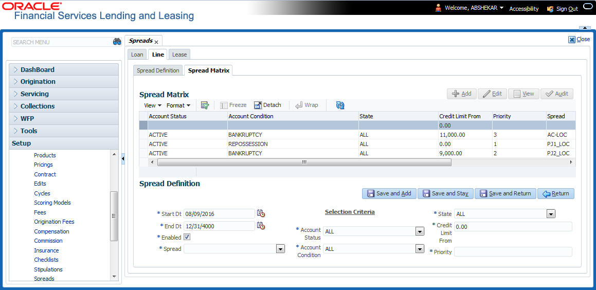

The Spread Matrix tab in Spreads screens allows you to define and maintain different combinations of spreads depending on a particular account status, Conditions, Primary Customer State, Credit Limit and Priority.
When there are multiple spreads defined for an account with different conditions, you can set the priority for the system to sequence the same.
The details maintained here are used to default the ‘Spread’ when a particular account is selected in the Payment Entry or Payment Maintenance screen.
To set up the Spread Matrix Details
A brief description of the fields is given below:
Field: |
Do this: |
Start Dt |
Select the start date for the spread from the adjoining calendar. |
End Dt |
Select the end date for the spread from the adjoining calendar. |
Enabled |
This check box is selected by default indicating that the spread is enabled. |
Spread |
Select the required product active spread from the drop-down list. |
Selection Criteria |
Account Status |
Select the account status for the spread from the drop-down list. |
Account Condition |
Select the account condition for the spread from the drop-down list. Note: You can define multiple conditions for the same account. |
State |
Select the state of the primary applicant from the drop-down list. |
Credit Limit From |
Specify the value of credit limit amount from where the system should consider the current spread. |
Priority |
Specify the priority when there are multiple conditions posted on the same account. System considers the least numbered priority as first in the sequence. |
