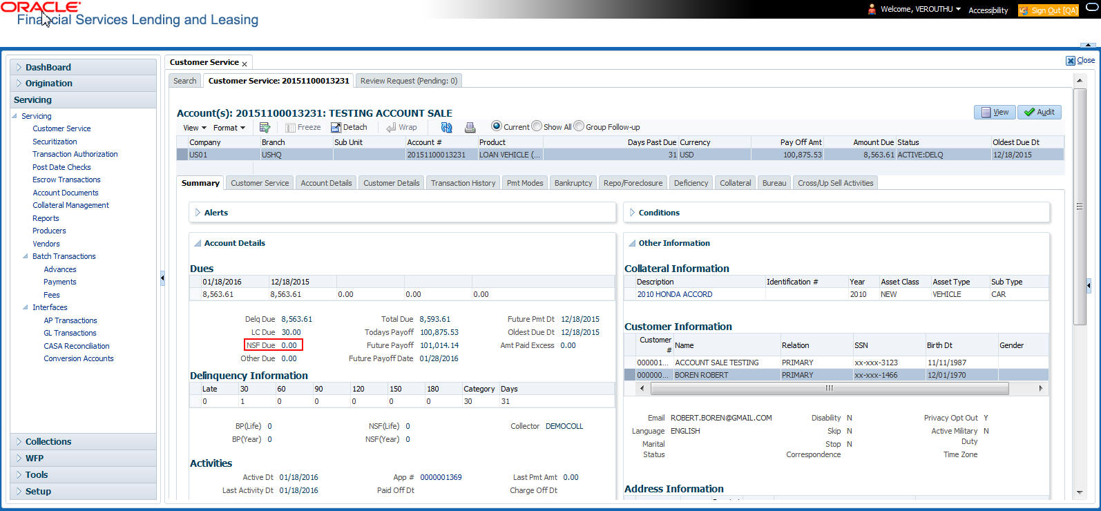

A.1.3 Nonsufficient Fund Fees
Nonsufficient fund fees are posted when a payment does not cover the amount owed. The fee that the system automatically applies to an account is recorded during setup.
Nonsufficient fund fees appear in the NSF Due field on the Dues section of Summary tab of Customer Service screen. This is the first screen to appear on the Customer Service screen when you load an account.

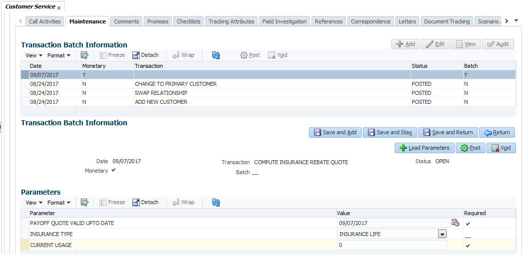

A.1.7.2 Insurance Rebate Quote
OFSLL supports the option to generated an insurance rebate quote to derive the rebate amount for all the active funded Insurances before cancelling an Insurance.
You can generate a rebate quote by posting the monetary transaction ‘COMPUTE INSURANCE REBATE QUOTE’ on an existing account in the Customer Service > Maintenance screen.
Transaction
Parameters
PAYOFF QUOTE VALID UPTO DATE
INSURANCE TYPE
CURRENT USAGE
The same transaction can also be posed to generate a backdated / future dated Insurance Rebate quote.
Note the following:
The Rebate amount is displayed in Results section of Maintenance screen.

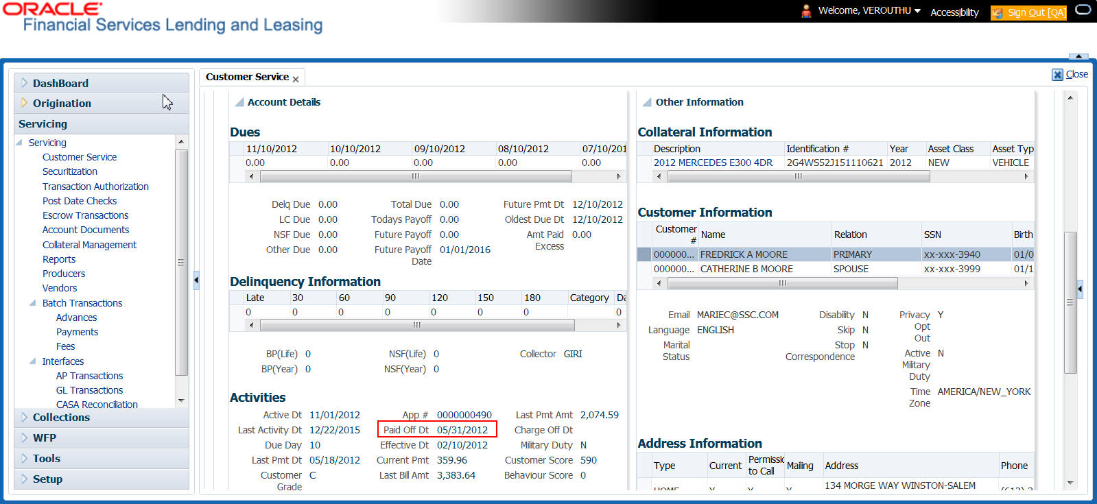

A.1.11 Account Paidoff
An account is automatically paid off or marked for payoff processing by the system with a batch transaction when the account balance is $0.00. You can also manually payoff an account with the Maintenance screen. You can also pay off an account using the Consumer Lending (Advance and Payment) form. For more information, see the Payment Processing chapter.
When you payoff an account, the system changes the account’s status to PAID OFF. The date the account was paid off appears in Activities section’s Paid Off Dt field on Account Details screen.
The system also notes the amount of the principal that was waived when account was paid off in the Waived column on Account Balances screen.
To pay off an account
Transaction
Parameters
Paid off
Txn Date
If you reverse the payoff payment using Customer Service form, then the pay-off is automatically reversed. The system changes the account’s status from PAID OFF to ACTIVE when you refresh the account.

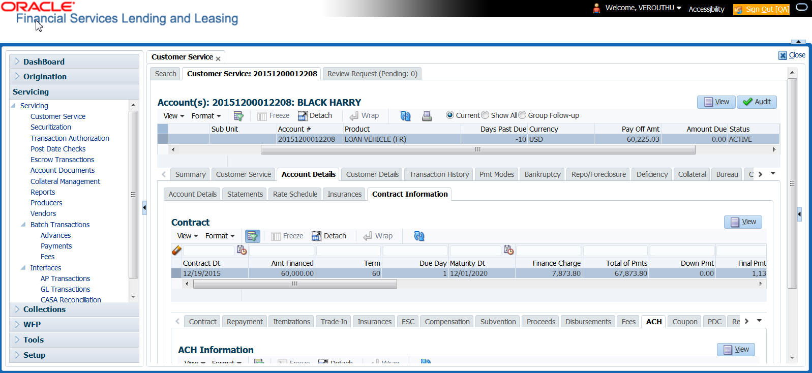

ACH Status Code
ACH Bank Name
ACH Bank Routing Number
ACH Default Indicator
ACH End Date
ACH Payment Amount
ACH Payment Amount Excess
ACH Payment Day
ACH Start Date
Txn Date
This information appears in the ACH section of the Account Details screen.
