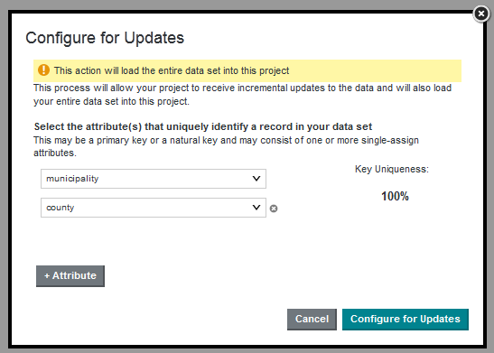

When selecting the attributes that uniquely identify a record, the uniqueness score must be 100%. If the record identifier is not 100% unique, the Data Processing workflow will fail and return an exception. In this example, the Key Uniqueness field shows a 100% figure:

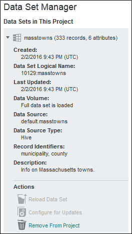

After the data set is configured, its entry in the Data Set Manager page looks like this example:
Note that the Record Identifiers field now lists the attributes that were selected in the Configure for Updates dialogue.
