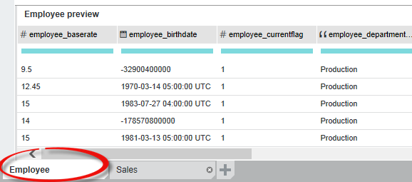

  3. Select a data set tab that you want to be the primary data set.
    For example, this project has an employee data set and a sales data set. Selecting Employee makes it the primary data set:
    Shows two data set tabs at the bottom of a project with Employee circled.

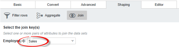

  4. From the transform menu, select Shaping and then Join.
  5. Confirm that the secondary data set that you want to join is selected.
    For example, this project joins an employee data set to a sales data set:
    Shows a drop down list with the right side of the join.

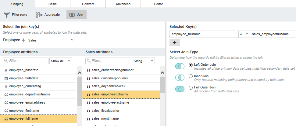

  6. Create a unique join key from attributes that are the same data type.
    1. Click an attribute name from the primary side of the join to highlight it.
      The attribute is added to the left side of the Select Keys list. Also note that Studio restricts available attributes on the right side to those of the same data type.
    2. Select a key operator (equals, less than, greater than, etc) to determine how the key is built.
      For example, employee_fullname on the primary side might equal sales_employeefullname on the secondary side.
    3. Click an attribute name from the secondary side of the join to highlight it
      The attribute is added to the right side of the Select Keys list. For example, this key is employee_fullname equals sales_employeefullname:
      A join with a single key based on full name.
    4. If a single attribute is not sufficient to guarantee uniqueness across the joined record set, click the + icon and repeat the above steps a - c to build a compound key using a second set of attributes.
