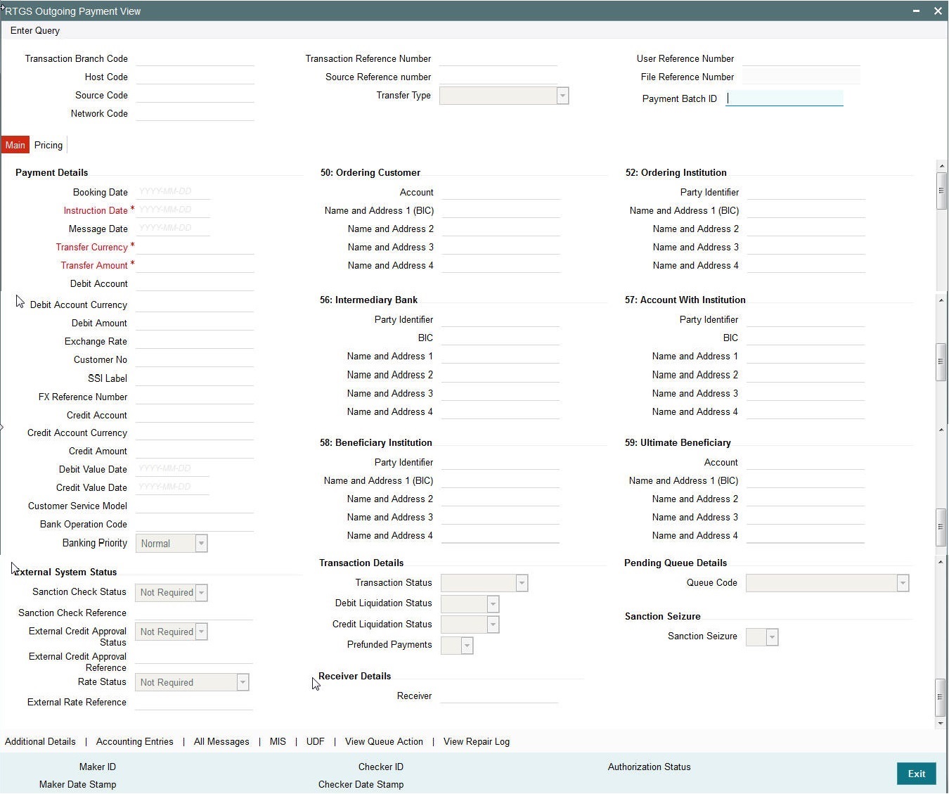

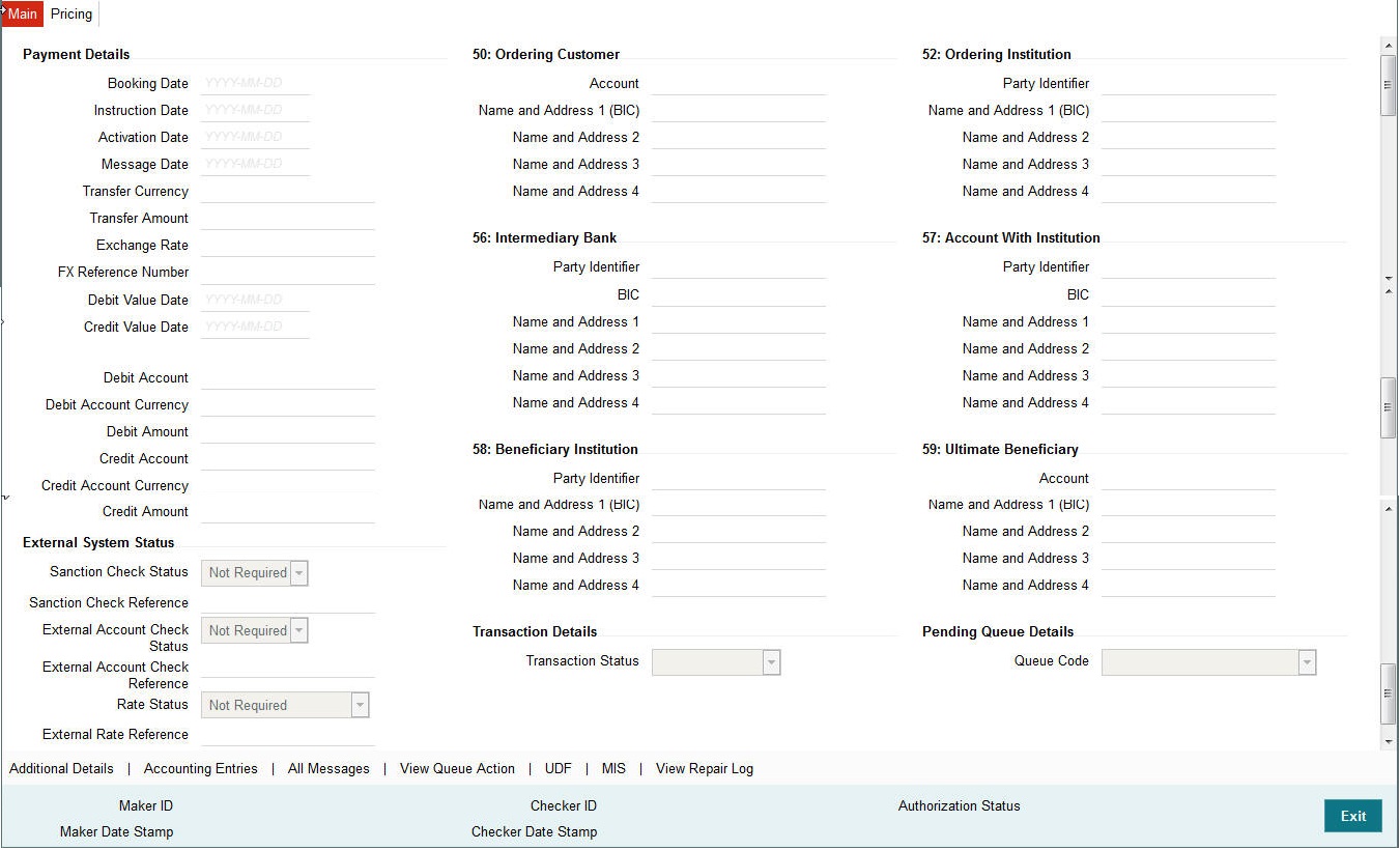

You can perform RTGS outgoing transaction. All transactions that are entered using this screen has payment type as ‘RTGS’ and transaction type as ‘Outgoing’. You can invoke ‘RTGS Outgoing Payment’ screen by typing ‘PRDOTONL’ in the field at the top right corner of the Application tool bar and clicking on the adjoining arrow button. Click new button on the Application toolbar..
You can specify the following fields:
Transaction Branch code
The system defaults the transaction branch code with the user’s logged in branch code.
Host code
The system defaults the host code of transaction branch.
Source Code
The system defaults the source code field. For manual transactions source code is defaulted as MANL.
Network Code
You can select the required network. All open and authorized networks for a transaction and transfer type are listed.
Transaction Reference number
The system generates the transaction reference number. For more information on the format, refer the Payments Core User Manual.
User Reference Number
The system displays transaction reference number. However you can modify this.
Transfer Type
Select the required type of transfer.
Pre-funded Payments:
Checking this flag indicates that this is a pre-funded payment, so only the Credit leg of accounting i.e. Nostro accounting would need to be performed by the system.
Click ‘Main’ tab to capture the Debit/ Payments details:
Specify the following details
Debit Account Number
Specify the debit account number. Alternatively, you can select the debit account number from the option list. The list displays all open and authorized accounts.
Account IBAN
The system defaults the account IBAN based on the debit account number field selected.
Account Currency
The system defaults account currency based on the debit account number selected.
Debit Amount
The system populates this field as the transfer amount converted in debtor account currency.
Booking Date
The system defaults the booking date as application server date.
Instruction Date
The system defaults this date as application server date and the payment will be processed on the Instruction Date.
User can modify the date to a future date, if required. Back valued payments will not be allowed. Instruction date will be validated for network holidays maintained and error message will be thrown. User will be forced to change the instruction date to a working date for the network.
Activation Date
The system defaults the activation date same as application server date.
Transfer Currency
The system defaults transfer currency if the network allows only single currency as per Network currency preferences (PMDNCPRF).
If multiple currencies are allowed then the system allows you to specify the transaction currency. Alternatively, you can select the transaction currency from the option list. The list displays all valid transaction currencies maintained in the system.
Transfer amount
Specify the transaction amount.
Exchange Rate
Specify the exchange rate if debit account currency is different from the transfer currency. The system retains the input value and validates the same against override and stop variances maintained in the Network preference.
If exchange rate is not specified, then the system populates the exchange rate on enrich or save, if the transfer amount is less than small FX limit maintained. If transfer amount is more than small FX limit and, if external exchange rate is applicable, then rate pick up will happen during transaction processing.
Remarks
Specify the internal remarks, if any.
Debit Value Date
The system would derive the debit value date as part of transaction processing. This field will be disabled for user input.
Credit Value Date
The system would derive the credit value date as part of transaction processing. This field will be disabled for user input.
Customer
The system displays the CIF of the debit customer for outgoing transactions.
SSI Label
Select the required SSI label from the list of values.
Note
This list will be populated with valid SSI Labels, applicable for the customer and the Network. If Customer or Network details are not available, the fetch action of the list of values displays the information message to this effect. The list of values is queried based on the fields SSI Label, Beneficiary Bank ID, Beneficiary Account & Account IBAN.
Customer Service Model
This is the Service model to which the customer is attached. System will derive the customer service model from the customer service model linkage maintenance (PMDCSMLK)
Note
Customer and Customer Service Model is not applicable if the debit account is GL.
Enrich button
Click the Enrich button to populate the exchange rate, debit amount and charge/tax amounts.
If exchange rate pick up or charge pick up fails, system will throw error. User can then provide the required values and proceed with the transaction.
23B: Bank Operation Code
The value of CRED would be defaulted in this field. If any other value is desired then select one of the following codes using LOV:

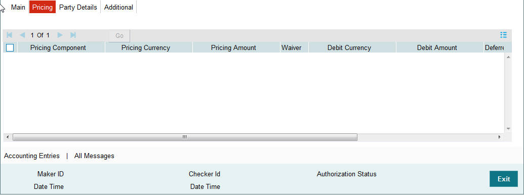

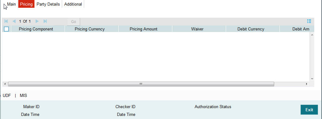

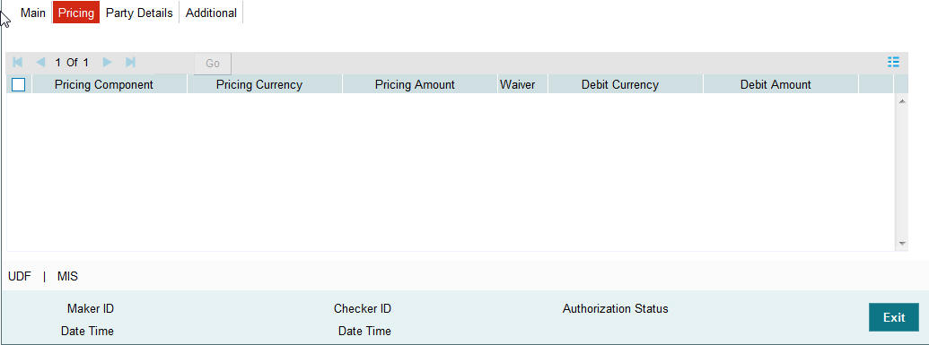

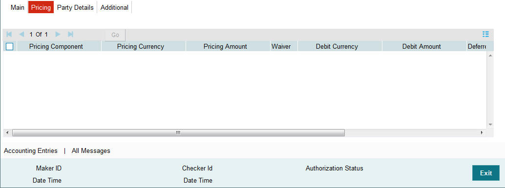

This tab displays the pricing details of the charges computed by system based on the transaction attributes in the Main tab.
The below mentioned attributes will be available in the Pricing tab
Pricing Component
Displays the name of the pricing component applicable for the transaction.
Pricing Currency
Displays the currency in which the charge amount is calculated for the Pricing component.
Pricing Amount
Displays the charge amount calculated for each pricing component.
Waived
Check this box to indicate that the charge is waived for the pricing component.
Debit currency
Displays the currency in which the charge amount is debited for the pricing component.
Debit amount
Displays the amount in debit currency to be debited.
Debit account
Displays the account from which the charge would be debited.
Exchange Rate
Displays the exchange rate applied to calculate the charge in debit amount.
50: Ordering Customer
During enrichment (or save), the debtor account number will be populated in the Account field. Name and address will be populated with customer details of the account present in Customer maintenance (CIF).
You can modify the following details:
Account
This field is disabled for user input.
BIC
You can select the BIC using LOV.
Name and Address 1
Specify the name or the first line of the Ordering Customer’s address. A maximum of 35 characters are allowed in each of these Name and Address fields.
Name and Address 2
Specify the continuation of name and the second line of the address.
Name and Address 3
Specify the third line of the address.
Name and Address 4
Specify the fourth line of the address.
52: Ordering Institution
Party Identifier
Specify a national clearing code. The following codes should be used, preceded by '//’.
| AT | 5!n | Austrian Bankleitzahl | |||
| AU | 6!n | Australian Bank State Branch (BSB) Code | |||
| BL | 8!n | German Bankleitzahl | |||
| CC | 9!n | Canadian Payments Association Payment Routing Number | |||
| CH | 6!n | CHIPS Universal Identifier | |||
| CN | 12..14n | China National Advanced Payment System (CNAPS) Code | |||
| CP | 4!n | CHIPS Participant Identifier | |||
| ES | 8..9n | Spanish Domestic Interbanking Code | |||
| FW | without 9 digit code | Pay by Fedwire | |||
| GR | 7!n | HEBIC (Hellenic Bank Identification Code) | |||
| HK | 3!n | Bank Code of Hong Kong | |||
| IE | 6!n | Irish National Clearing Code (NSC) | |||
| IN | 11!C | Indian Financial System Code |
BIC
Select the BIC using LOV.
Name and Address 1
Name and Address 2
Name and Address 3
Name and Address 4
57: Account with Institution
Party Identifier
Name and Address 1
Name and Address 2
Name and Address 3
Name and Address 4
58: Beneficiary Institution
Party Identifier
Name and Address 1
Name and Address 2
Name and Address 3
Name and Address 4
59: Ultimate Beneficiary
These fields should not be input in case of Bank Transfer.
BIC
Name and Address 1
This field is an display field. Ultimate Beneficiary name will be defaulted here from the Main tab.
Name and Address 2
Specify the name and the first line of the Ultimate Beneficiary’s address.
Name and Address 3
Specify the name and the second line of the Ultimate Beneficiary’s address.
Name and Address 4
Specify the name and the third line of the Ultimate Beneficiary’s address.

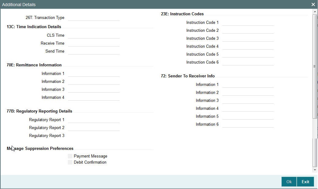

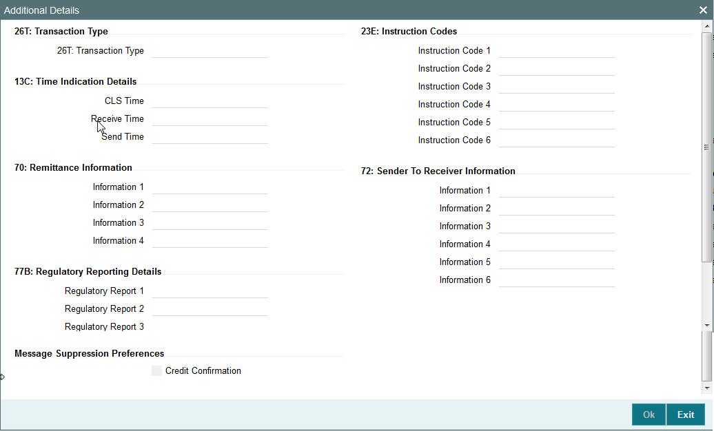

Specify the additional details in this screen. Click on the ‘Additional’ tab to invoke this screen.
This field specifies one or several time indication(s) related to the processing of the payment instruction.
TilTime
Specify the time up to which the transactions must be executed.
FroTime
Specify the time from which the transactions that must be executed.
RejTime
Specify the time from which the transactions that must be executed up to a certain time.
Time should be input in the hhmm+/-iinn format, as per the SWIFT standard. ii and nn are the hours and minutes of UTC shift whereas the “hhmm“ are to be filled with the local time.
70: Remittance Information
Specify the information for the Ultimate Beneficiary of the transfer. This is applicable for customer transfer only.
Specify the sender to receiver information.
77 B: Regulatory Reporting
Specify the codes for the statutory and regulatory information required by the authorities in the country of Receiver or Sender.
26 T: Transaction Type
Specify the nature of the transaction. Maximum of 3 alpha-numeric characters are allowed. This is applicable for Customer Transfers only.
23E: Instruction Codes
Select the type of instruction codes, using that are SWIFT compliant and applicable to the transaction accounts:
Banking Priority
Select the required priority of payment messages.

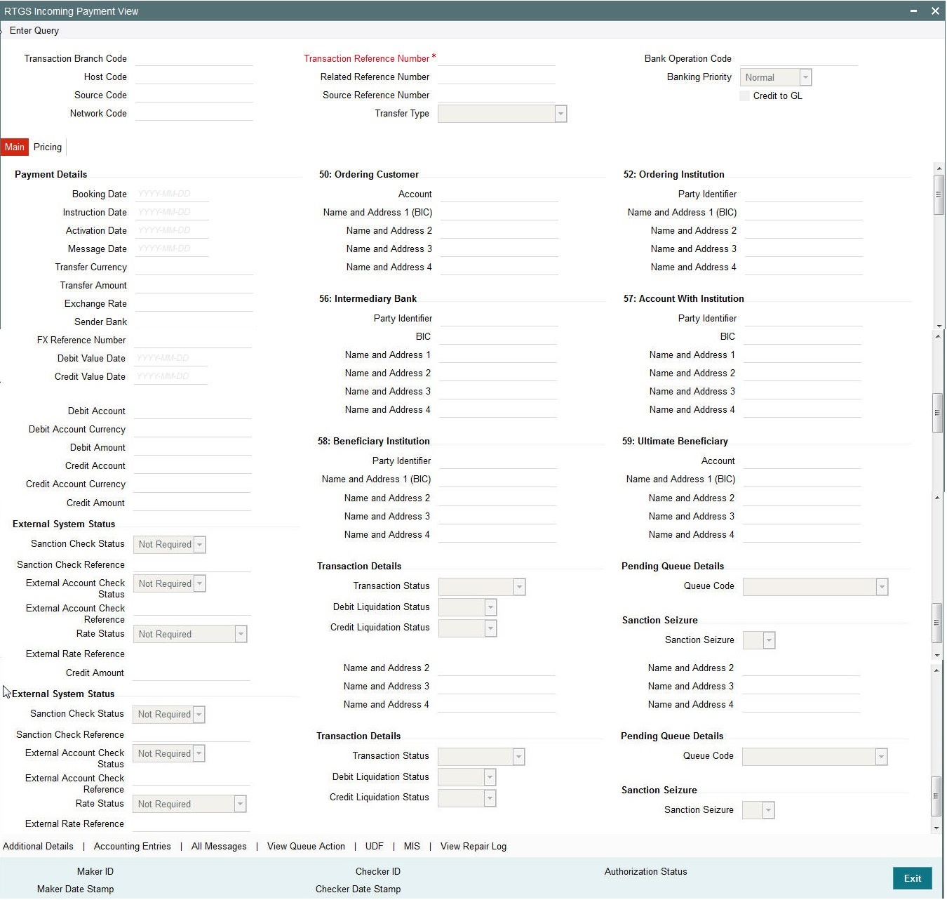

You can view the RTGS outgoing transaction in this screen.
You can invoke “RTGS Outgoing Payment View” screen by typing ‘PRDOVIEW’ in the field at the top right corner of the Application tool bar and clicking on the adjoining arrow button. Click new button on the Application toolbar..
You can view any outgoing RTGS transaction that is initiated by specify inputting the Transaction Reference number and clicking ‘Enter Query’ button.
The transaction is displayed containing values populated for following different fields:
Transaction Branch Code
Specify the transaction branch code.
Transaction Reference Number
The system specifies the transaction reference number.
Host Code
Specify the host code.
The system specifies the User Reference Number.
Source Code
Specify the Source Code.
Transfer Type
The system specifies the type of transfer.
Network Code
Specify the required network code. The system displays all the fields in the below mentioned tabs based on the transaction reference number selected.
Payment Batch ID
Specify the Payment Batch ID.
Click ‘Main’ tab to invoke this screen.to view the field. Refer Section 3.4.2 for details.
You can view pricing details in this screen that are computed by the system during the processing. Click on the ‘Pricing’ tab to invoke this screen and view the field details. Refer to Section 3.4.2 for description of any field..
Click on the ‘Additional Details’ tab to view the field details. Refer to sec. 3.4.5 for description of any field

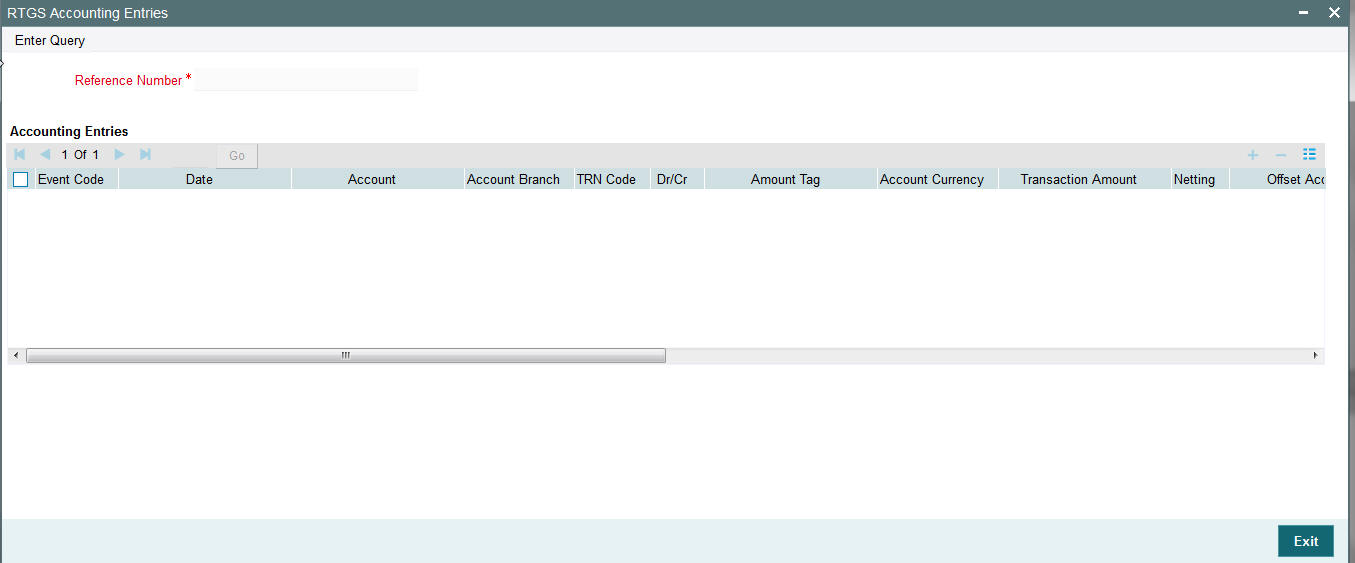

You can capture accounting entries in this screen Click the Accounting Entries tab.

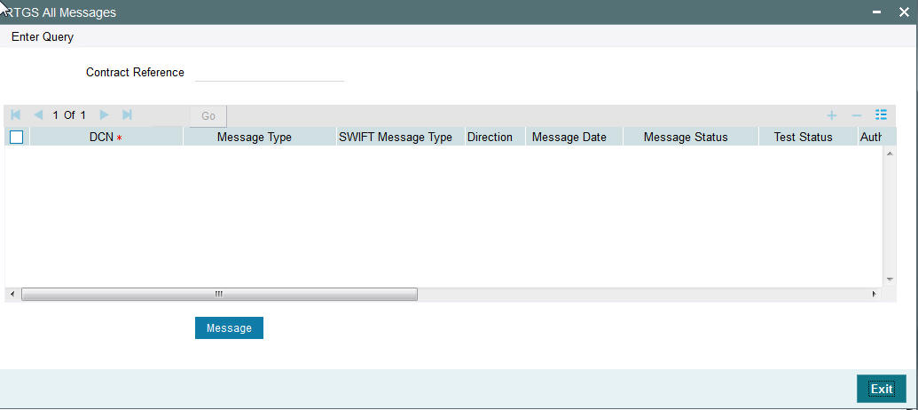

You can capture details of RTGS messages in this screen Click the All Messages tab.

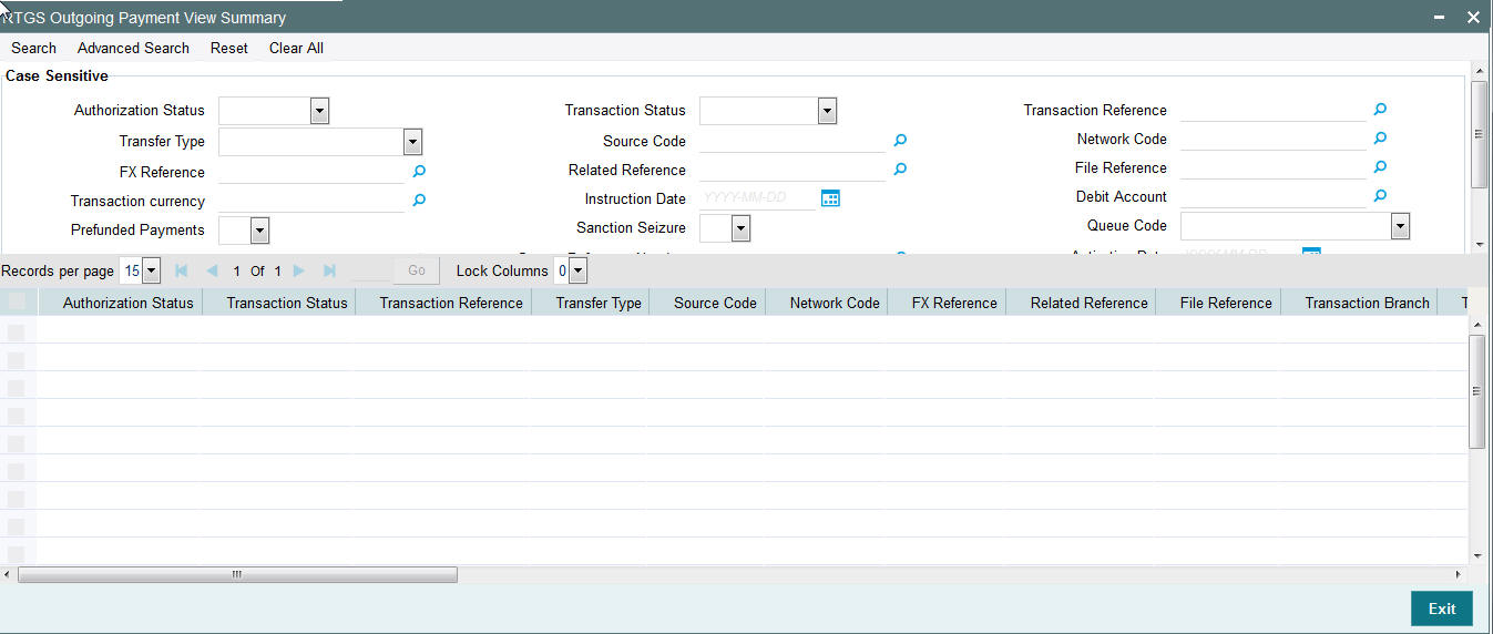

You can invoke “RTGS Outgoing Payment View Summary” screen by typing ‘PRSOVIEW’ in the field at the top right corner of the Application tool bar and clicking on the adjoining arrow button. Click new button on the Application toolbar..
You can search for the records using one or more of the following parameters:
Once you have specified the search parameters, click ‘Search’ button. The system displays the records that match the search criteria

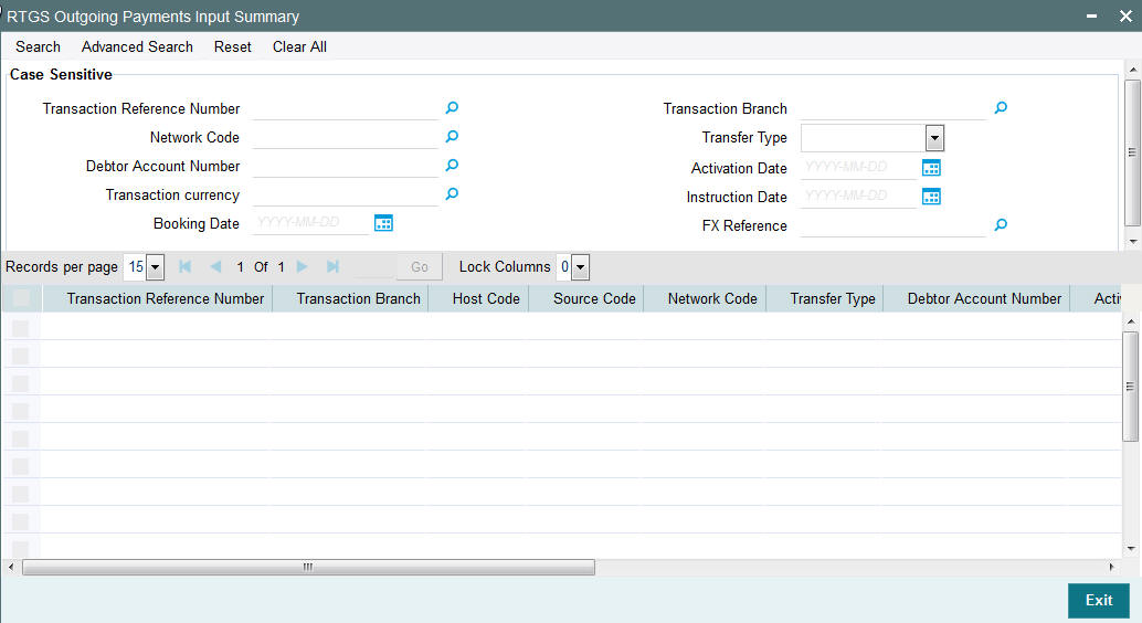

You can invoke “RTGS Outgoing Payments Input Summary” screen by typing ‘PRSOTONL’ in the field at the top right corner of the Application tool bar and clicking on the adjoining arrow button. Click new button on the Application toolbar..
Once you have specified the search parameters, click ‘Search’ button. The system displays the records that match the following search criteria.

This tab displays the pricing details of the charges computed by system based on the transaction attributes in the Main tab..
Pricing Component
Displays the Name of the pricing component applicable for the transaction.
Pricing Currency
Displays the Currency in which the charge amount is calculated for the Pricing component.
Pricing Amount
Waived
Debit currency
Debit amount
Debit account
Exchange Rate
TilTime
FroTime
Specifies the time up to which the transactions that must be executed.
RejTime
Specifies the time up to which the transactions must be executed.
Specify the sender to receiver information from the sender.
Select the type of instruction codes using LOV, which are SWIFT compliant and applicable to the transaction accounts:
Banking Priority
Default value will be normal.
Receiver
This is a display field, It is auto-populated with the Receiver BIC of the outgoing payment transaction. This field is derived while processing the outgoing RTGS transaction.
Credit Confirmation
This flag is unchecked by default. Check this box to indicate that credit confirmation message MT 910 is to be suppressed.

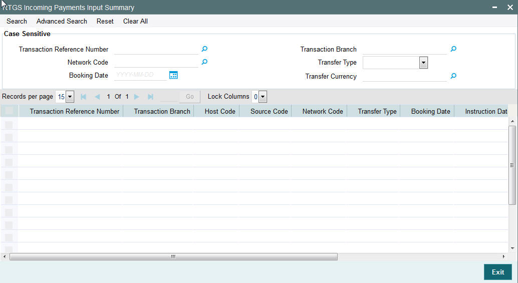

You can invoke “RTGS Incoming Payments Input Summary” screen by typing ‘PRSITONL’ in the field at the top right corner of the Application tool bar and clicking on the adjoining arrow button. Click new button on the Application toolbar..
You can view the RTGS incoming transaction in this screen.
You can invoke “RTGS Incoming Payments” screen by typing ‘PRDIVIEW’ in the field at the top right corner of the Application tool bar and clicking on the adjoining arrow button. Click new button on the Application toolbar..
You can view any incoming RTGS transaction that is initiated by specify inputting the Transaction Reference number and clicking ‘Enter Query’ button.
Displays the transaction branch code.
Displays the transaction reference number.
Host Code
Displays the host code.
Displays the User Reference Number.
Source Code
Displays the Source Code of the transaction.
Transfer Type
Displays the specifies the transfer type of transfer the transaction.
Network Code
Displays the Network code. The system further displays values of all applicable fields in the below mentioned tabs based on the transaction reference number that was input.
Click on the ‘Main’ tab to invoke this screen and view the field details. Refer Section 3.7.2 for description of any field.
You can view pricing details in this screen that are computed by the system during the processing. Click on the ‘Pricing’ tab to invoke this screen and view the field details. Refer to section 3.7.3 for description of any field..
Click on the ‘Additional Details’ tab to view the field details. Refer to sec. 3.7.5 for description of any field.
