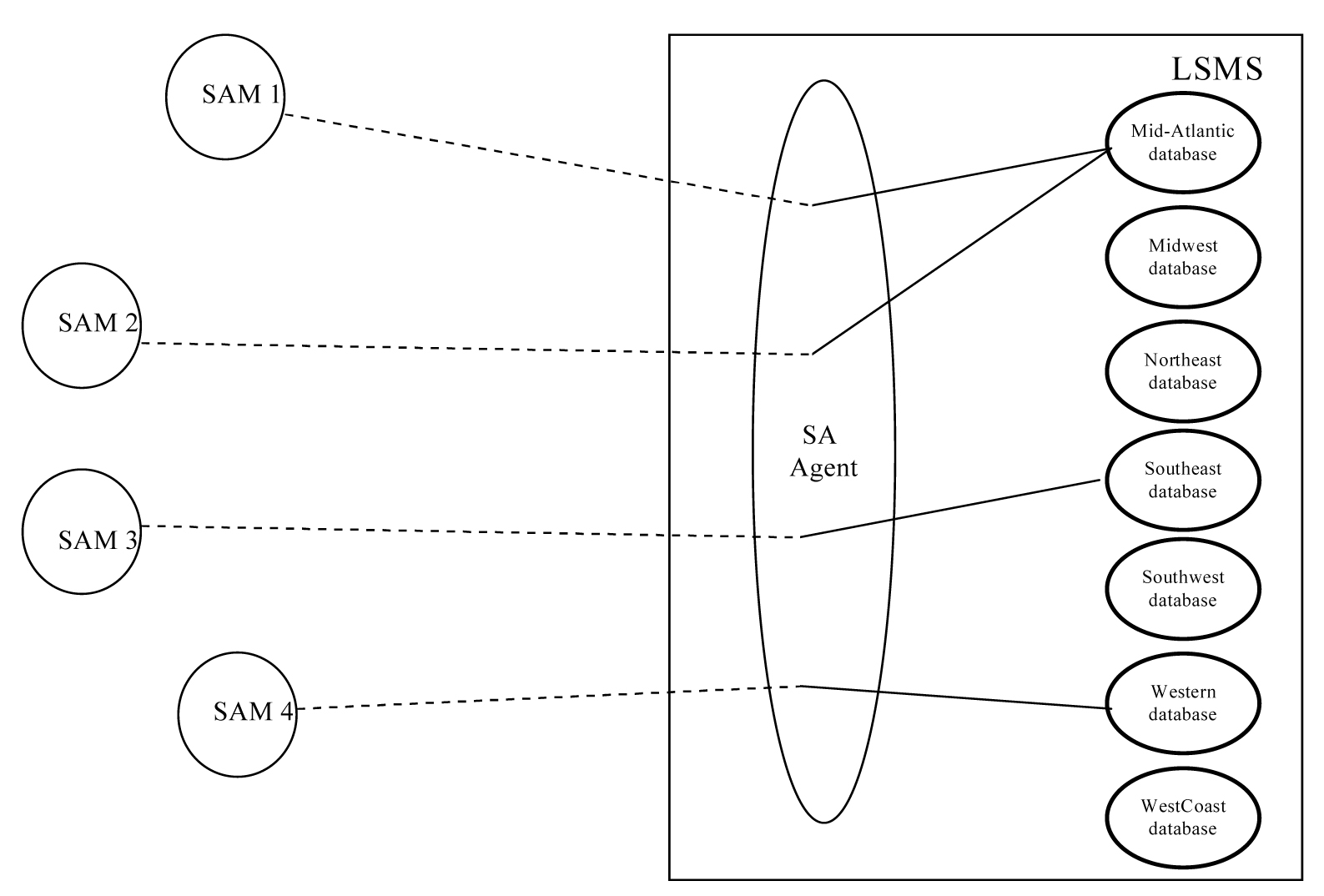

The Service Assurance feature allows an external system to access subscription version data from the LNP databases in the LSMS. This information is useful in verifying correct porting of data, and helps in troubleshooting problems. There is one LNP database for each of the NPACs associated with the LSMS.
The external system uses Service Assurance Manager (SAM) application software to initiate service assurance data requests and associations. Single or multiple SAMs may exist on the external computer system. The SAM communicates with the LSMS through the Service Assurance Agent (SAA) application software that resides in the LSMS. The SAM application software is not Oracle software and is only resident on the external system.
The SAA decodes the queries from the SAM and then accesses the LNP database. The SAA forms the subscription version data into a message and that message is sent to the SAM making the query.
Service Assurance works in conjunction with the Surveillance feature. The Surveillance feature issues the command to start the Service Assurance agent (part of the Service Assurance feature that is described in this document), and it monitors the status of the Service Assurance agent.
A maximum of eight SAM/SAA sessions are allowed at one time.
Figure 1. Service Assurance System within a Network
The architecture used to provide the access is a Connection Oriented Manager/Agent using Common Management Information Protocol (CMIP). CMIP provides an industry standard interface between Manager and Agent applications. This allows you to use standard products and tool kits to develop applications.

The SAM is restricted to querying subscription versions by the subscriptionTN field. Up to four SAMs can query the LSMS at the same time.

The LSMS supports four OSI address connections for Service Assurance interfaces, which correspond to eight domains.
Each Service Assurance system needs to establish only the associations it requires, without regard to whether the LSMS is operating with the primary or secondary server. Upon switchover, the association is momentarily lost. The Service Assurance system tries to reestablish the association. When the active system finishes coming up, it then responds to the Service Assurance system association requests. The Service Assurance system does not know whether the primary or secondary system is running.

The LSMS supports one association per Service Assurance system.
