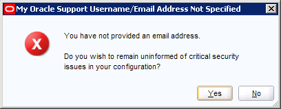

    The following warning screen can be shown.
    Surrounding text describes weblogic-7.png.
  8. To confirm click Yes.

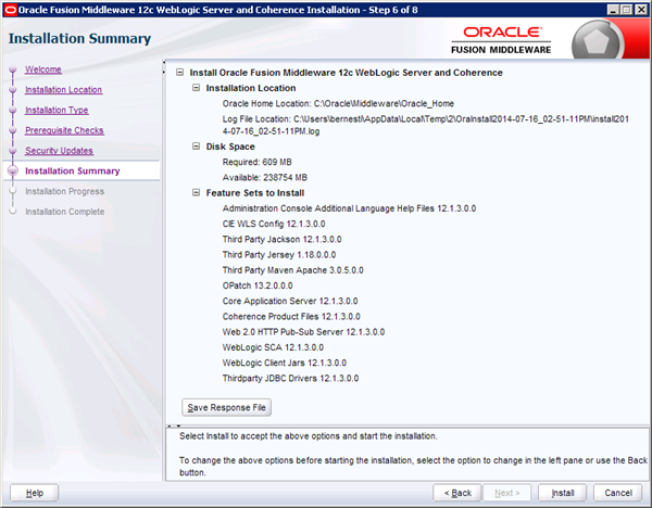

    The Installation Summary screen is opened.
    Surrounding text describes weblogic-8.png.
  9. Review the listed options and click Install.
