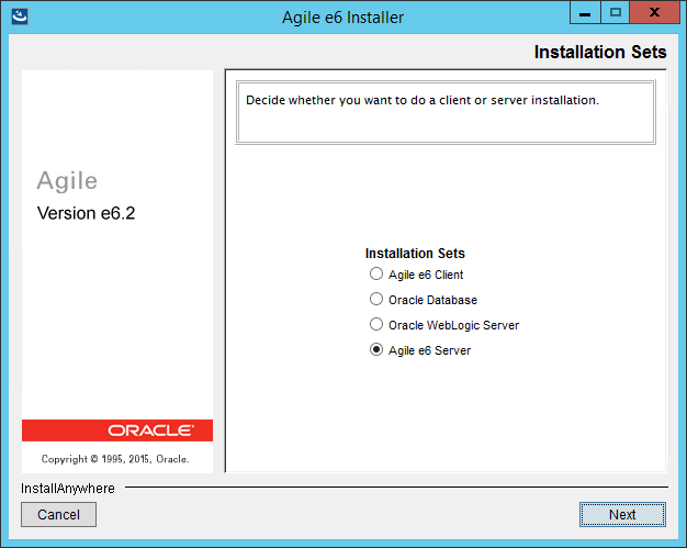

The Installation Sets screen is opened.
Select Agile e6 Server and click Next.

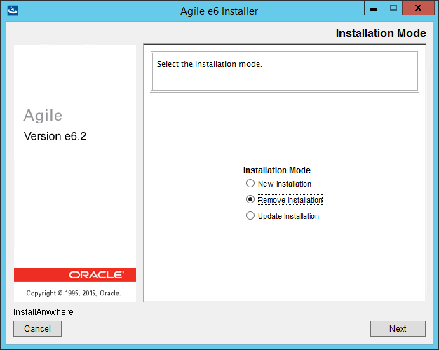

The Installation Mode screen is opened.
Select Remove Installation and click Next.
Select the name of the installation to be deleted.
Note: All parts of the installation will be removed. The installation directory will be renamed. It can be deleted if it is not used. |
