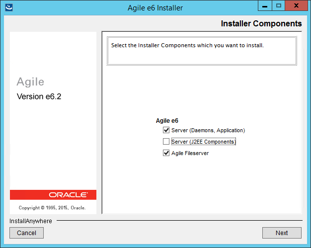

The Installer Component screen is opened.
Deselect Server (J2EE Components).
This will prevent the setup of the Agile e6 J2EE Components.
If you do not want the Agile File Server to be installed, deselect it too.
Click Next.

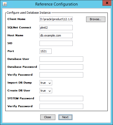

The Reference Configuration screen is opened.
The following values must be identical for the native and the J2EE installation.
| Setting | Description |
| Database User | The database user you want to use for the application. |
| Database Password | The password of the database user. |
When the reference configuration options are defined, click Next.

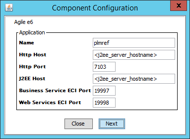

Adapt the values in the Component Configuration mask.
| Name | The name of the default application you want to create. |
The J2EE Components are not installed at this point. You have to use the values marked in red later to setup the Agile e6 J2EE components.
Following values must match the values of your J2EE installation. These are references to these values.
| Http Host | The host where the Web Client can be reached over HTTP (the WebLogic server hostname). |
| Http Port | The port where the Web Client can be reached over HTTP (the HTTP port of WebLogic server). |
| J2EE Host | The host where WebLogic is running (the WebLogic server host name). |
| Business Service ECI Port | The port where the Business Service will be configured to "wait" for requests. |
| Web Services ECI Port | The port where the Web Services will be configured to "wait" for requests. |

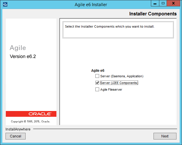

The "Installer Component" screen is opened. By default, all options are selected.
Deselect Server (Daemons, Application) and Agile Fileserver.
This will prevent the setup of the "Agile e6 Native Components".
Click Next

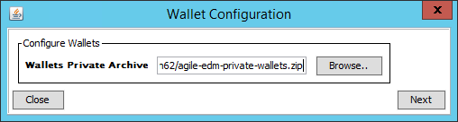

The Wallet Configuration screen is opened.
On the J2EE server, select the path to the archive of the private Wallet, which was generated on the Agile EDM Server.
Click Next.

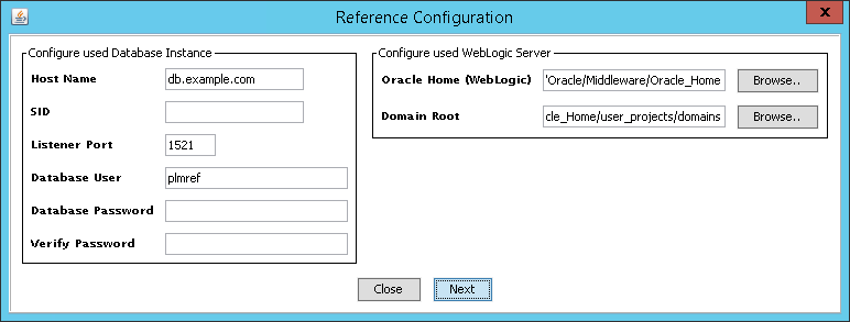

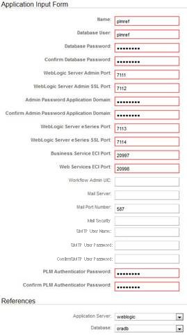

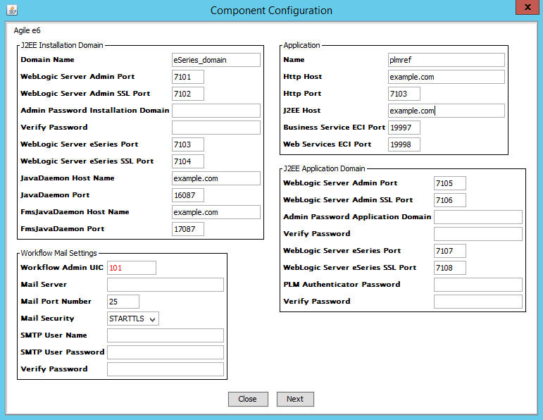

In a component based installation, every application has to be created on the native installation, and on the J2EE installation. The Administration client, however, is available for both installations. The Administration client checks whether it should manage a J2EE or a native installation.
Applications can be created as usual. Following two screenshots show the differences to the default web forms for the application creation with the Administration Client.
J2EE Application Creation
NATIVE Application Creation
