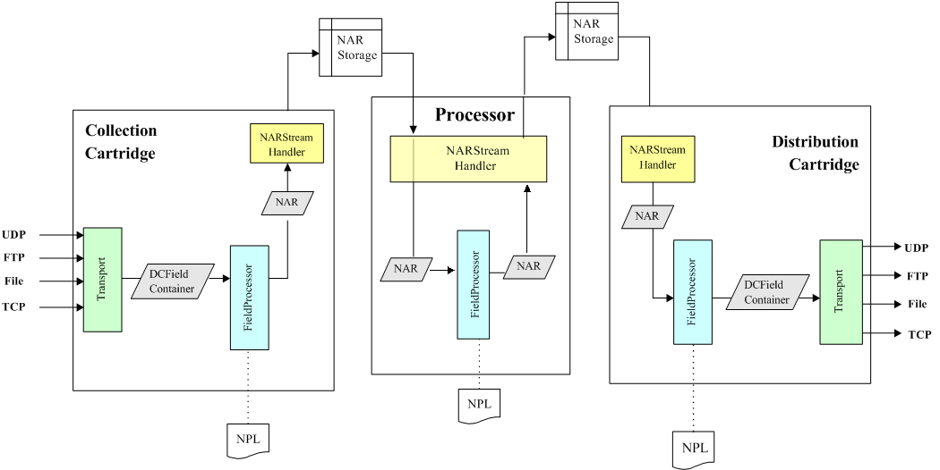

Data flow diagram
Figure 1-1 shows the flow of data through any given node chain.

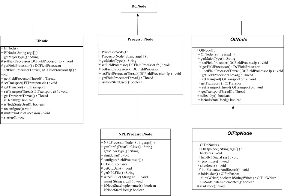

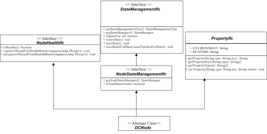

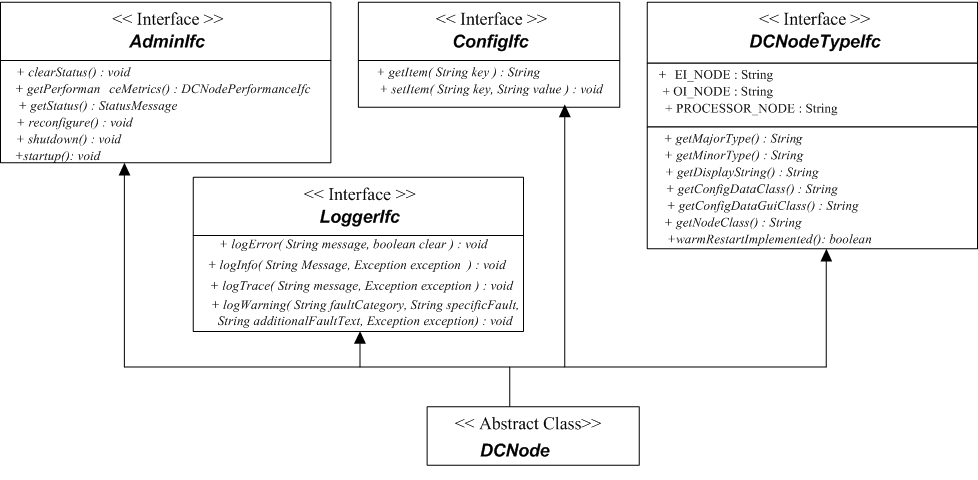

DCNode class hierarchy
Figure 1-2 and Figure 1-3 illustrates the class hierarchy of the base DCNode classes. Details of individual node components are included in later sections of this document. Methods that should be overridden are in italics.
All derivations of DCNode should provide a default (i.e. no-argument) constructor, which initializes the information necessary to implement DCNodeTypeIfc.
Figure 1-2 DCNode Class Hierarchy
Description of Figure 1-2 follows
Description of ''Figure 1-2 DCNode Class Hierarchy''
The StateManagement and NodeStateManagement interfaces are currently not supported.
Figure 1-3 DCNode Class Hierarchy
Description of Figure 1-3 follows
Description of ''Figure 1-3 DCNode Class Hierarchy''

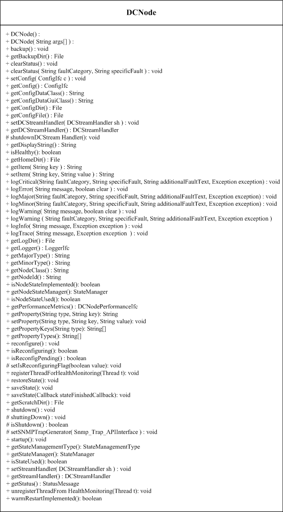

DCNode class diagram
Figure 1-4 illustrates the DCNode classes.
Figure 1-4 DCNode Class Diagram
Description of Figure 1-4 follows
Description of ''Figure 1-4 DCNode Class Diagram''
Figure 1-5 DCNode Class Hierarchy
Description of Figure 1-5 follows
Description of ''Figure 1-5 DCNode Class Hierarchy''

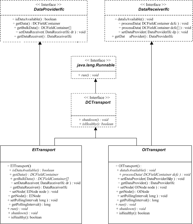

Transport
A Transport is responsible for moving data into and out of the Offline Mediation Controller system. Transports are only associated with CC or DC nodes.
EITransport
An EITransport is a DataProvider that accepts data from outside of the Offline Mediation Controller system and creates the appropriate EIRecord objects for that data. Therefore, the EITransport needs to know the record delimiter, as well as the EIRecord object to be populated from each raw data record. An EITransport may contain a factory (described later), which would be responsible for creating the appropriate EIRecord objects when needed, or receive this class type information as a parameter. In cases where data may be coming in rapidly (for example, via UDP packets in a CC node), the EITransport could utilize a revolving queue to store the incoming records until the DataReceiver is ready for them.
OITransport
An OITransport is a DataReceiver that receives OIRecord objects specific to the destination of the data and is responsible for transmitting that data to the desired destination. The OITransport will extract the formatted data from the OIRecord and send the data out of the Offline Mediation Controller system via the appropriate medium. The OITransport will typically receive its data from a ”push”. It is bound by the frequency of the incoming data and the speed of its DataProvider.

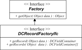

DCRecordFactoryIfc
The DCRecordFactoryIfc is a generic interface that can be used which will accept data and generate the appropriate EIRecord or OIRecord objects. This allows a Transport or FieldProcessor to behave in a generic way without having to explicitly know what type of EIRecord or OIRecord object that needs to be created based on the incoming or outgoing data.
The only time a user of the CDK would need to write their own DCRecordFactoryIfc would be if they intended to use an existing transport with a custom EIRecord.
Figure 1-6 shows the DCRecordFactoryIfc interface.
Figure 1-6 DCRecordFactoryIfc
Description of Figure 1-6 follows
Description of ''Figure 1-6 DCRecordFactoryIfc''
Transport class hierarchy
Figure 1-7 shows the hierarchy of the Transport class.
Figure 1-7 Transport Class Hierarchy
Description of Figure 1-7 follows
Description of ''Figure 1-7 Transport Class Hierarchy''

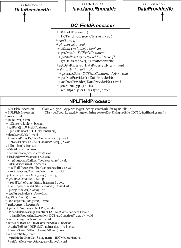

FieldProcessor
There is an NPLFieldProcessor provided, which should be used by all nodes. This class uses information contained in an ASCII text file, which contains NPL commands. (See the NPL Reference Guide for more information). The FieldProcessor utilizes the information in the NPL file to transform, translate, enhance, and/or route information from the incoming DCFieldContainer object into the appropriate outgoing DCFieldContainer object. A FieldProcessor is both a DataProvider and a DataReceiver.
FieldProcessor class hierarchy
Figure 1-8 shows the FieldProcessor class hierarchy.
Figure 1-8 FieldProcessor Class Hierarchy
Description of Figure 1-8 follows
Description of ''Figure 1-8 FieldProcessor Class Hierarchy''

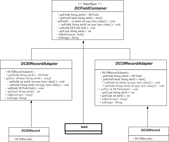

DCFieldContainer
The DCFieldContainer is a generic interface that is used for passing the data within and between nodes. A DCFieldContainer represents a single record of data. It is responsible for converting data from its raw format (for example from UDP packets, ASCII or binary files) and extracting specific pieces as fields for use by the DataReceiver.
The DCFieldContainer is where most of the work is done for a particular node. This class is responsible for knowing the format and order of the incoming (or outgoing) data, and how to extract (or assemble) that data on a per field basis.
Adapter classes are provided (DCEIRecordAdapter and DCOIRecordAdapter), which ”no-op” those methods that are not needed based on the type of DCFieldContainer. That is, a DCFieldContainer in a CC node would most likely use only the get… methods from DCFieldContainer for extracting data fields. Conversely, a DCFieldContainer in a DC node would most likely use only the set… methods.
EIRecord
EIRecord is derived from DCEIRecordAdapter and is the class that developers should derive from when developing a DCFieldContainer object for use in a CC node.
OIRecord
OIRecord is derived from DCOIRecordAdapter and is the class that developers should derive from when developing a DCFieldContainer object for use in a DC node. Note that derivations of OIRecord should include a default (i.e. no-argument) constructor in order to be utilized properly by the NPLFieldProcessor.
EIRecord and OIRecord Storage
Both the EIRecord and OIRecord classes are responsible for storing attributes. The various field functions will pass attribute IDs to distinguish between the attributes. These IDs originate from the NPL, and may be either the attribute values or names, depending on which is used in the NPL. The EIRecord and OIRecord should refrain from hard coding the possible values, as the NPL can be independently changed. Instead, more generic means, such as hash tables, should be used for storage and retrieval of these values.
NAR
As mentioned previously, the NAR is the DCFieldContainer object that is used internally within the Offline Mediation Controller system. The FieldProcessor of a CC node generates a NAR, which then may be passed through one or more processor nodes for further modification and is received by the FieldProcessor in an DC node.
A Data Dictionary provides definitions for the type of data in the fields (potentially) within a NAR. This information is currently available in a text file, located at OMC_Home/datadict/Data_Dictionary, where OMC_Home is the directory in which you installed Offline Mediation Controller.
DCFieldContainer class hierarchy
Figure 1-9 shows the DCFieldContainer class hierarchy.
Figure 1-9 DCFieldContainer Class Hierarchy
Description of Figure 1-9 follows
Description of ''Figure 1-9 DCFieldContainer Class Hierarchy''

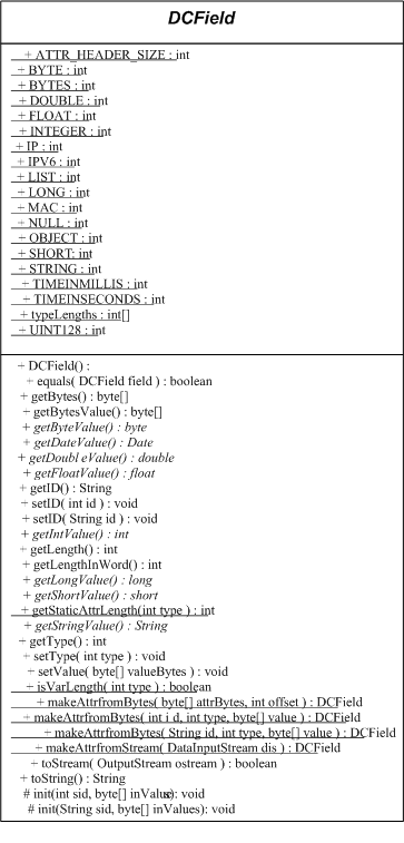

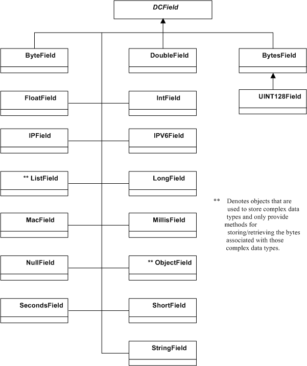

DCField
A DCField is an object that represents the attributes (fields) of a particular record. DCField objects are stored in a DCFieldContainer. Most data types can be represented with the DCField classes that are provided.
Figure 1-10 shows the DCField object and attributes.
DCField class hierarchy
Figure 1-11 shows DCField class hierarchy.
Figure 1-11 DCField Class Hierarchy
Description of Figure 1-11 follows
Description of ''Figure 1-11 DCField Class Hierarchy''

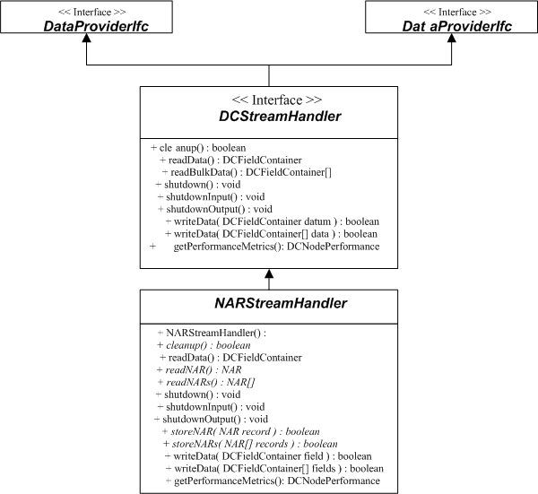

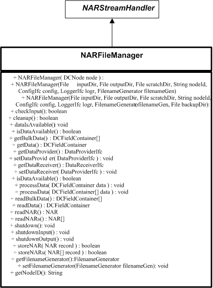

DCStreamHandler
The DCStreamHandler provides functionality to move data records from one node to the next in the node chain. The current implementation of the Offline Mediation Controller system utilizes a NARFileManager. The base node classes provide this object, and the moving of the data is transparent to the user and developer. In other words, a node developer (in general) does not need to be concerned about getting data from one node to another, this is all handled by the system. Developers only need to be concerned with moving data inside the node.
DCStreamHandler class hierarchy
Figure 1-12 shows the DCStreamHandler class hierarchy.
Figure 1-12 DCStreamHandler Class Hierarchy
Description of Figure 1-12 follows
Description of ''Figure 1-12 DCStreamHandler Class Hierarchy''
DCStreamHandler class hierarchy (continued)
Figure 1-13 shows the NARStreamHandler class.
Figure 1-13 NARStream Handler
Description of Figure 1-13 follows
Description of ''Figure 1-13 NARStream Handler''
