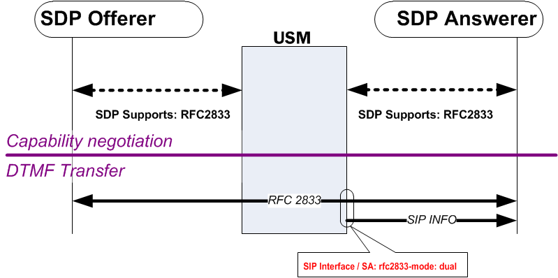

Example 1
In this example, RFC 2833 is supported on the egress side of the call. The egress SIP interface or session agent’s rfc2833-mode is set to dual mode. When the Oracle® Enterprise Session Border Controller forwards RFC 2833 to the SDP answerer, it also creates and forwards a corresponding SIP INFO message toward the target.
