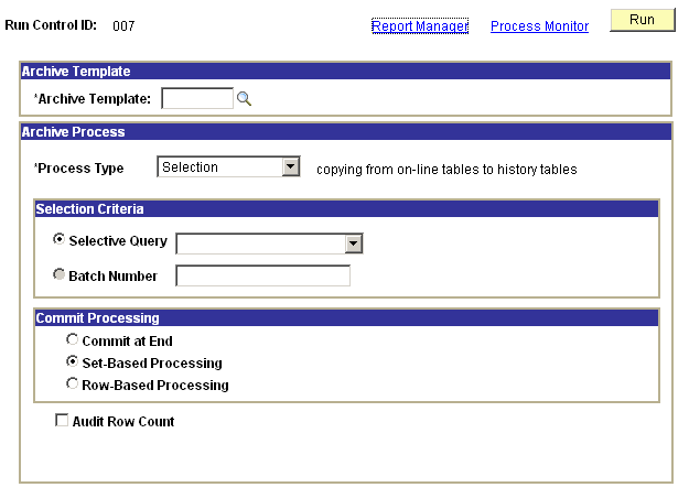

Access the Archive Data To History page (PeopleTools > Data Archive Manager > Archive Data to History).
Image: Manage Archive Jobs page
This example illustrates the fields and controls on the Manage Archive Jobs page.
Field or Control
Definition
Archive Template
Select the archive template to use for this batch job. Choosing a restore or an archive template is the way you choose the type of job to run.
Run
Click to run this batch job after defining the archive process and commit processing.
View Details
Click to access the Archive Run Cntl Details page to view the SQL and row counts of this batch job.
Note: If you're using bind variables, you must save the run control data before clicking the View Details link.
See Viewing Details.
