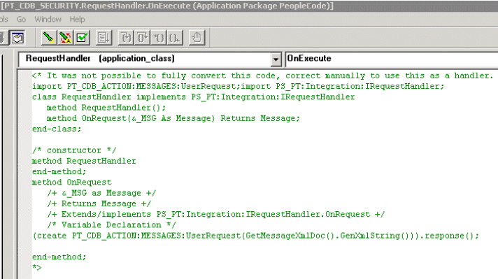

This section discusses correcting non-migrated PeopleCode and creating an Application Class type handler.
The following example shows an application class created for the PeopleTools 8.47 or earlier message PT_CDB_SECURITY. During the upgrade process, the system was unable to migrate the integration PeopleCode defined on the message.
Image: PeopleSoft Application Designer
This example illustates a PeopleTools 8.48 application class created for the PeopleTools 8.4x message PT_CDB_SECURITY.
To correct non-migrated integration PeopleCode:
  1. In PeopleSoft Application Designer, open the migrated application package.
    The package name is generally the same as the message name in the PeopleTools 8.47 or earlier system.
  2. Remove the “<*” and “*>” symbols, as well as the comments from the code.
  3. Compile the code.
    If the code did not migrate for one of the following reasons, the system displays a meaningful error message to assist you in correcting the problem:
    • Use of component scope variables.
    • Use of global variables or constant variables
    • Incorrect return type for handler.
    If the reason for the failure is due to the use of a local function, modify the PeopleCode to ensure that the function is passing appropriate types for the context in the application package.
  4. Correct the PeopleCode and save the changes.
  5. Delete the deprecated handler.
