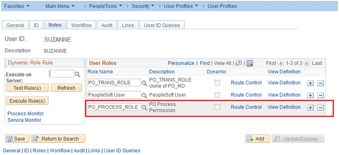

Assigning PO Process Role to Generate a PO Report
Image: User Profiles - Roles page
This example illustrates the fields and controls on the Roles page.
In this example, the administrator assigns the transaction user, Suzzane, the role PO_PROCESS_ROLE that allows the transaction user to run the purchase order process.
