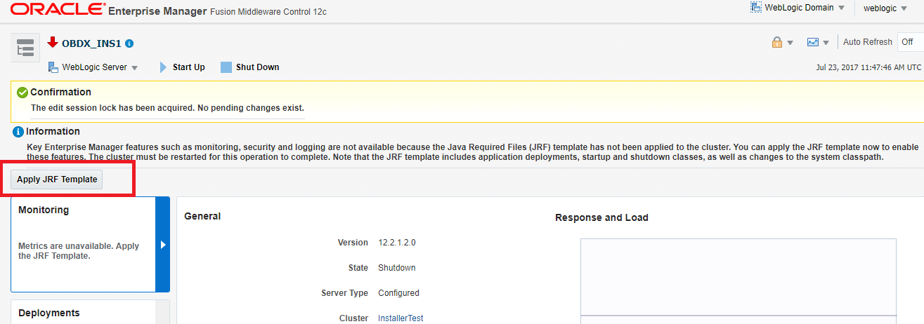

Apply JRF Template
To apply JRF template follow below steps.

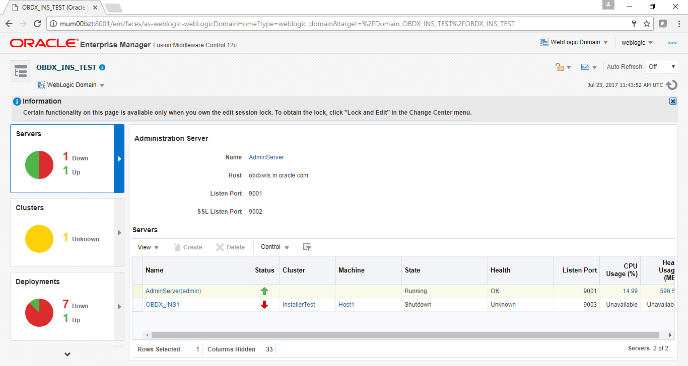

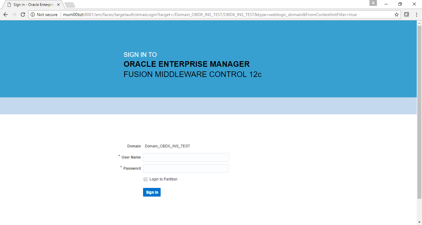

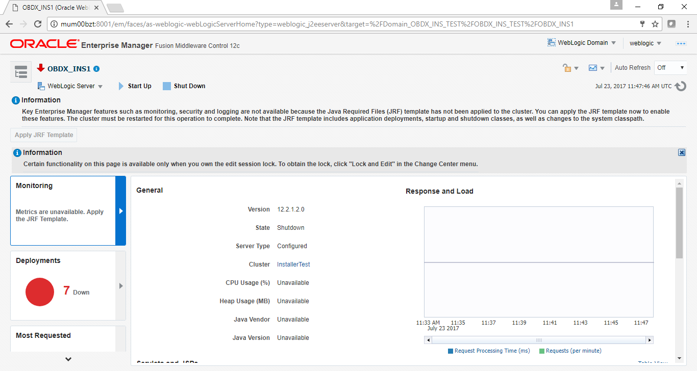

- To do this, ensure that the Admin Server is running. Login to the EM (Enterprise Manager) Console using the following URL:
http://<hostname>:<admin_port>/em
Note: EM console would be available on same hostname and port which was used for Weblogic Admin Console for OBDX domain (created via installer), just replace the “/console” with “/em”.
- Enter Weblogic administrator username and password (same used for Weblogic administrator console login)
- Click on Sign In

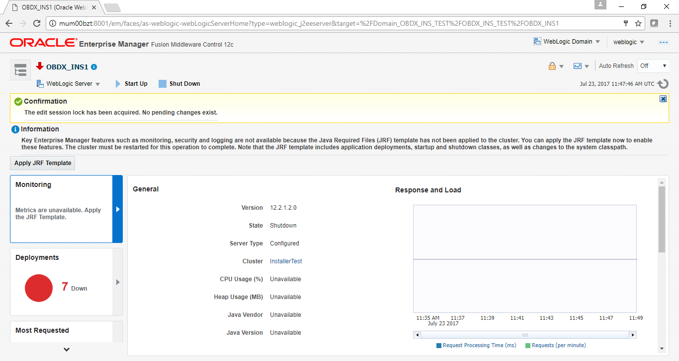

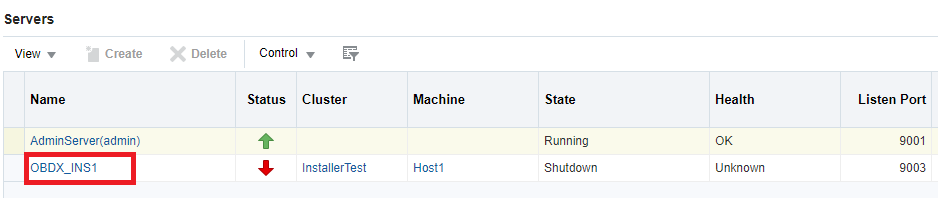

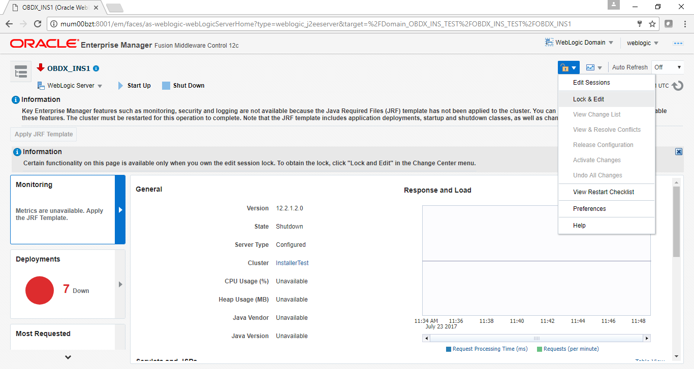

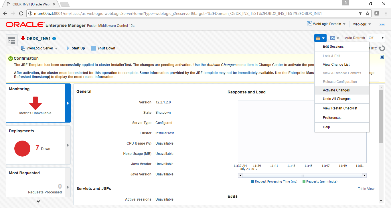

- Click on the Managed Server (as highlighted below).
Note: Depending on installer.properties, Managed server will differ from above screenshot.
- Click on “Lock and Edit” option (as shown in screenshot).
You will see below screen stating the edit session confirmation

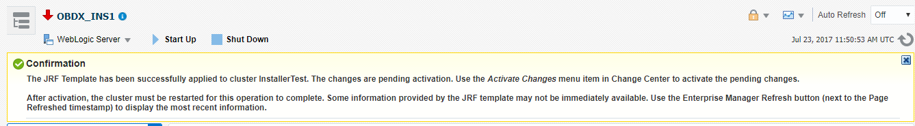

- Click on “Apply JRF Template” option (as shown in screenshot).
Is JRF successfully applied, you will get below Confirmation.
- Click on “Activates Changes” option (as shown in screenshot).
Post activation you will receive below Confirmation.

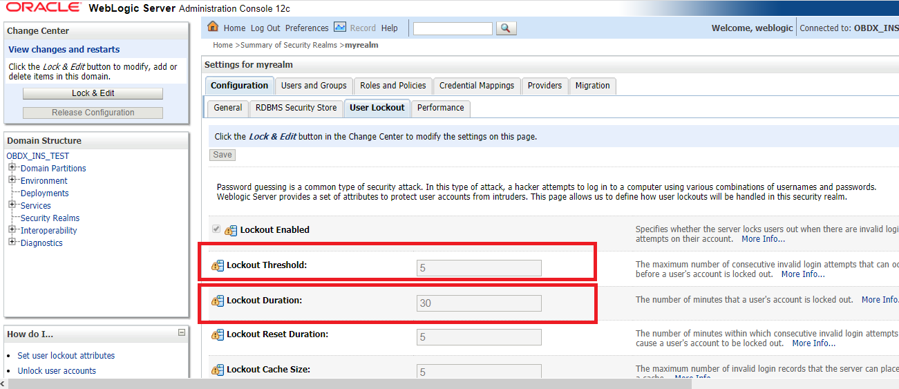

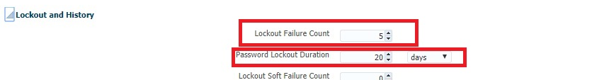

Configure User Lockout attributes in Weblogic
The User Lockout attributes in Weblogic under Home>Security Realms>myrealm need to be in sync with the Password Policy Maintained in LDAP or DBAuthenticator.In case of DBAuthenticator it has to be in sync with Password Policy Maintenance in OBDX.
Check for below values & change accordingly.
- Lockout Threshold : It should be equal to Invalid attempts of Password Policy Maintenance.
- Lockout Duration : It should be equal to property under prop_id "USER_LOCK_PERIOD" maintained in DIGX_FW_CONFIG_ALL_B table.
In case of OUD or other LDAP it needs to be sync with the Password Policy configured in LDAP. For e.g.: Refer to below values configured in OUD.
Once the values are available, make appropriate change in respective highlighted configuration.
Save and Activate Changes

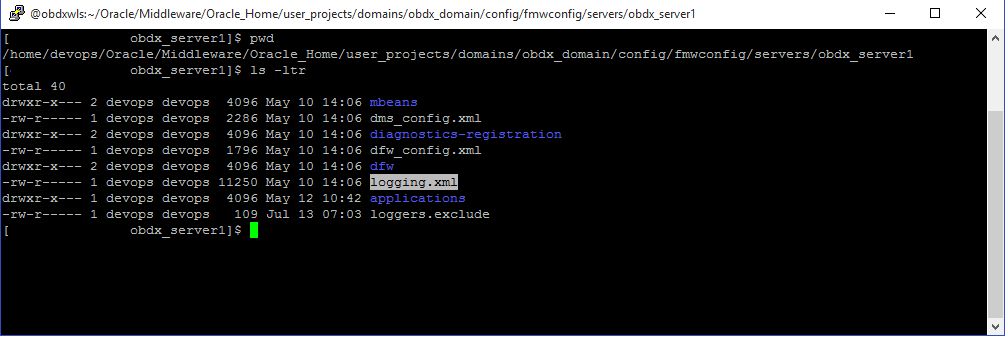

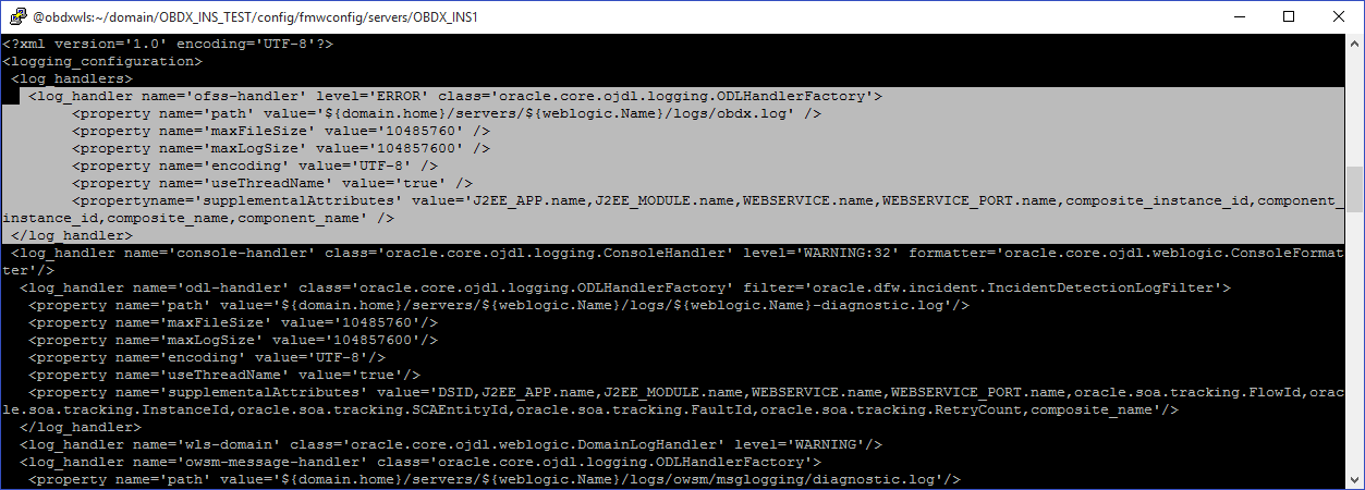

OBDX Application logging
To enable OBDX activation logging make below change to logging.xml present at ${domain.home}/config/fmwconfig/servers/${ManagedServer}.
Open logging.xml and make a new entry under <log_handlers> tag using below code template:
<log_handler name='obdx-handler' level='<LOGLEVEL>' class='oracle.core.ojdl.logging.ODLHandlerFactory'>
<property name='path' value='<path for OBDX log>/<OBDX log filename>' />
<property name='maxFileSize' value='<The maximum size in bytes for each log file>' />
<property name='maxLogSize' value='<The maximum size in bytes for the entire log>' />
<property name='encoding' value='<encoding>' />
<property name='useThreadName' value='true' />
<property name='supplementalAttributes' value=’<supplementalAttributes>' />
</log_handler>
Below is a sample implementation for log_handlers file.
<log_handler name='obdx-handler' level='ERROR' class='oracle.core.ojdl.logging.ODLHandlerFactory'>
<property name='path' value='${domain.home}/servers/${weblogic.Name}/logs/obdx.log' />
<property name='maxFileSize' value='10485760' />
<property name='maxLogSize' value='104857600' />
<property name='encoding' value='UTF-8' />
<property name='supplementalAttributes' value='J2EE_APP.name,J2EE_MODULE.name,WEBSERVICE.name,WEBSERVICE_PORT.name,composite_instance_id,component_instance_id,composite_name,component_name' />
</log_handler>

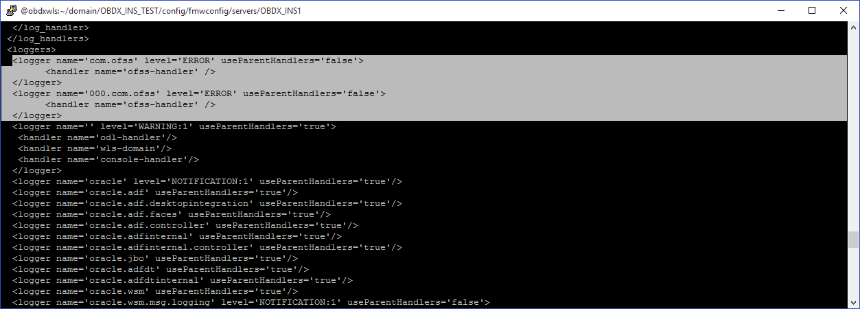

Add loggers under <loggers> tag using below template:
<logger name='com.ofss' level='ERROR' useParentHandlers='false'>
<handler name='obdx-handler' />
</logger>
<logger name='#BANKCODE#.com.ofss' level='ERROR' useParentHandlers='false'>
</logger>
Note: Replace the #BANKCODE# with bank code.
Below is a sample implementation for loggers file
</logger>
<logger name='000.com.ofss' level='ERROR' useParentHandlers='false'>
</logger>

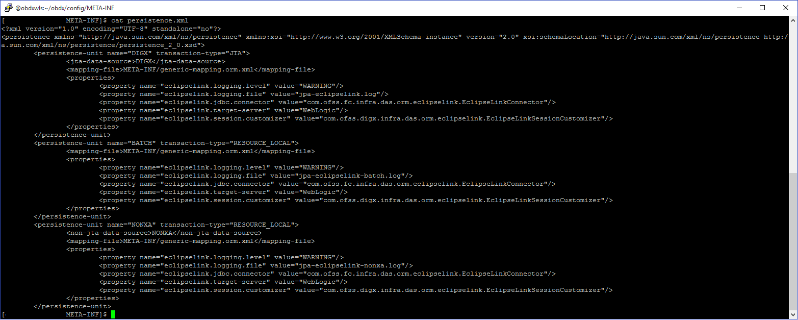

Eclipselink logging
To modify eclipselink logging make changes in <INSTALLATION_HOME>\config\META-INF\persistence.xml using below link :
https://wiki.eclipse.org/EclipseLink/Examples/JPA/Logging

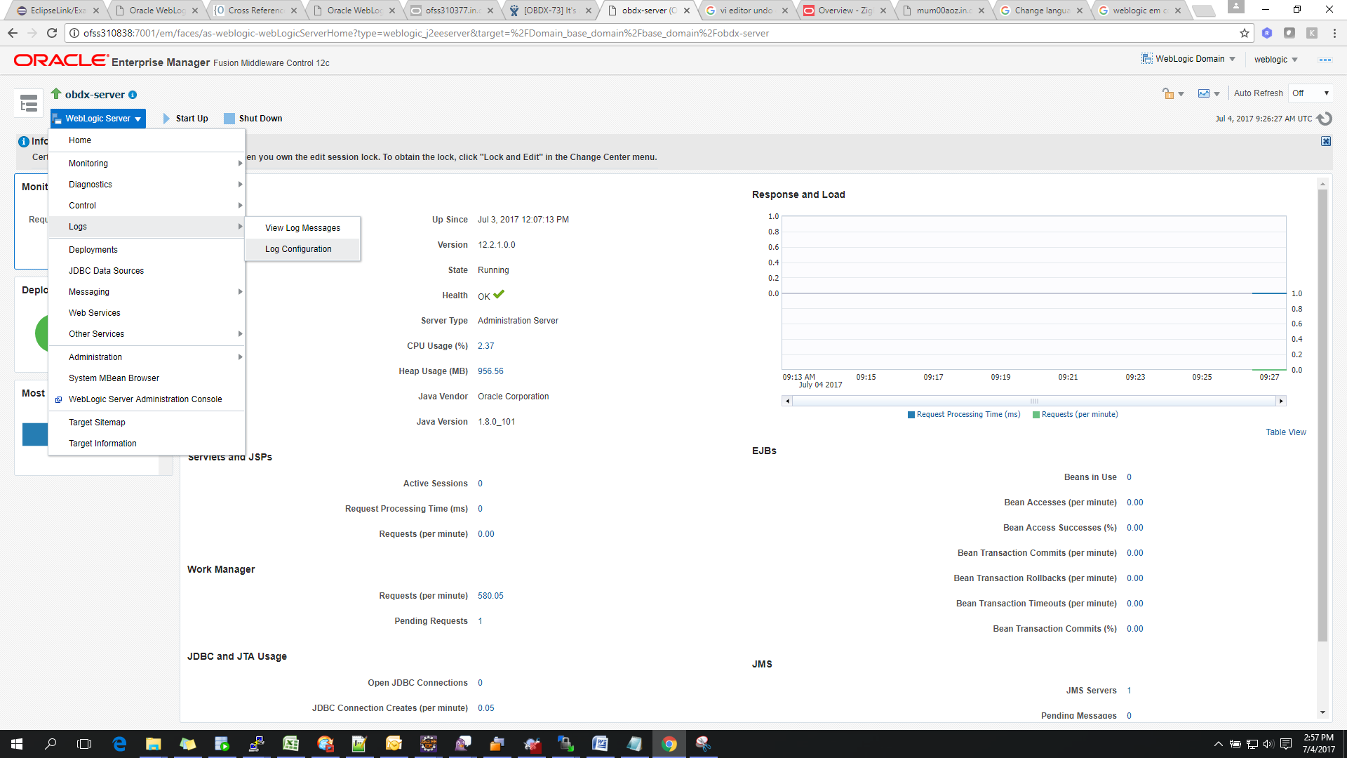

To change OBDX application logging level at runtime (when OBDX application is up and running) do following steps.

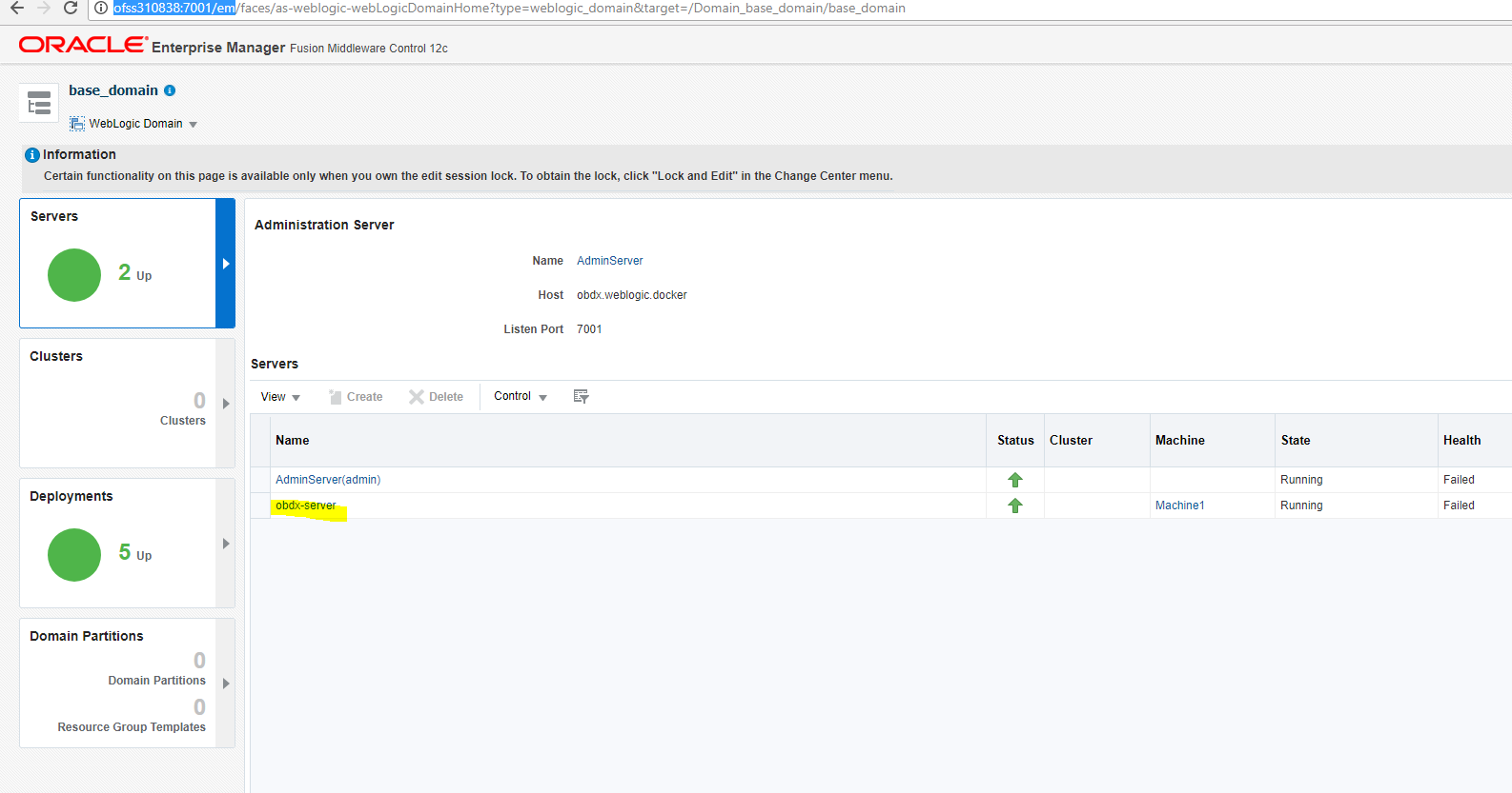

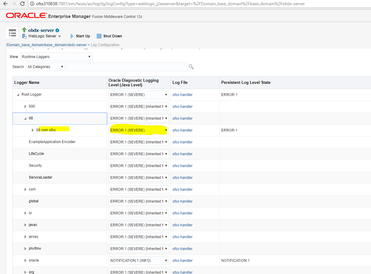

- Click on obdx-server
- In Weblogic Domain menu click on Logs -> Logs Configurations
- Select the logger and change the logging level and then click on apply.
Note: Logger name should be defined in logging.xml.

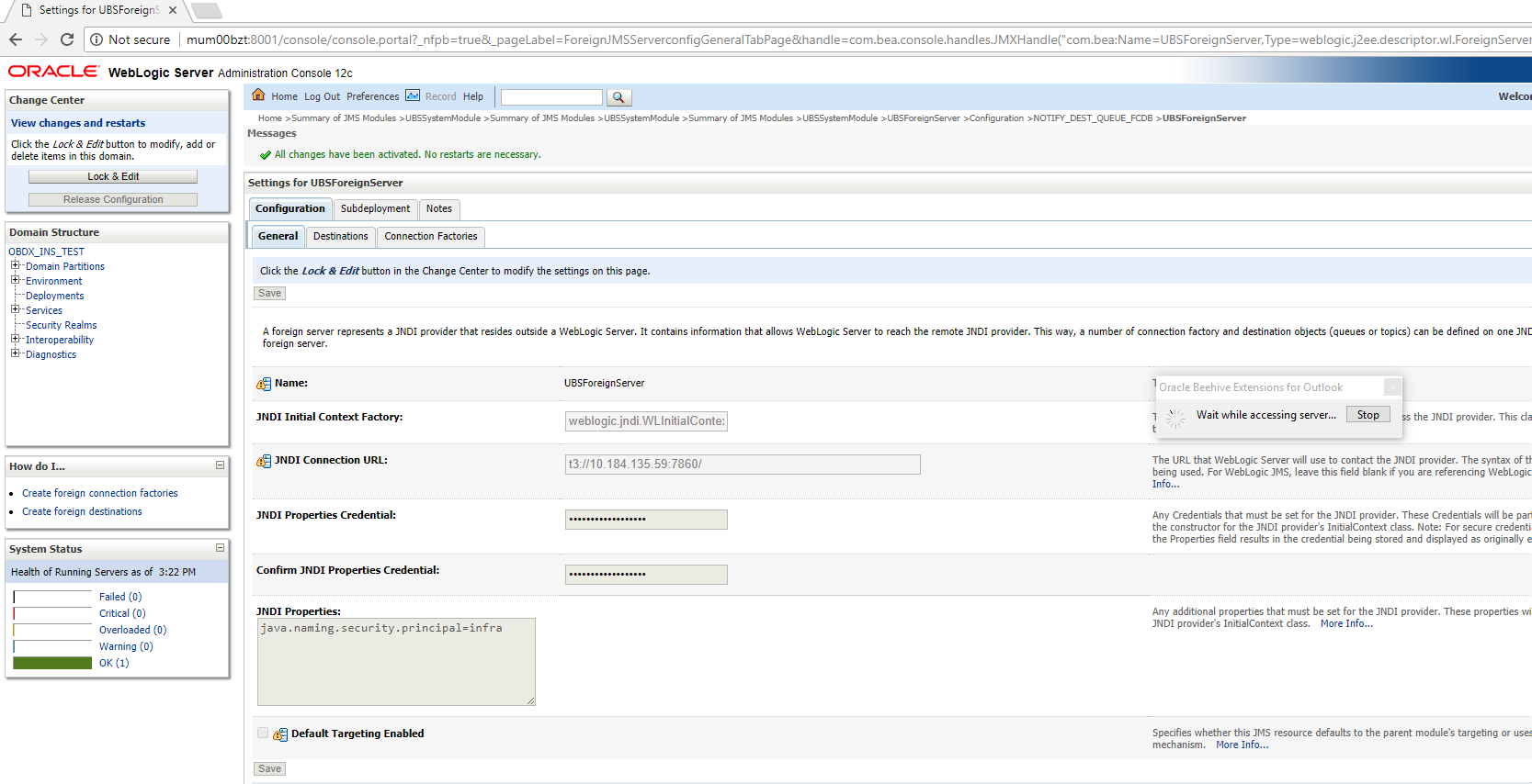

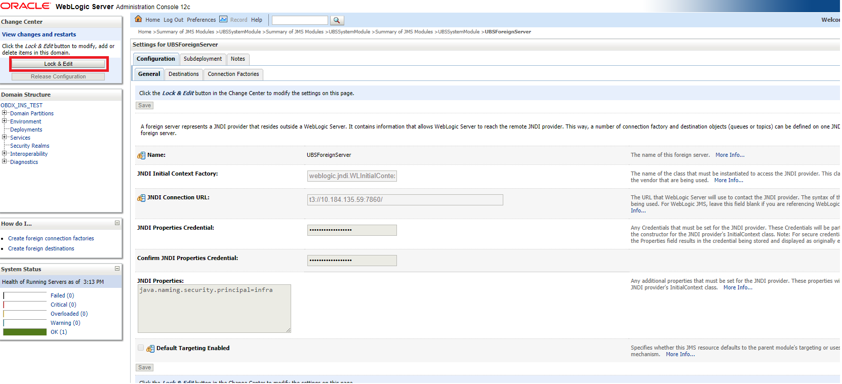

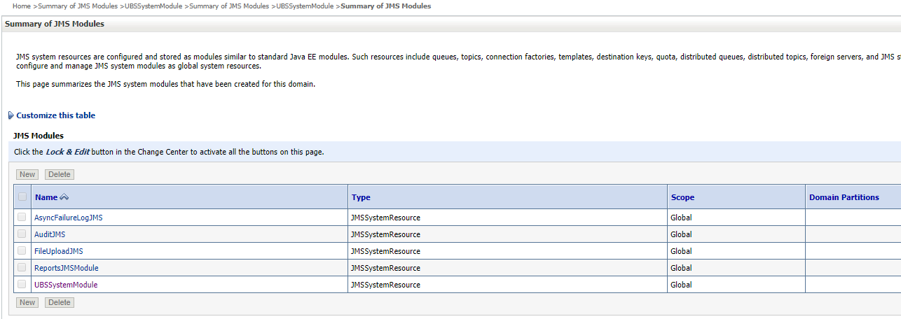

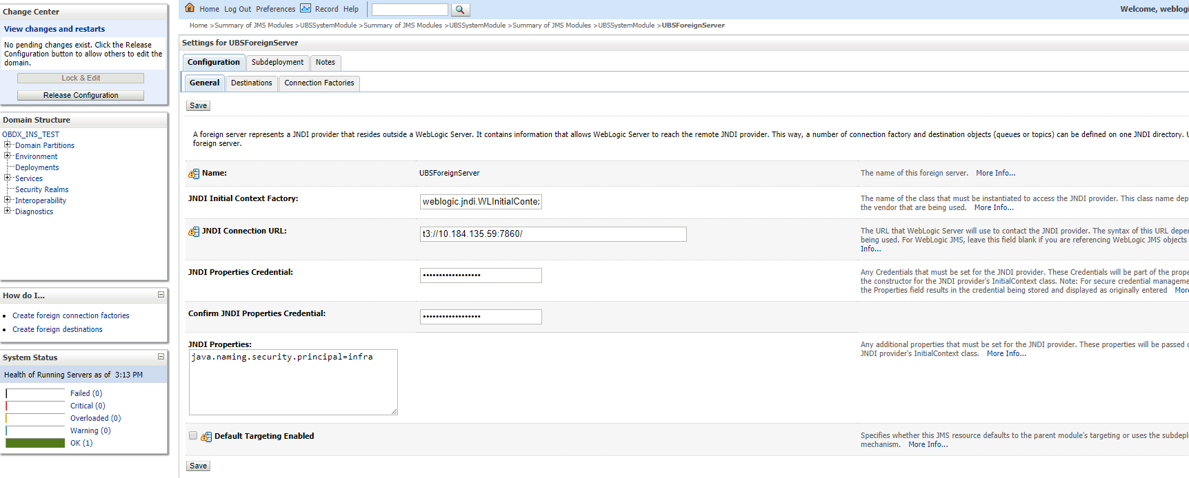

Foreign Server

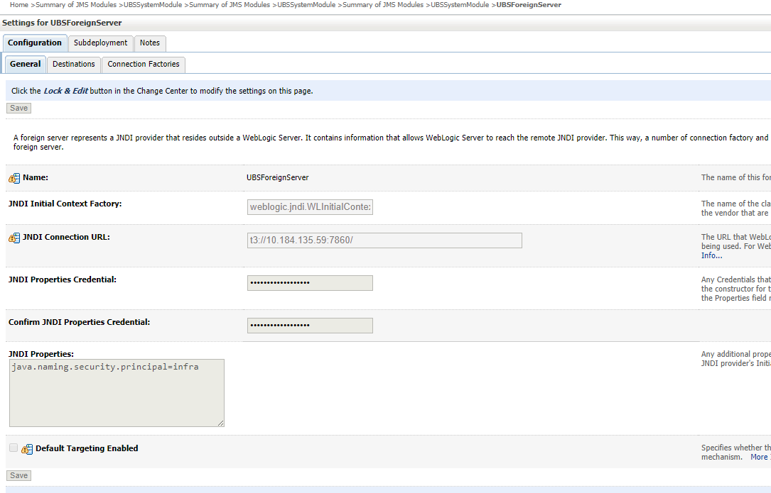

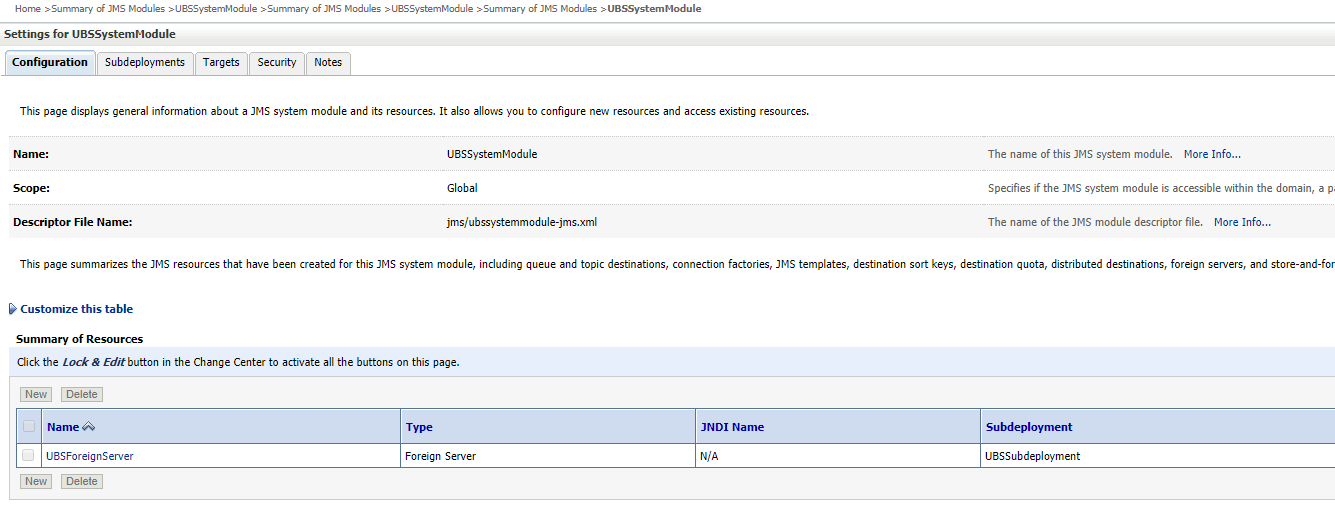

- Login into Weblogic Admin console (OBDX domain created using installer) and Browse to Summary of JMS Modules > UBSSystemModule (as shown below).

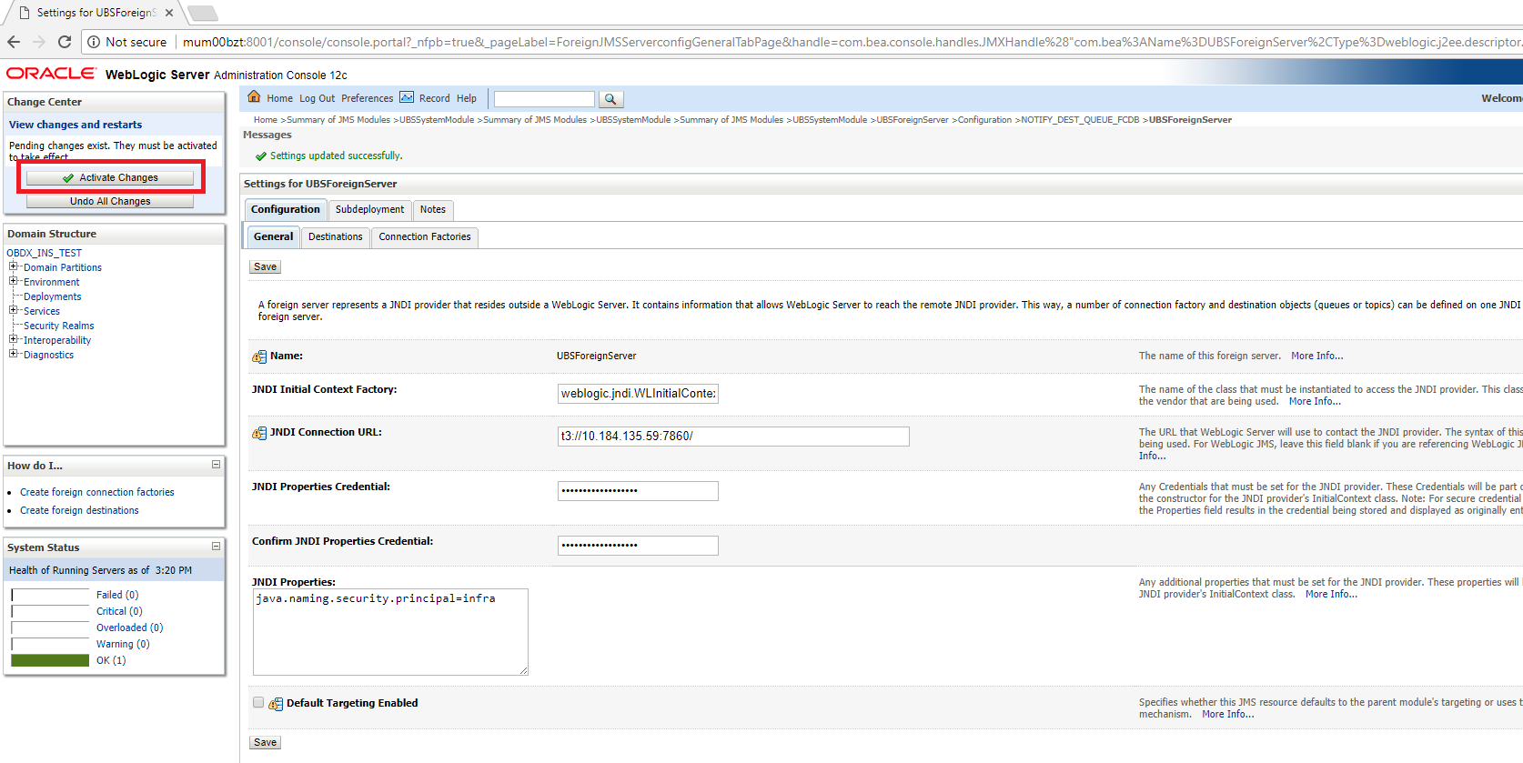

Click on UBSForeignServer
- Click on Lock & Edit.

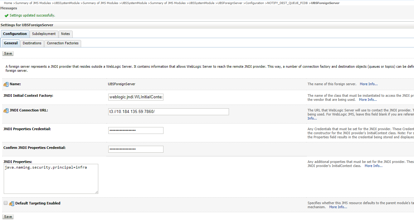

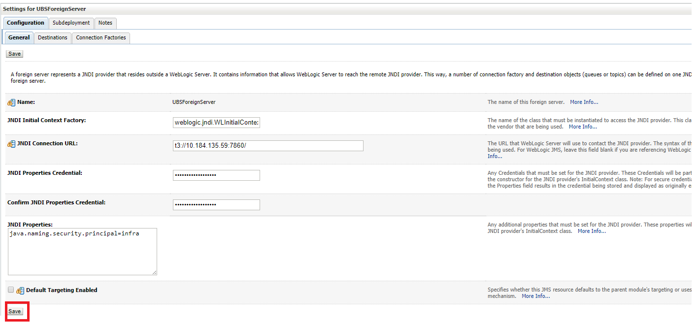

Set below configurations with:
JNDI Connection URL – UBS HOST Weblogic t3 URL for Managed server (where NOTIFY_DEST_QUEUE and NOTIFY_DEST_QUEUE_FCDB are mapped)
JNDI Properties Credential – Password for username set in JNDI properties
Confirm JNDI Properties Credential – Confirm password for username set in JNDI properties
JNDI Properties – Value to be set as “java.naming.security.principal=<username>”, where
username is the login user of UBS Weblogic Admin Console (user which created the primary local queues for UBS).
- Click on Save.
- Click on Activate Changes

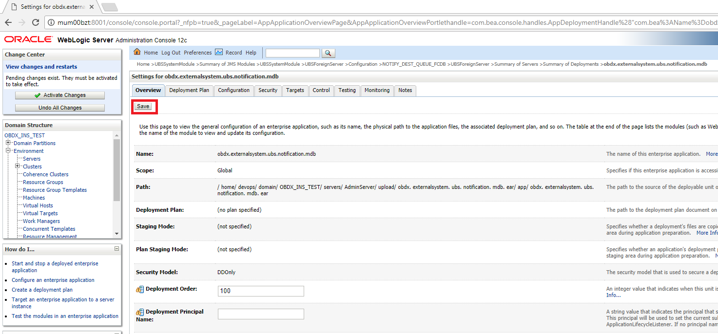

Deployment of notification MDB application

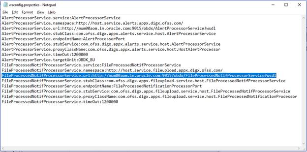

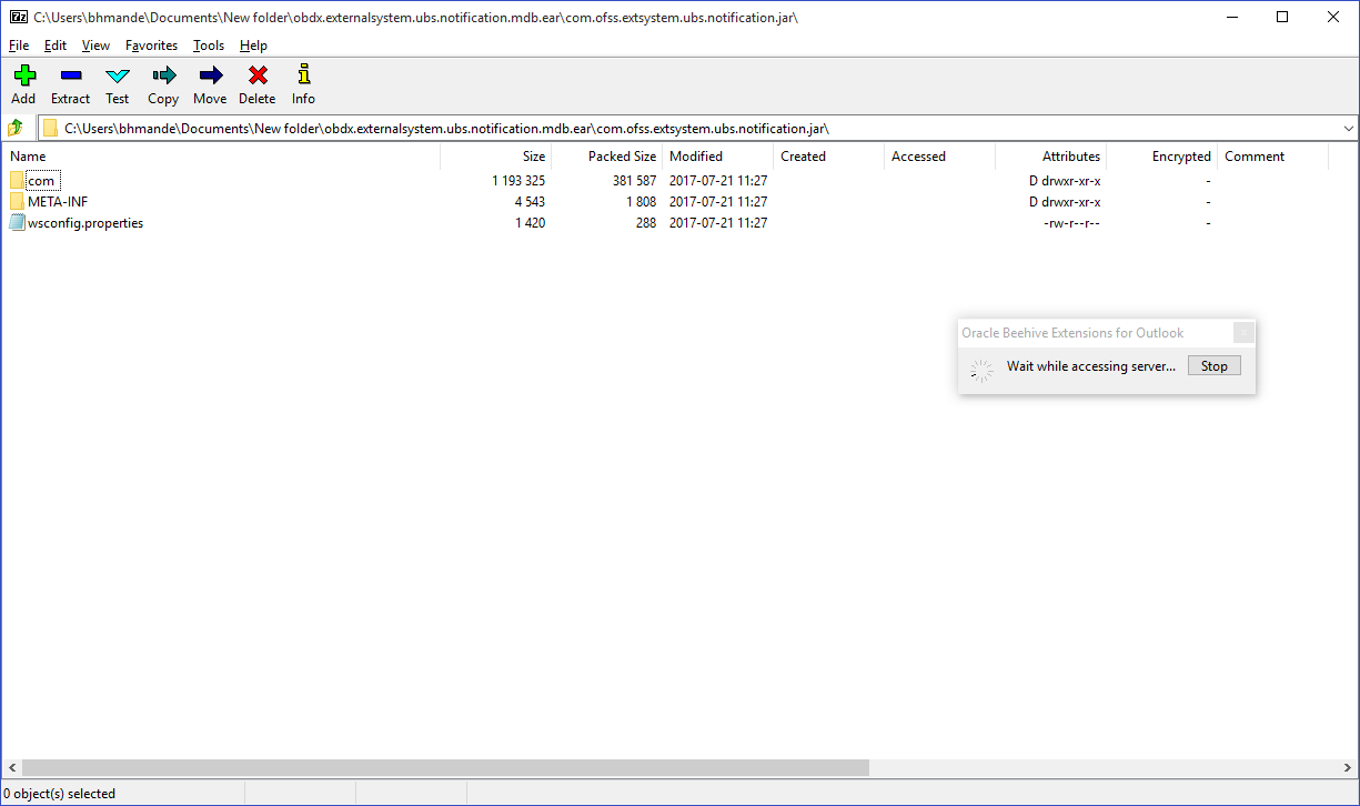

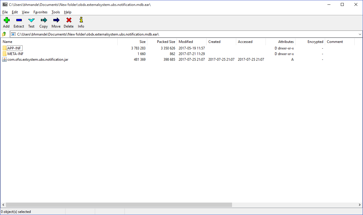

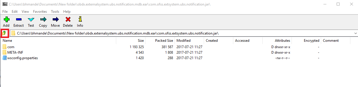

Before deployment of obdx.externalsystem.ubs.notification.mdb.ear application, kindly perform below steps:

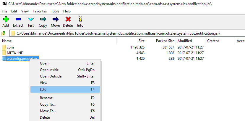

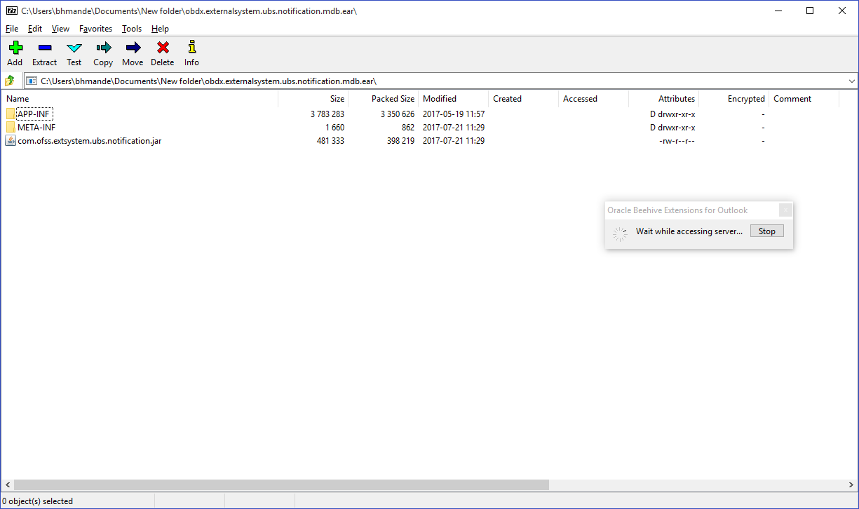

- Open the obdx.externalsystem.ubs.notification.mdb.ear (EAR file is available <OBDX INSTALLER DIR>/installables/app/components/ubs/deploy/obdx.externalsystem.ubs.notification.mdb.ear) using any archiving tools (i.e.: 7-zip)
- Double click on com.ofss.extsystem.ubs.notification.jar

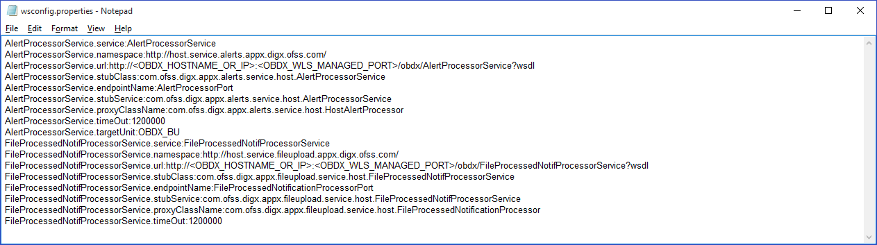

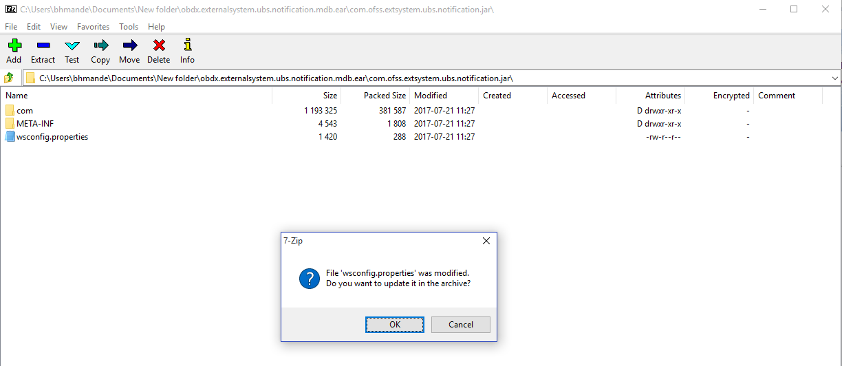

- Open the wsconfig.properties to edit.

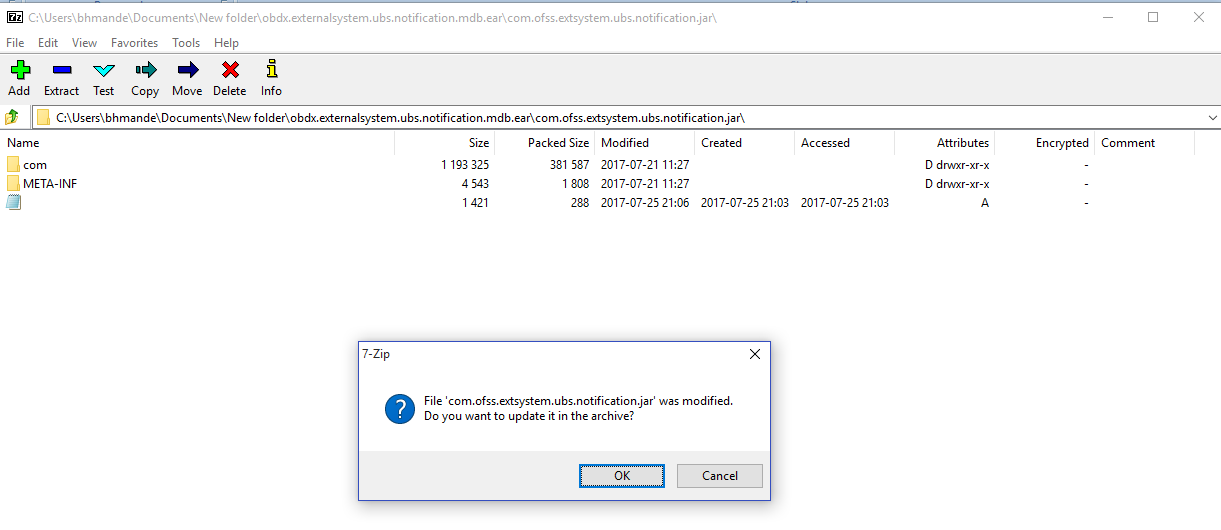

- Change the URL for AlertProcessorService.url and FileProcessedNotifProcessorService.url (Note the hostname and port should be of OBDX managed server created by installer)
- Save changes.
- Click OK.
- Navigate back to obdx.externalsystem.ubs.notification.mdb.ear
- Click OK

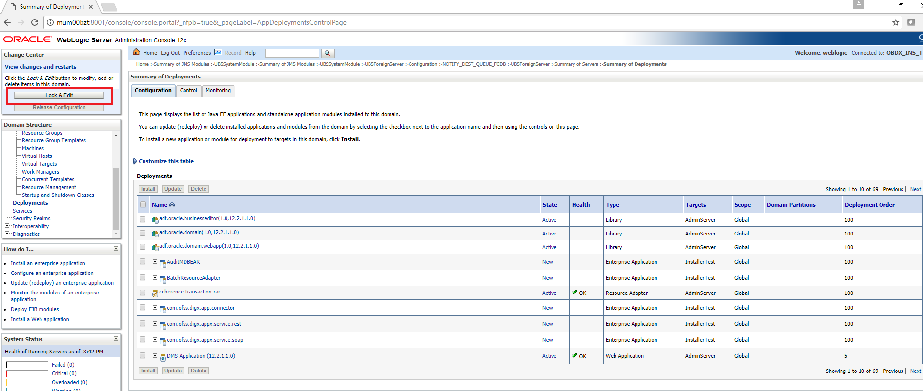

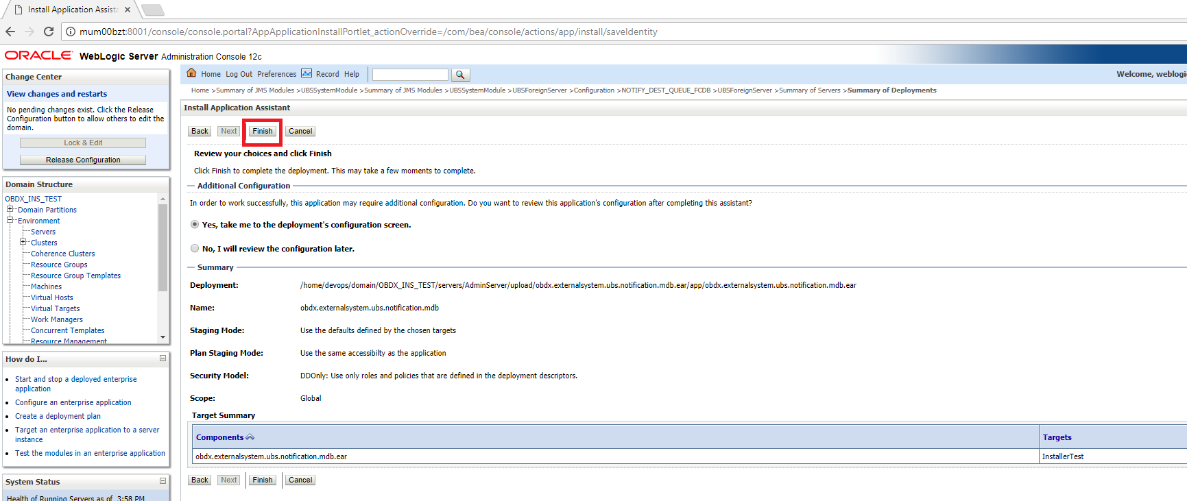

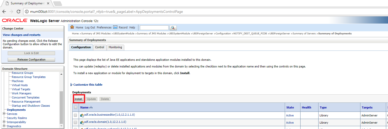

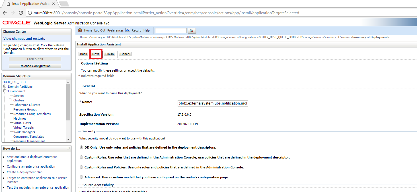

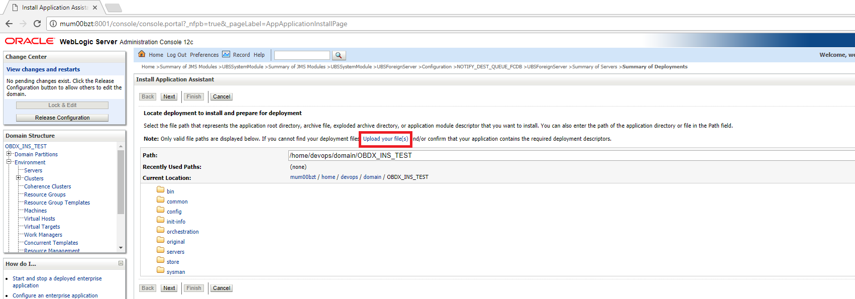

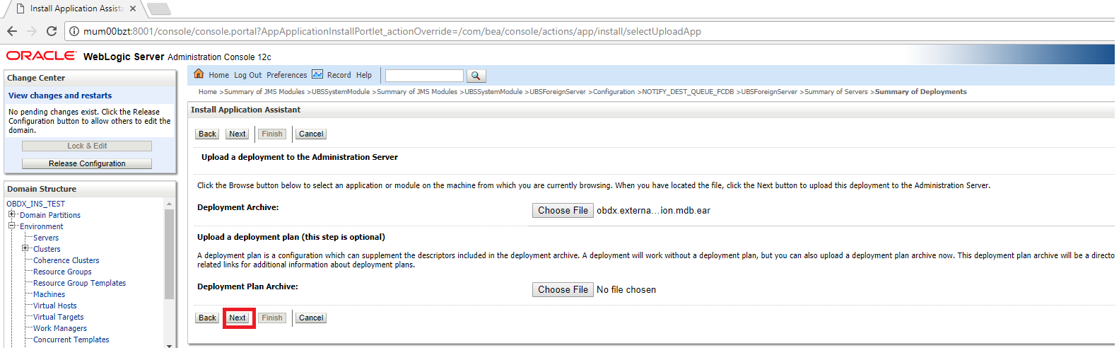

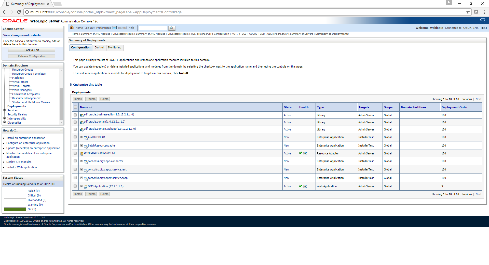

Deploy the updated obdx.externalsystem.ubs.notification.mdb.ear using below steps.

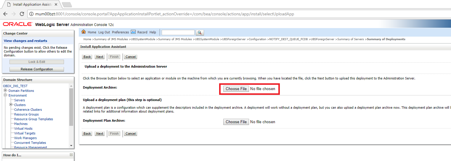

- Login into Weblogic Admin Console (OBDX domain created using installer) and navigate to Deployments.
- Click Lock & Edit
- Click on Install

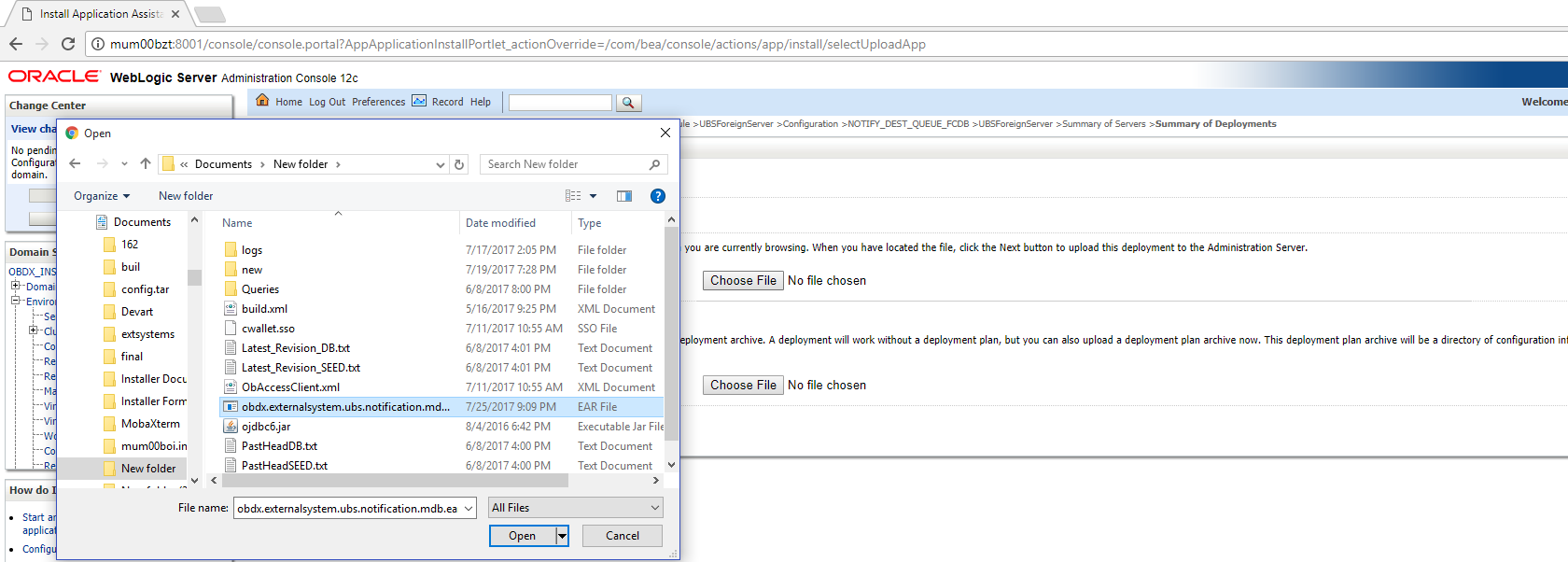

- Click on Upload your file(s)
- Click on Choose File

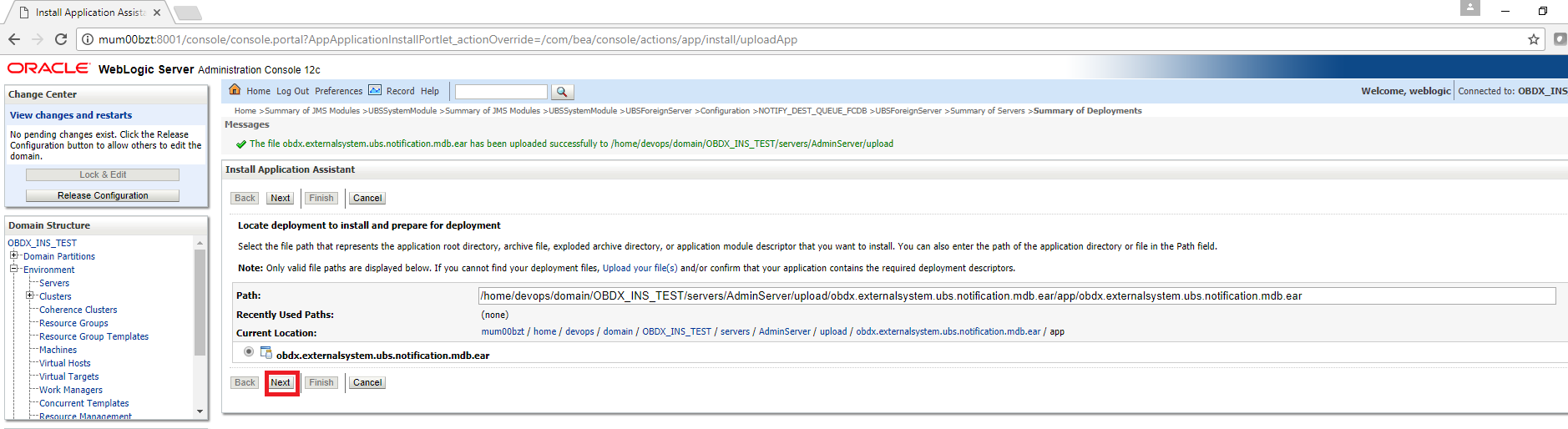

- Navigate to customized obdx.externalsystem.ubs.notification.mdb.ear and click Open
- Click Next
- Click Next

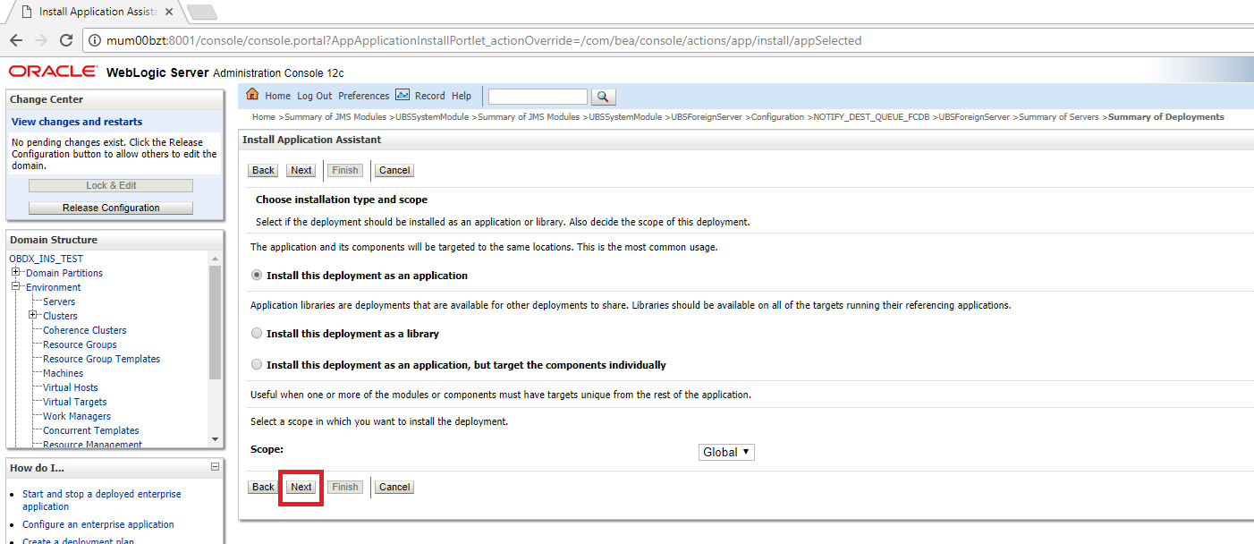

- Select “Install this deployment as an application” and click Next

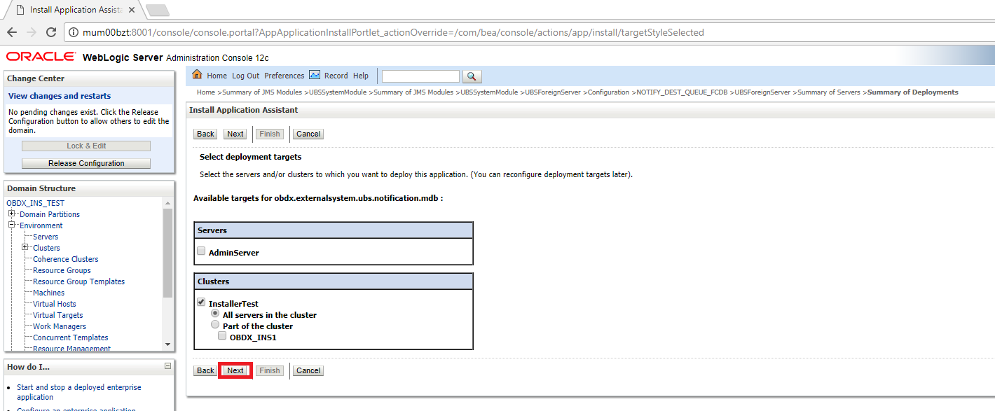

- Select Cluster as target and click Next
- Click Next

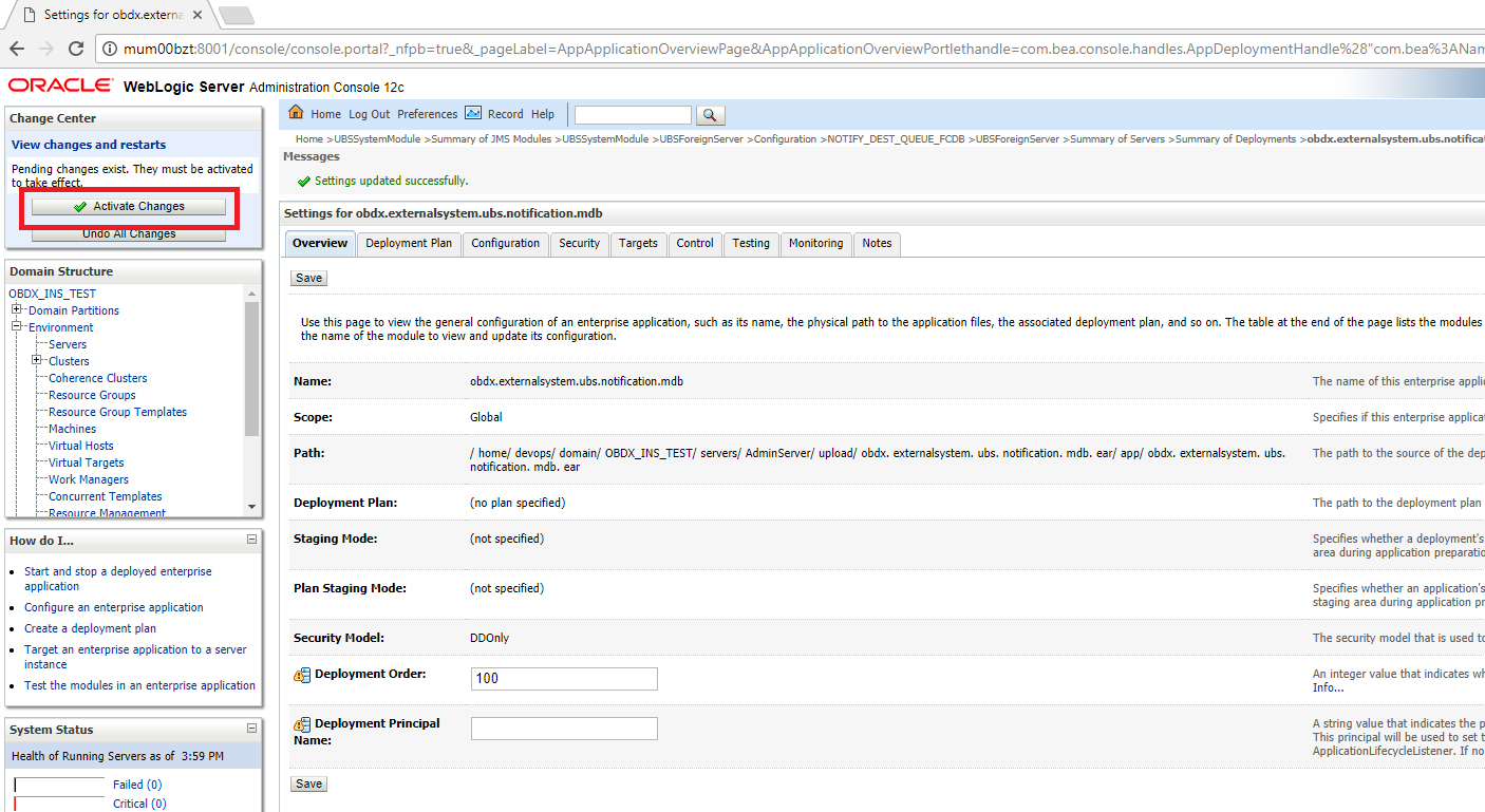

- Click Finish.

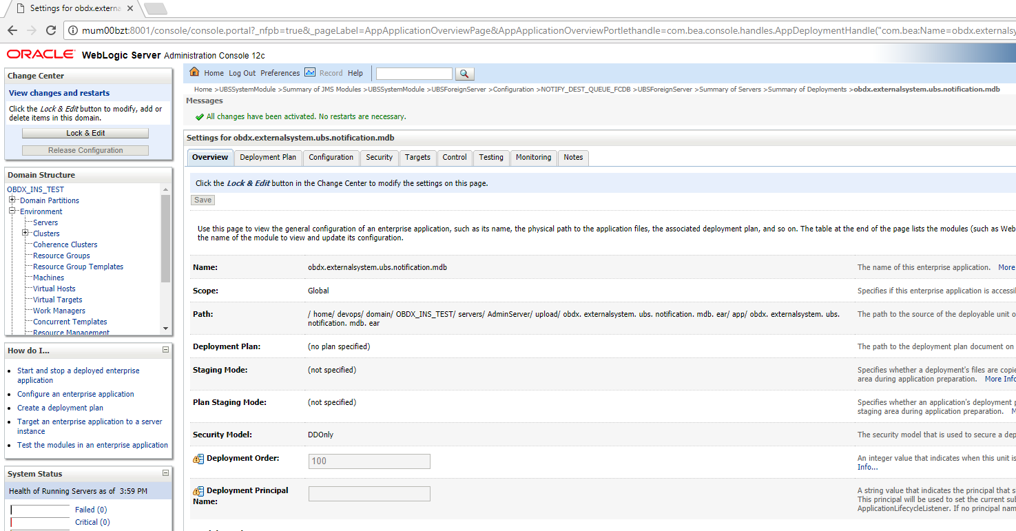

- Click Save.
- Click Activate Changes
