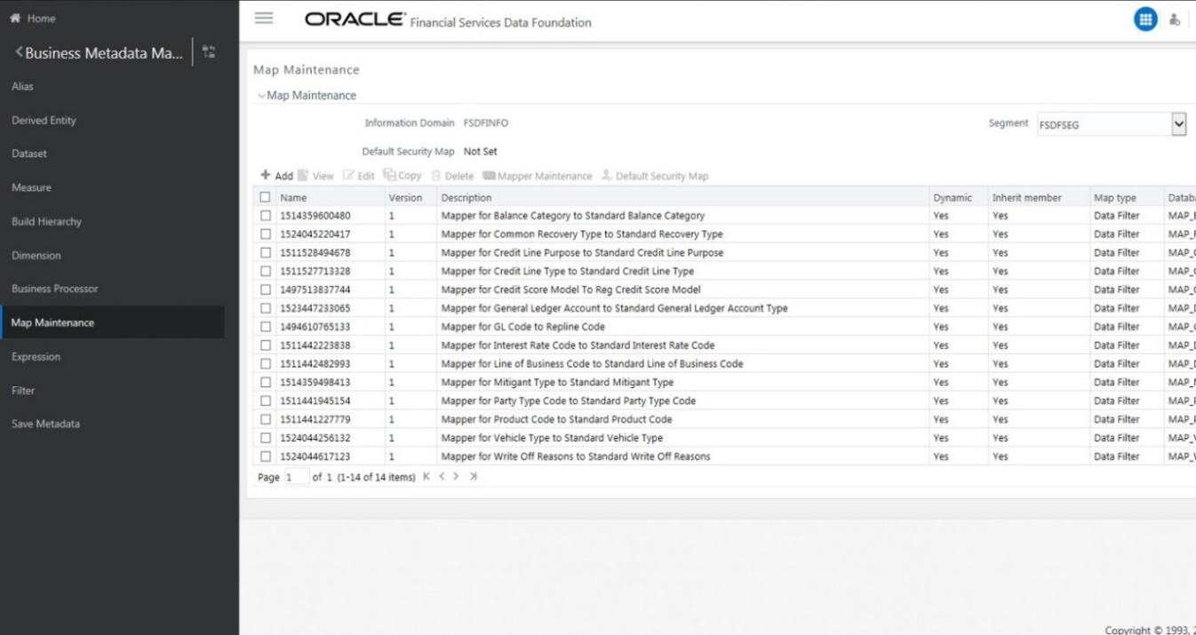

1.     Go to OFSAAI > Financial Services Data Foundation > Unified Analytical Metadata > Business Metadata Management > Map Maintenance. The Map Maintenance page appears.

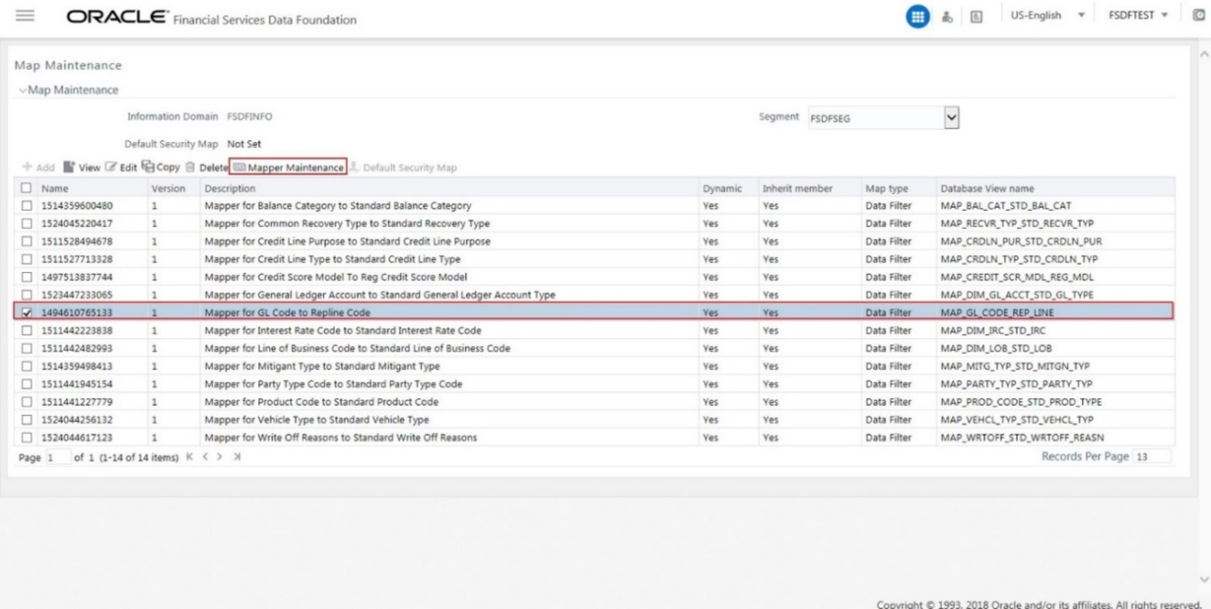

2.     Select the mapper record Mapper for GL Code to Repline Code and then click the Mapper Maintenance icon.

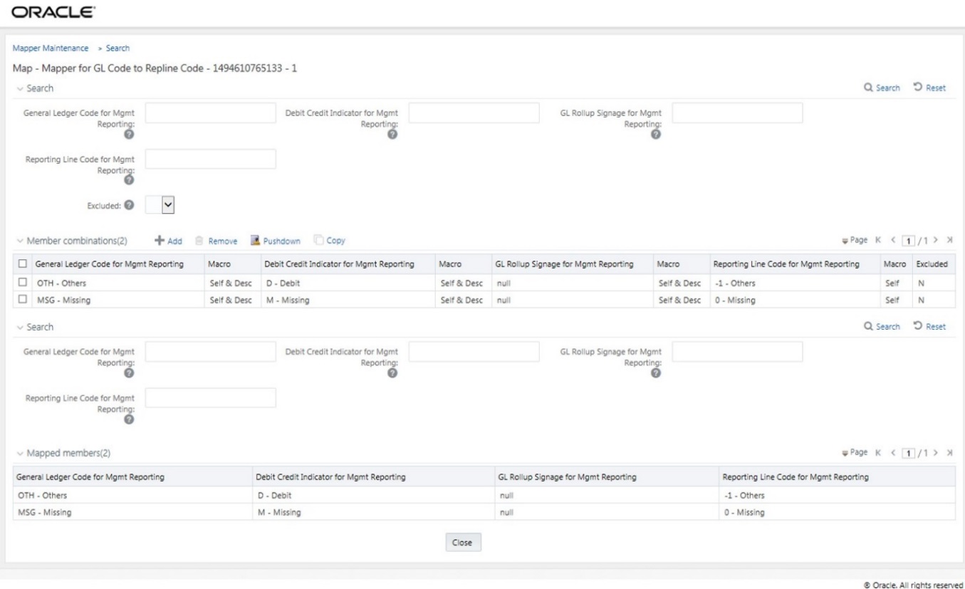

3.     The Mapper Maintenance page appears. The GL Codes OTH and MSG are out-of-the-box mappings. You can maintain the remaining mappings according to the user specific values.
