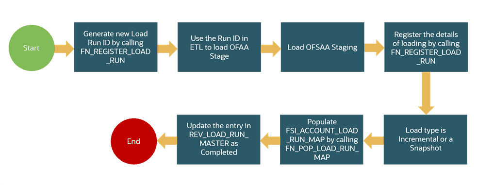

Implementation
Before loading data into the staging table, generate a Load Run Identifier to stamp the records from the source. These records can be a complete snapshot or can be partial or incremental data too. This load run identifier can be generated by calling the function in the OFSAA atomic schema named fn_register_load_run. The function expects some input parameters and returns a unique load run identifier back to the calling program.
Figure 57: Generate the Load Run Identifier
Title: Description of generating the Load Run Identifier illustration as follows: - Description: This illustration shows generating the Load Run Identifier. The explanation precedes this illustration.
NOTE
Column n_load_run_id should always be populated only by the value returned by fn_register_load_run.
Function - Register Load Run (fn_register_load_run)
Parameters - Batch ID, MIS-Date, Load Run Name, Load Run Purpose, Load Run Type
Table 28: Parameters of FN_REGISTER_LOAD_RUN

Loading OFSAA Staging Tables
After the load run ID is generated as described above, you can use the same in external ETL process to stamp the records from the source system before them loading either in one or the multiple staging tables of OFSAA Staging area.

This function populates a table named rev_load_run_details. The columns load type can have only 2 values, such as:
·        "S - Complete/Full Snapshot
·        "I - Incremental Snapshot
Table 39: Population of the REV_LOAD_RUN_DETAILS table
LOAD_RUN_ID
MIS_DATE
STAGE_TABLE_NAME
LOAD_TYPE
1
1-Jan-15
STG_LOAN_CONTRACTS
I
Updating Load as Completed
Once you complete these steps, update the status of the record inside rev_load_run_master as Completed.
UPDATE rev_load_run_master
SET LOAD_RUN_STATUS = 'Completed' WHERE pMis_Date = '01-Jan-15' AND pLoad_Run_Name = 'FSDF_LOAD' and LOAD_RUN_ID = 1 ;
