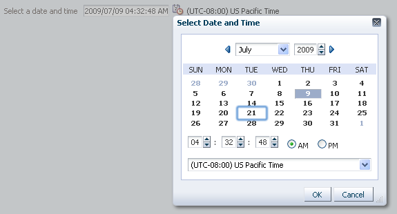

inputDate screenshot 4
Date and time selector popup which is shown when user clicks glyph to select a date and time.
