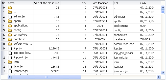

Screen Shot(s)
table screenshot
Table component.

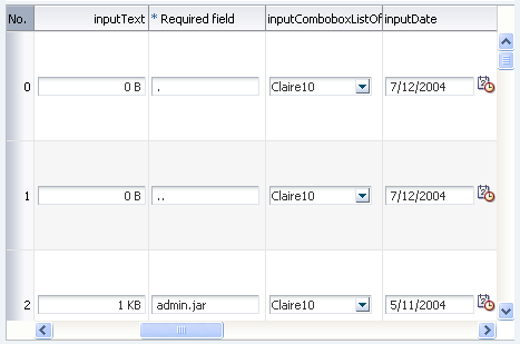

table editall screenshot
Table component with editingMode attribute set to "editAll".
