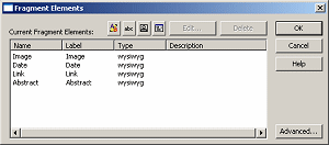

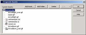

The following are some tasks you'll perform in the Fragment Editor:
Section 13.12.3, "Changing the Icon Associated with a Fragment"
Section 13.12.4, "Adding, Editing, and Deleting Fragment Snippets"
Section 13.12.5, "Adding, Editing, and Deleting Fragment Assets"
Section 13.12.6, "Adding, Editing, and Deleting Fragment Parameters"
Section 13.12.7, "Adding, Editing, and Deleting Fragment Elements"

You can add, edit, and remove fragment assets in the Fragment Assets dialog in the Fragment Editor.
To add an asset, perform these tasks:
With the fragment open in the Fragment Editor, click Assets.
This opens the Fragment Assets dialog (see Section A.59, "Fragment Assets Dialog").
To create a subfolder for the asset (this is optional), click Add Folder, type a name for the folder, and then press Enter on your keyboard.
By default, Oracle Site Studio creates an asset folder based on the fragment's ID (see Section 13.12.2, "Specifying Fragment Properties"). The folder name uses all lowercase letters to ensure that the fragment works on all platforms (specifically, UNIX). If you create any subfolders, you should use all lowercase letters as well. In addition, you should use only ASCII characters (see note below).
Highlight the folder that you would like to add the asset to and then click Add Asset (the root, or top-level folder, is the default location for assets).
Browse to the file on your file system and then click Open in the Windows dialog.
Click OK to close the Fragment Assets dialog and return to the Fragment Editor.
When you save your fragment, the asset is packaged with the fragment and stored in the fragment library on the content server. You can now refer to the asset from each snippet in the fragment.
To edit an asset, perform these tasks:
In the Fragment Assets dialog, select the asset and then click Edit to open the two edit options.
Click Edit to open the asset in the default application associated with that file type (for example, a cascading style sheet may open in Notepad).
Click Edit with to open the Edit With dialog where you can use a different application to edit the file.
Make your changes to the asset and then close the application used to edit the asset.
To delete an asset, perform these tasks:
In the Fragment Assets dialog, select the asset and then click Delete.
Only ASCII characters should be used for fragment IDs and the names of asset files and folders. This is because the folder within the zip file, which is created automatically for the assets, is named after the fragment ID, and the zip format does not support extended characters. This is true also for the names of any folders used for the assets and for the names of the asset files themselves.

To add an element to a fragment, perform these tasks:
With the fragment open in the Fragment Editor, click Elements.
This opens the Fragments Elements dialog (see Section A.60, "Fragment Elements Dialog").
Click the type of element to add to the fragment: WYSIWYG, plain text, image, or custom.
In the Element dialog, follow the same steps as if you were adding the element to a contribution region.
Click OK to close the Element dialog and then OK again to close the Fragment Elements dialog.
To edit an element in a fragment, perform these tasks:
In the Fragment Elements dialog (see Section A.60, "Fragment Elements Dialog"), select the desired element and then click Edit.
In the Element dialog, follow the same steps as if you were editing an element in a contribution region.
To delete an element in a fragment, perform these tasks:
In the Fragments Element dialog (see Section A.60, "Fragment Elements Dialog"), select the desired element and then click Delete.
Click OK to close the Fragment Elements dialog.
The Elements button only displays in the Fragment Editor when the fragment is of the type "staticlist" (see Section 13.12.2, "Specifying Fragment Properties").
The Fragment Elements dialog contains an Advanced button. This opens a text editor that you can use to customize your element even more. However, when you start editing an element this way, you cannot return to the Fragment Elements dialog graphical user interface because there is no interface support for these edits.
