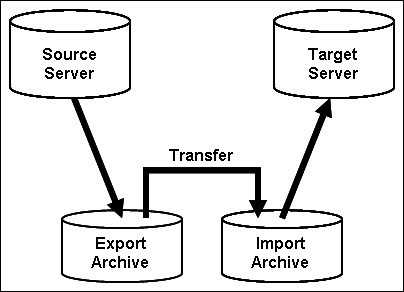

B.1.1 The Replication Process
The replication process in Oracle Site Studio includes a source server, a target server, an export archive, an import archive, and the transfer.
Figure B-1The Stages Involved in Replication
Description of Figure B-1 follows
Description of "Figure B-1The Stages Involved in Replication"
  • Export: Native files, web-viewable files, content types, and user attributes are copied out of the source content server into an export archive.
  • Import: Files and content server information are copied from an import archive to the target content server.
  • Transfer: Content is transferred from one content server to another. This function can be used to copy content across a firewall or between two servers that do not have access to the same file system. You can also transfer archives between two content servers that have access to the same file system.
  • Replicate: Automates the export, import, and transfer steps. You can use replication to automatically export from one content server, transfer the archive to another computer, and then import to another content server.

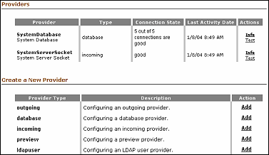

  1. Log on to the source content server as an administrator. On the main menu, select Administration and then Providers.
    Figure B-2Provider Page in Oracle Content Server User Interface
    Provider Page in Content Server user interface
  2. Under Create a New Provider, click Add beside the outgoing provider type.
    This opens the Add Outgoing Provider page.

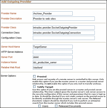

    Figure B-3Add Outgoing Provider Page
  3. For Provider Name, enter a name to identify the provider (see illustration above). The name appears in the Providers list on this page (after you add one), and it becomes a subdirectory in the [CS-Dir]/data/providers/ on the source server.
  4. For Provider Description, enter a friendly description for the provider (see illustration above).
  5. For Provider Class, enter intradoc.provider.SocketOutgoingProvider (the name of the Java class for outgoing providers).
  6. For Connection Class, enter intradoc.provider.SocketOutgoingConnection (the name of the Java class that implements provider connections).
  7. You can leave Configuration Class empty (this identifies a Java class for additional configuration settings, useful for database providers).
  8. For Server Host Name, enter the name (typically, the system name or IP address) of the target server.
    A socket connection is made to this host.
  9. You can leave HTTP Server Address empty (this is the HTTP address of the target server, which is not necessary for this type of connection).
  10. For Server Port, enter the port (typically, 4444) used to communicate with the target server.
    You can determine the port by viewing the server output when starting the content server.
  11. For Instance Name, enter the name (IDC_Name) of the target content server.
  12. For Relative Web Root, enter the relative web root for the target content server (for example, /stellent/).
    You can skip the remaining options as they are not required for this type of connection.
  13. Press Add to save the provider information and return to the Providers page. (Your outgoing provider is in the Providers list.)

To test the provider and make sure it was properly set up, return to the Providers page and click Test beside the outgoing provider.
