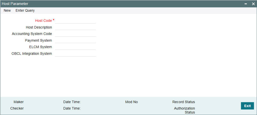

2.1.1 Configuring Accounting System for Host Code
You can configure the accounting system using host code in the ‘Host
Parameter’ screen.
To invoke this screen, type ‘PIDHSTMT’ in the field at the top right corner
of the application toolbar and click the adjoining arrow button.
Specify the following
details
Host Code
Specify the host code.
Host Description
Specify the brief description for the host.
Accounting System Code
Specify the accounting system code.
Payment System
Specify the payment system.
ELCM System
Specify the ELCM system.
OBCL Integration System
Specify the external system. For example, OLINTSYS

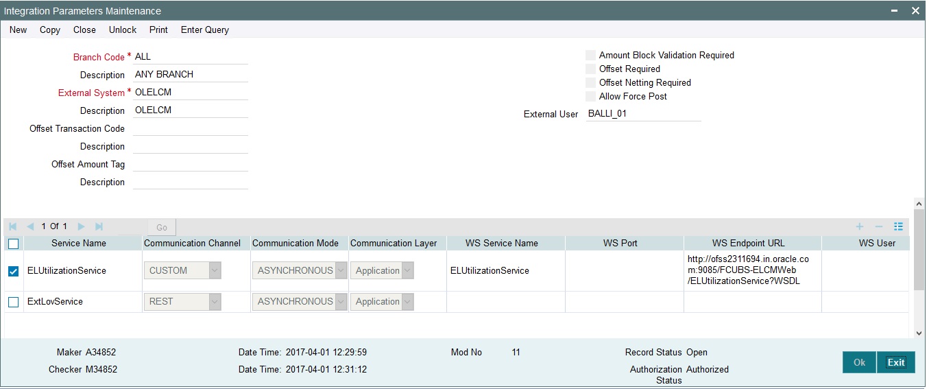

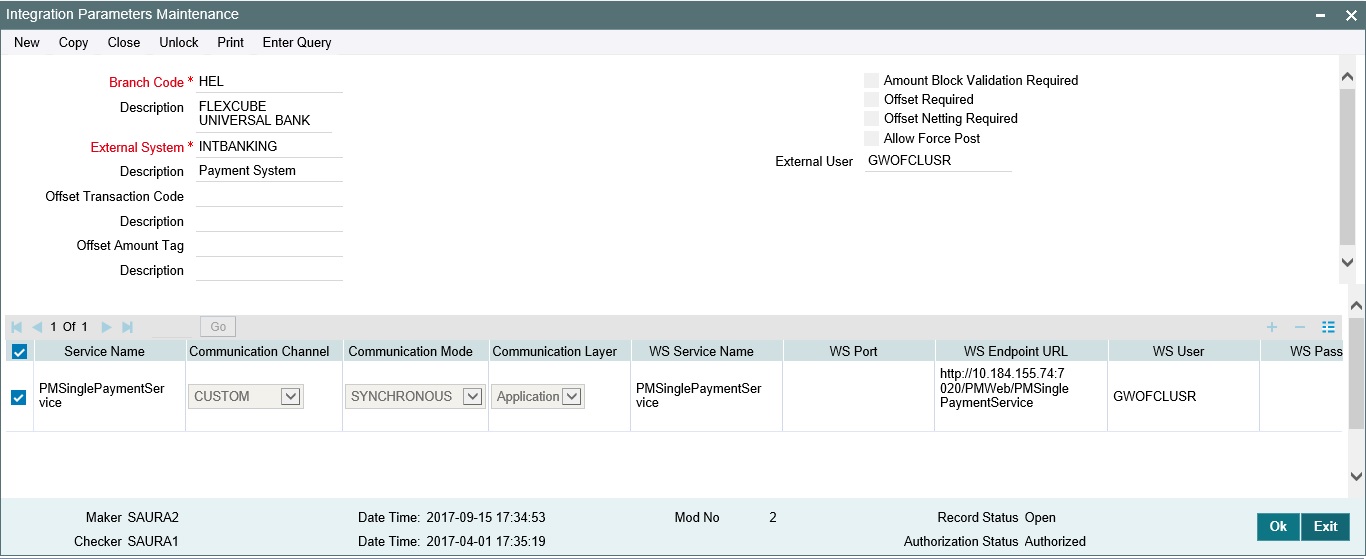

Example of Integration Parameter Maintenance screen for Payments
Example
of Integration Parameter Maintenance screen for ELCM
Parameter Maintenance screen for OBCL
You need to maintain
the integration parameters for the following:
- External Lov – ExtLovService
- ELCM Utilization/Payments/OBCL – ELUtilizationService/PMSinglePaymentService/FCUBSCAService
External Lov
- External System - External system name is specified here. For example,
OLELCM, INTBANKING for Payments, and OLINTSYS for OBCL.
- Service Name – The service name for which the maintenance is
done. For example, ELUtilizationService for ELCM, ExtLovService for External
LovExtLovService, and PMSinglePaymentService for Payments, and FCUBSCAService
for OBCL.
- Communication Channel – The communication channel like REST,
CUSTOM, WEB SERVICE, and so on are specified here.
- Communication Mode – The communication mode can be SYNC/ASYNC.
Note
Rest Service need not be maintained for OBCL.
- Rest Service IP – You have to maintain the IP address. For
example, ELCM IP, Payment IP.
- Rest Service Port – You have to maintain port details. For
example, ELCM Port, Payment Port.
- Rest Service Pattern - You have to maintain rest service pattern.
For example, LovService
- Rest Service Context – You have to maintain rest service context.
For example, FCJNeoWeb
- External User - ELCM/Payment/OBCL user should have access to all
branches and autoauth
ELCM Utilization/Payment/OBCL
OLELCM.
LovExtLovService and PMSinglePaymentService for Payments.
- WS Service Name – The service name needs to be maintained here.
For example, ELUtilizationService, PMSinglePaymentService, and FCUBSCAService.
- WS Endpoint URL – The WSDL of the services are maintained here.
For example, ELCM utilization/Payment/CA service WSDL link
- WS User – ELCM/Payment user should have access to all branches
and autoauth.
branches and autoauth.

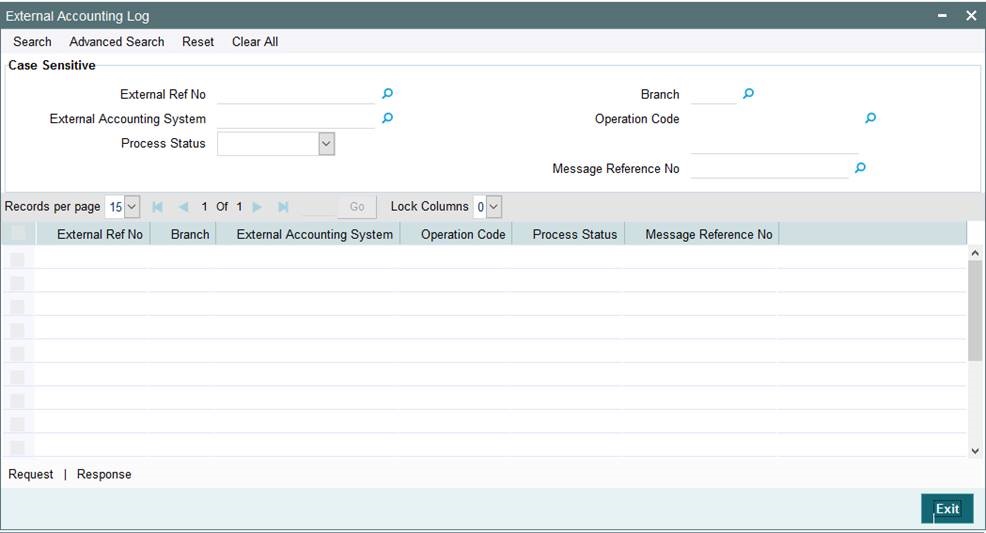

2.3.2 Viewing External Accounting Log
'External Accounting Log' screen contains OL transaction details with
External Accounting System linkage.
To invoke this screen, type ‘OLSEACLG’ in the field at the top right corner
In this screen, you can view the request sent from OL module and view
the response (received for the request sent) from the External Accounting
System.
You can search records
based on the following parameters:
- External Reference Number
- Branch
- External Accounting System
- Operation Code
- Process Status
- Message Reference Number
Click ‘Search’ button with or without entering any of
the above search parameters. All records matching the search criteria
are displayed. To view a particular record double-click on the desired
record displayed in the list of records. The details pertaining to each
record is displayed.

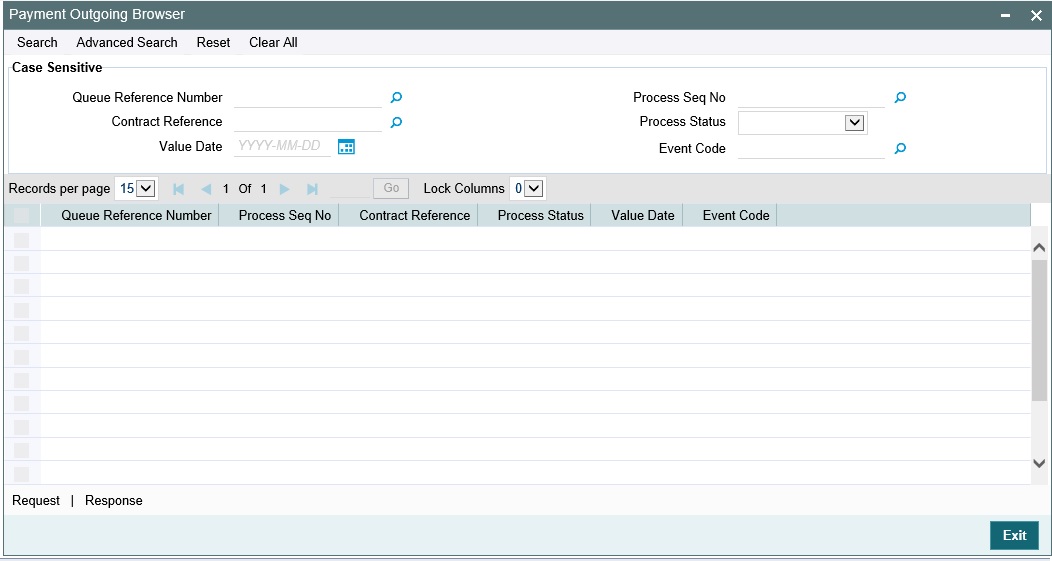

2.4.3.1 Viewing Payment Integration
You can view Oracle Lending and Loan Syndication contracts with payment
integration in ‘Payment Outgoing Browser’ screen.
To invoke this screen, type ‘OLSPMTBR’ in the field at the top right corner
In this screen, you can view the request sent from Oracle Lending/Loan
Syndicationmodule and view the response (received for the request sent)
from the Payments module.
- Queue Reference Number
- Sequence Number
- Contract Reference
- Process Status
- Value Date
- Event Code
Note
To search outgoing payment details, for LB side use
DD Contract Reference Number and for LP side use Contract Reference Number

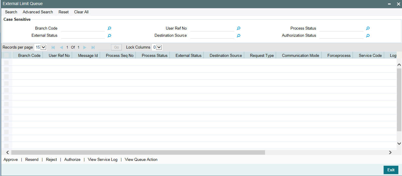

2.5.3.1 Viewing External Limit Summary
Details
External Limit Summary screen contains details of the Oracle Lending
and Loan Syndication transactions with ELCM linkage.
You can approve, resend, reject, and authorize the Oracle Lending
and Loan Syndication transactions using this screen.
To invoke this screen, type OLSEXLMT’ in the field at the top right corner
- Branch Code
- User Reference Number
- Message ID
- Process Sequence Number
- Process Status
- External Status
- Destination Source
- Request Type
- Forceprocess
- Service Code
- Logtime
- Authorization Status
- Maker ID
- Maker Date Stamp
- Checker ID
- Checker Date Stamp

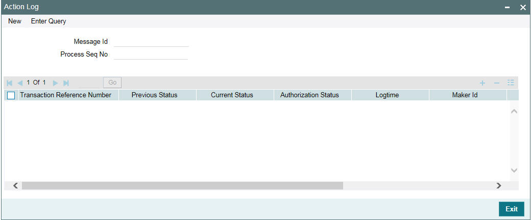

2.5.3.2 Viewing Action Log of External
Limit Queue
The action log screen displays the details of actions performed in
the External Limit Queue screen.
To invoke this screen, type ‘OLDQAHIS’ in the field at the top right corner
This screen displays
the action log of the following fields along with ‘Message Id’
and ‘Process Sequence Number’.
- Transaction Reference Number
- Previous Status
- Current Status
- Logtime
- Maker ID
- Maker Date Stamp
- Checker ID

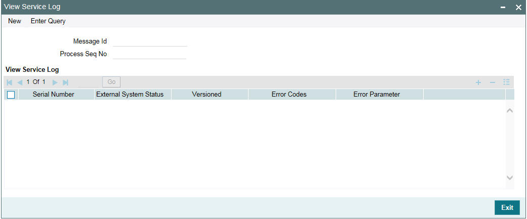

2.5.4 Viewing Service Log Details
You can view service log using ‘View Service Log’ screen.
To invoke this screen, type ‘OLDSRLOG’ in the field at the top right corner
