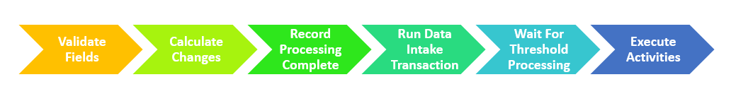

Data Intake record Processing Details
A record is part of a larger organizational unit called the Family Neutral Record (FNR). Each record contains information pertaining to a member, either the employee or one of the dependents of the employee. A record has a process order, indicating the order of processing for the record in the FNR. This section describes the steps involved in processing a single record in OIPA. Each step in the processing is described in detail with requirements.

Field Validation evaluates the fields on the record against the validation configuration that is defined in the Rules configured in the Intake Profile Definition. The following requirements apply to field validation:

Changes Calculation evaluates the data coming in on a record against either the prior record for the member or the current system data for the member. The purpose of changes calculation is to determine what information has changed. These changes are then made available to downstream processing to determine what to do with the changes.

The Intake Record Transaction provides a robust configuration mechanism to exercise a record. Here, it is up to the implementer to determine how to process the record. The following features are available in the Intake Record Transaction.

Threshold Processing is part of the File Processing defined above. Here, the record remains in a Pending Validation status until all records complete processing, and the File Level Validation can execute.

After file validation succeeds, all records that are in a "Pending Validation" status are moved into a "Pending Execution" status, where they are scheduled for execution in the grid.
