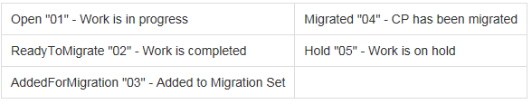

IvsConfigPackage.StatusCode: IvsCode.CodeName = "IvsCodeConfigPackageStatus"
A list of statuses available for a Configuration Package appears in Figure 5 below.
Figure 5 - Configuration Package Statuses
The Configuration Lead is responsible for reviewing all Configuration Packages to make sure there are no conflicts. Any rules that were deleted should reside in an Orphan Rules Configuration Package. All these rules should be reviewed to ensure the rules are not needed in any other configuration.

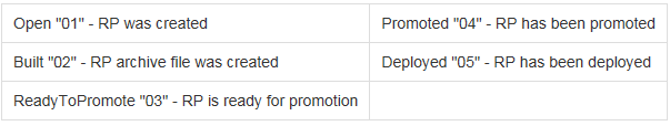

IvsReleasePackage.StatusCode: IvsCode.CodeName = "IvsCodeReleasePackageStatus"
A list of statuses available for a Release Package is shown in Figure 7 below.
Figure 7 - Release Package Statuses
Promotion mentioned in statuses 03 and 04 has to do with external Source Control Management (SCM) systems. The idea was to have SCM environments that corresponded to the OIPA environments, then to set a Release Package "Ready to Promote", check the Release Package into the SCM environment, "Promote" the Release Package to the target SCM environment, and then deploy the Release Package to the target OIPA environment. This process was part of an "external approval procedure," which was an offshoot of Sarbanes Oxley legislation. All of these steps must be performed manually as the Rules Palette currently does not interface with any third party SCMs.
