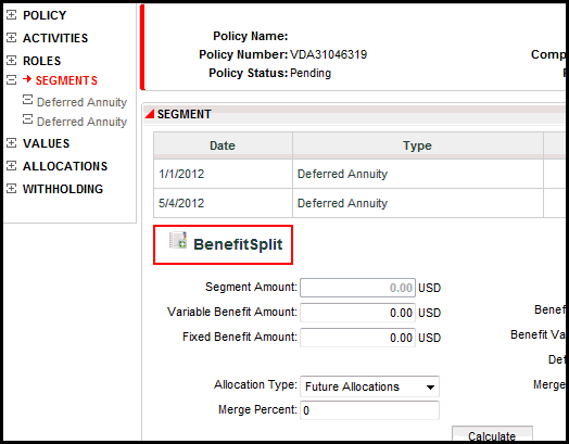

OIPA Benefit Split on Segment Screen
OIPA Benefit Split on Segment Screen in OIPA
