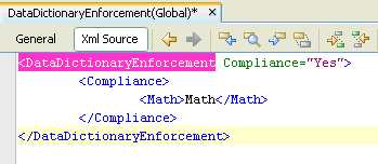

Check-out the DataDictionaryEnforcement business rule in the Global Rules Explorer. The file is located in Business Rules | System.
Select the XML Source tab and modify the first line to read: <DataDictionaryEnforcement Compliance=”Yes”>.
Check the rule back in after making the modification.

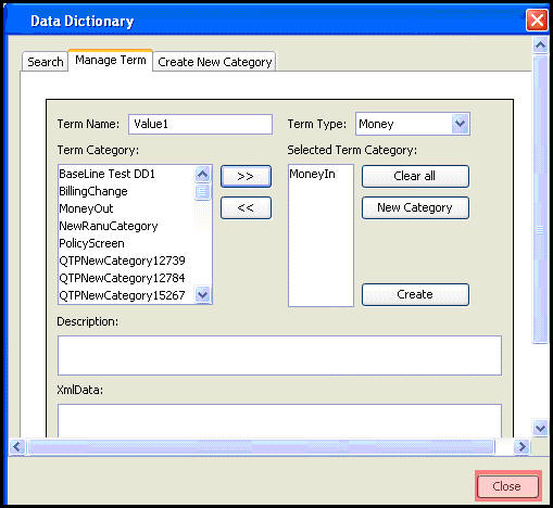

Select the hand icon in the Data Dictionary Validation pop-up window. The Data Dictionary Manage Term tab window appears.
Data Dictionary Manage Term Tab
Add the term/field name in the Manage Term tab and select Close.
The new term/field name should now have a corresponding green icon in the Data Dictionary Validation pop-up window to indicate that it has been validated.
Close the Data Dictionary Validation pop-up window once all terms have been validated.
