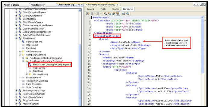

Step 1: Configure the FundScreen Business Rule
Before creating funds, the FundScreen business rule must be configured. This rule allows additional fields to be configured for parent level funds. The fields configured are used when entering fund information. They store custom information need by the business in the AsFundField table.
All fields needed by the various fund types must be configured in this rule. There is no way to filter fields by fund type in OIPA so they will all display for the user. If child funds, lateral funds or benefit split funds are needed, they must be defined in this rule as well.
Steps to Configure a FundScreen Business Rule
Navigate to the Global Rules Explorer.
Expand the Business Rules folder.
Expand the Screen folder.
Right-click the FundScreen folder and select New FundScreen Override.
Select Next in the first screen of the wizard.
- Select the appropriate company from the Company drop down box.
- Click Finish.
Open the new override rule in the Configuration Area and click the XMLSource pane.
- Configure the <ParentFundFields> element directly under the opening tag.
- Add a <Field> element for each field that is needed for parent funds. Please see the XML Configuration Guide topic in this help system for a list of all elements, attributes and values needed for configuration. View Common Elements | Field Elements.
Right-click on the FundScreen.xml file and select Check-In.
FundScreen Business Rule with ParentFundField Element

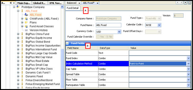

The image below shows a fund open in the Configuration Area. Section A contains the fund details, which are stored in AsFund and captured through the Fund wizard when the fund is first created. Section B shows the fund fields that were configured in the FundScreen business rule. The user enters information on the screen and when saved it is stored in AsFund.
Fund Information from Admin Explorer Funds Node
