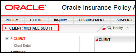

Inquiry screens configured to display at the Client level will appear in OIPA on the Client screen. The Inquiry link will appear on the Secondary Menu.
Client Level Inquiry in OIPA
