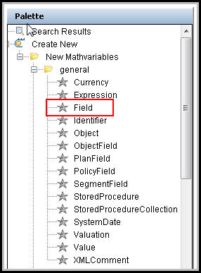

Field Math Variable in the Rules Palette
Field Math Variable in Palette

Drag and drop the Field Math variable from the Palette window onto the Math Pane. Enter the following information for the math variable.
