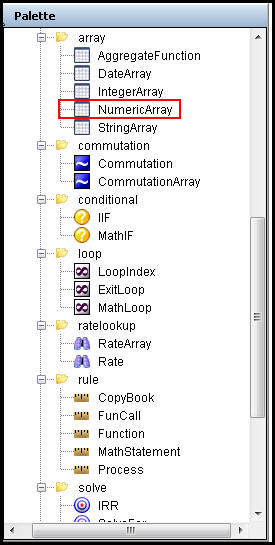

NumericArray Math Variable in the Rules Palette
NumericArray Math Variable in Palette

Drag and drop the NumericArray math variable from the Palette window onto the Math Pane. Enter the following information for the math variable.
