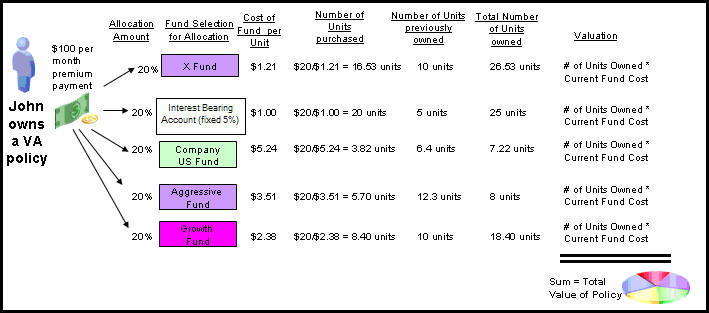

Simplified Valuation Diagram
Valuation and Unit Linked Funds
Unit linked funds require a special type of valuation.
