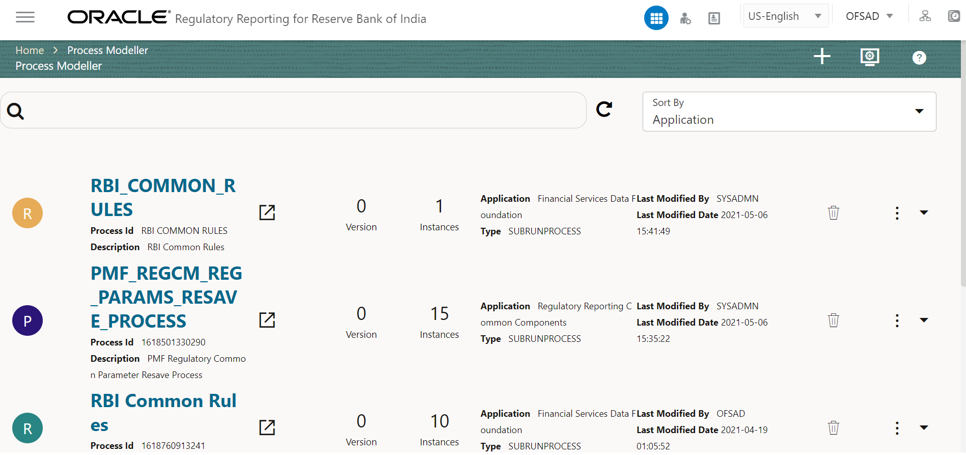

After designing and saving the process flow diagram, the Process is listed in the Process Modeller page.
To select the Run parameters and execute the Run, follow this procedure:
1.     After logging into OFSAAI applications page, navigate to Oracle Financial Services Regulatory Reporting for Reserve Bank of India, select Process and then select Process Modeller. In the Process Modeler page, click More corresponding to the Run Pipeline that must be executed.
More Icon
Figure 62: Process Modeler Page
This illustration provides the list of run pipeline that must be executed.

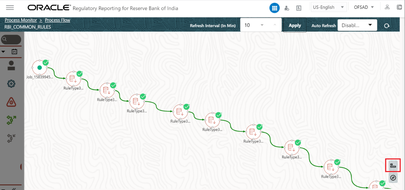

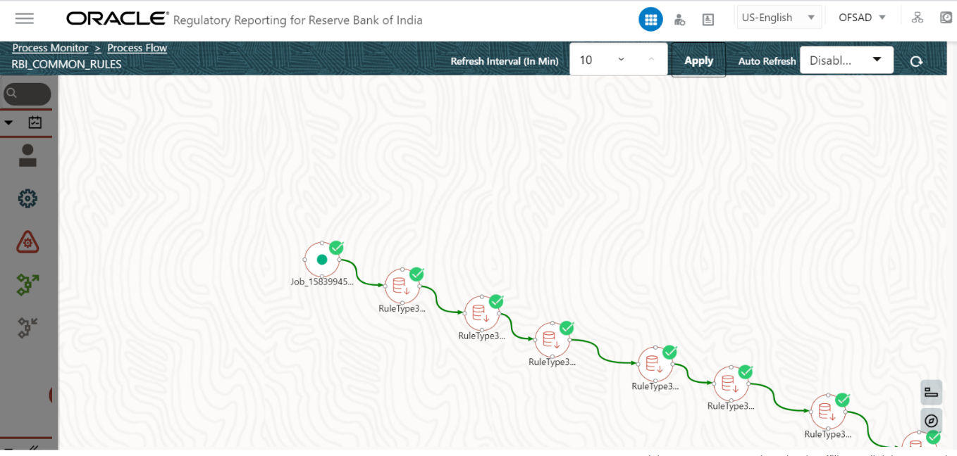

2.     Select the Process Flow Monitor option from the drop-down list. The Process Monitor window is displayed. You can see the generated process flow ID, the Run execution timestamp, and the status of the Run execution. To verify the Run execution status at the Pipeline level, click the corresponding process flow ID.
Figure 65: Process Monitor Screen
This illustration provides information on the run execution status.
3.     The process flow diagram window is displayed. The Successful Execution Icon icon at each Sub Pipeline indicates that the Run execution is successful.
Figure 66: Run Pipeline Process Flow Diagram
This illustration shows the process flow diagram for the selected run pipeline.
NOTE:
The Show Entire label Icon icon shows the entire label of the nodes in the Process Flow Diagram and the Show Navigation Icon icon shows the nodes navigation in the diagram.

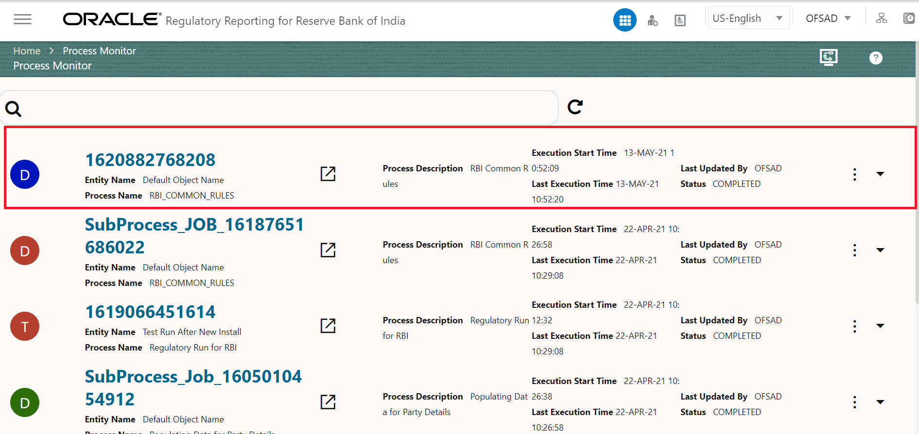

Verifying the Execution Logs
You can access the execution logs to verify the details of the Run.
To verify the execution log, follow these steps:
1.     After logging into OFSAAI applications page, navigate to Oracle Financial Services Regulatory Reporting for Reserve Bank of India, select Process and then select Process Monitor.
2.     In the Process Monitor window, click the required process flow ID.
The process flow diagram is displayed in a new window.

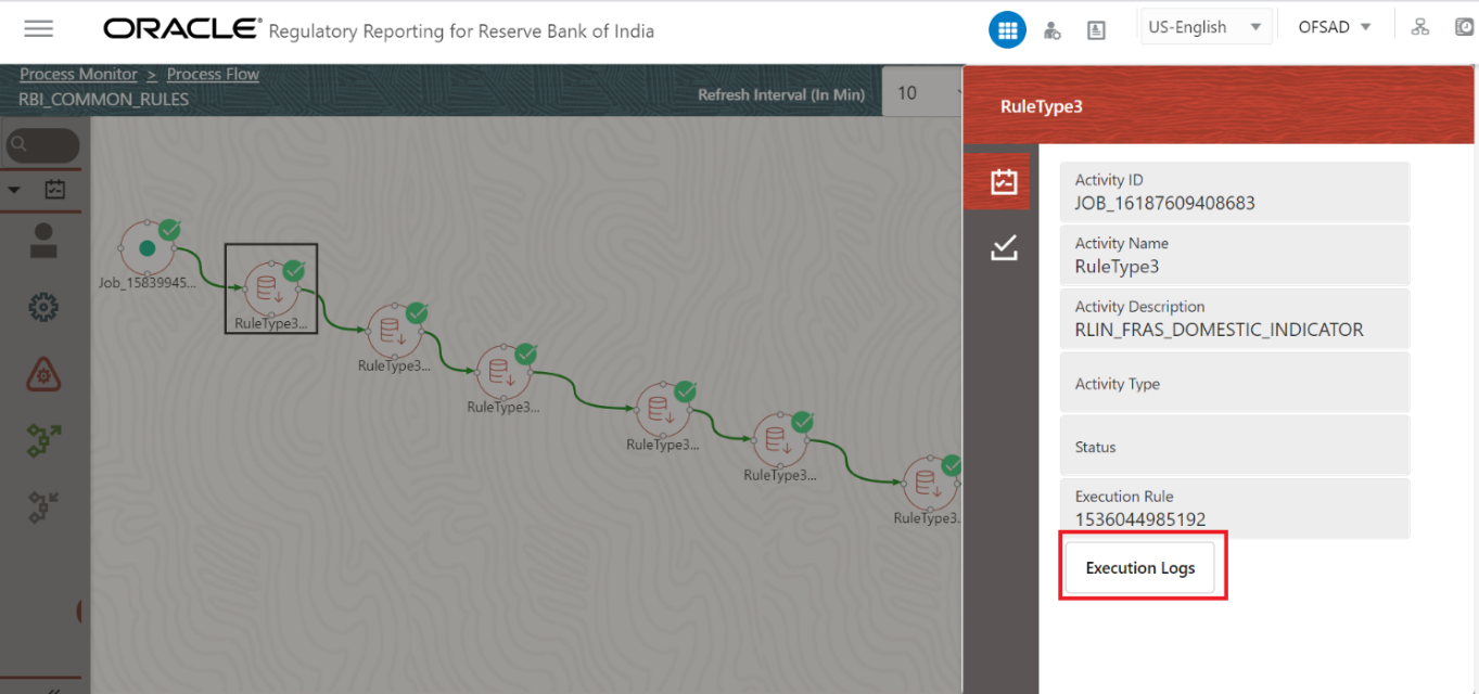

4.     Click the required node and the Activity window is displayed.
Figure 69: Activity Logs
This illustration provides information on the run execution activity.

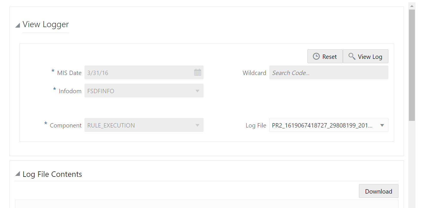

5.     Click Execution Logs. The Log File details page is displayed.
This illustration allows you to select the appropriate fields to view the run execution log details

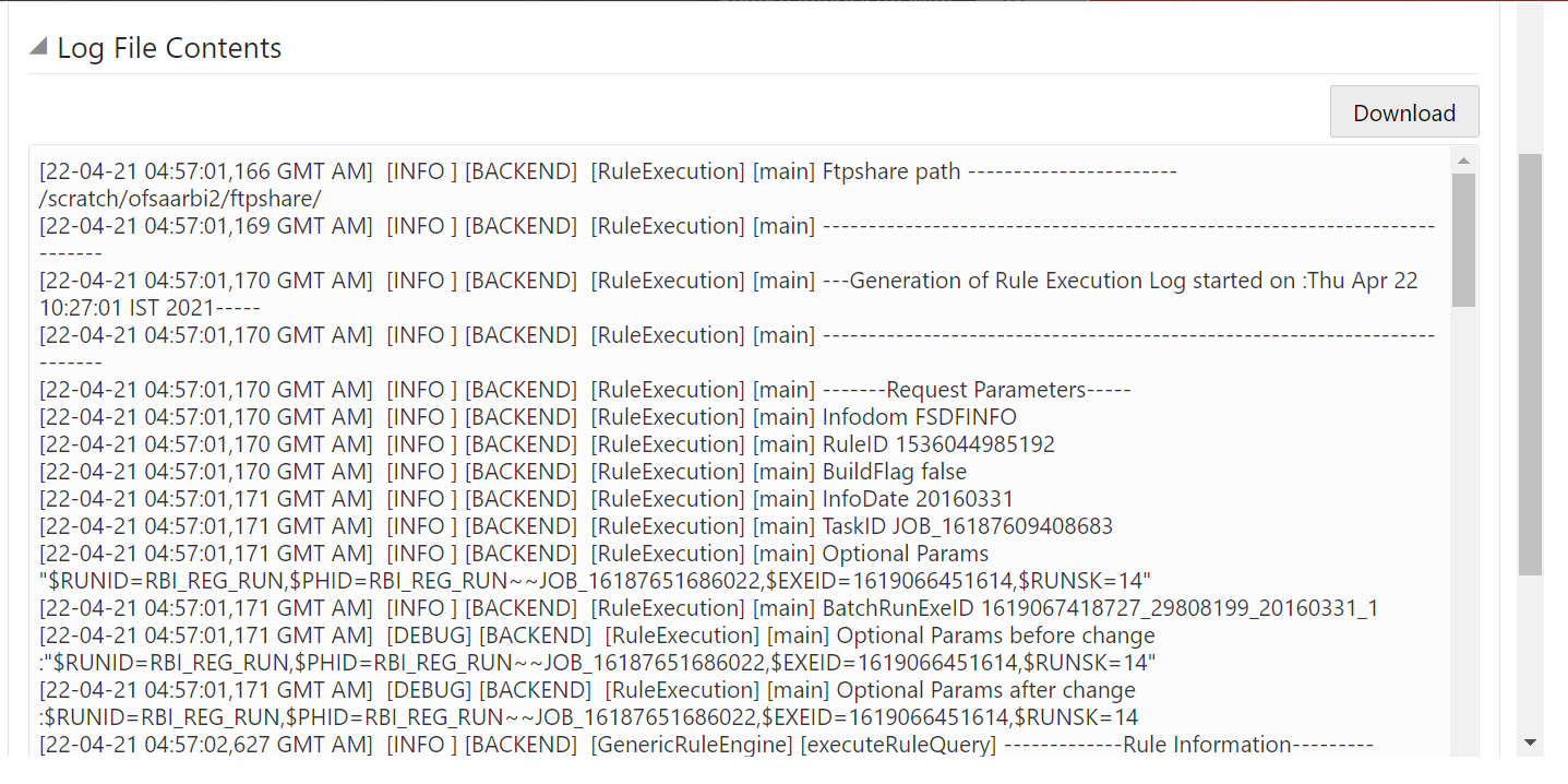

6.     Select the Log File that you wish to view from the drop-down list and click View Log. The Run execution log details are displayed.
Figure 70: View Run Execution Log window
This illustration allows you to view the run execution log details.
