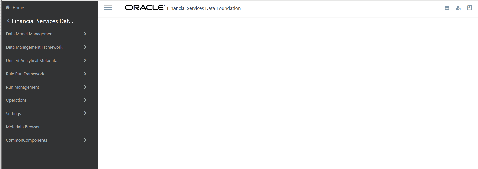

Figure 101: FSDF Landing Page
Description of the Financial Data Foundation Home page follows This illustration shows the OFSDF home page which is displayed after you login.

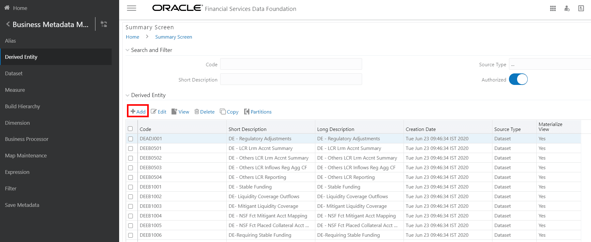

1.     Navigate to Financial Services Data Foundation, select Unified Analytics Metadata, select Business Metadata Management, and then select Derived Entity. The existing derived entities summary screen is displayed. You can Add a new derived entity and Edit, View, Delete, or Copy an existing derived entity.
    Figure 102: Derived Entity Summary Page
Description of the Derived Entity Summary page follows This illustration shows the navigation to the Derived Entity Summary in the FSDF application.
2.     Click Add to create a new Derived Entity.

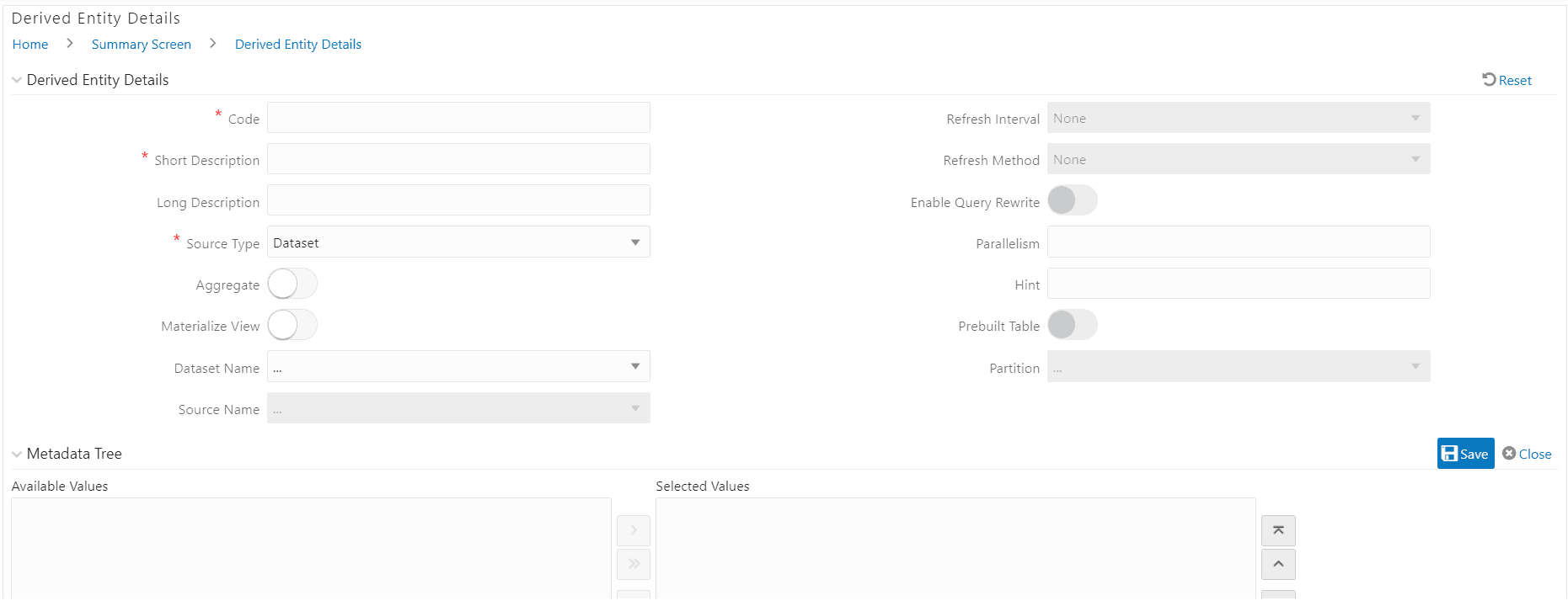

   Figure 103: Derived Entity User Interface
Description of Derived Entity User Interface page This illustration shows the Derived Entity user interface where you can add the Derived Entity details.
Creation of Derived Entity
Derived Entities must have Code, Short Description, and Source Type mandatory dimensions as shown in Figure 91. The rest of the structure of the derived entity can vary depending on the dimensions present. A metadata configuration table is present in AgileREPORTER to link the name of the column in the derived entity and dimension that is referred to in the dimension mapping process.
