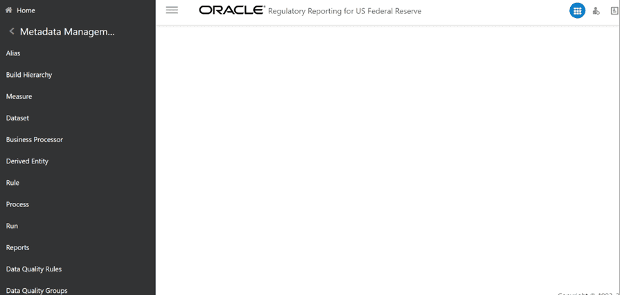

Figure 98: Regulatory Reporting Metadata Landing Page

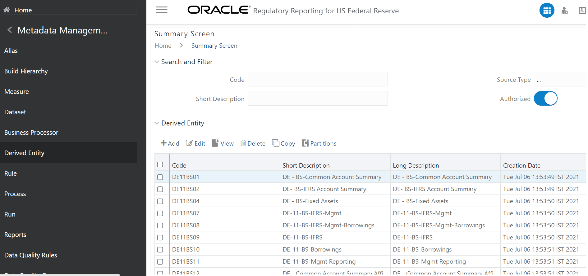

1.     Navigate to Regulatory reporting for US Federal Reserve, select Metadata Management, and then select Derived Entity. The existing derived entities summary screen is displayed. You can Add a new derived entity and Edit, View, Delete, Copy or Partition an existing derived entity.
Figure 99: Derived Entity Summary Page
Derived Entities must have AS_OF_DATE and LEGAL_ENTITY as the mandatory dimensions. The rest of the structure of the derived entity can vary depending on the dimensions present. A metadata configuration table is present in AgileREPORTER to link the name of the column in the derived entity and dimension that is referred to in the dimension mapping process.
Derived entities have data for the ‘Final Reporting Run’ only, which is reported to the Regulatory, and are refreshed for the latest hand-off date.
A metadata configuration table is maintained within AgileREPORTER to capture the derived entities that supply data for each schedule.

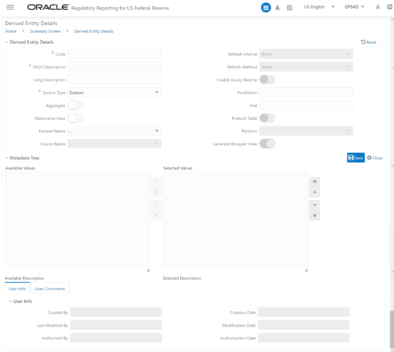

2.     Click Add to create a new Derived Entity.
Figure 100: Derived Entity User Interface
Creation of Derived Entity
Derived Entities must have Code, Short Description, and Source Type mandatory dimensions. The rest of the structure of the derived entity can vary depending on the dimensions present. A metadata configuration table is present in AgileREPORTER to link the name of the column in the derived entity and dimension that is referred to in the dimension mapping process.
Derived entities have data for the Final Reporting Run only, which is reported to the Regulatory, and are refreshed for the latest hand-off date.
See the OFS Analytical Applications Infrastructure User Guide for more information on creating a derived entity.
