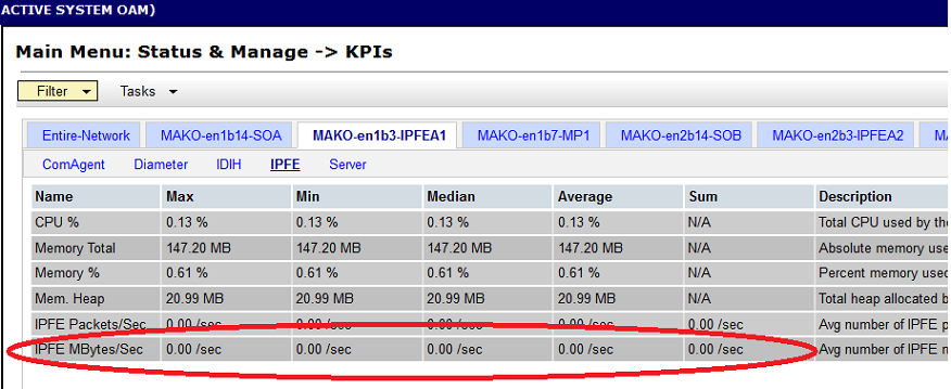

Diagnostic Information:
Refer to the KPI to check the IPFE data rate:
