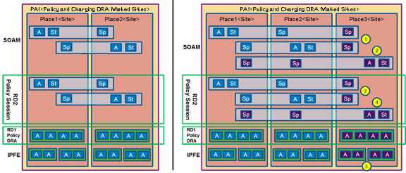

Comparing 2-Site and 3-Site Redundancy
To achieve the same redundant capacity of a mated pair in a mated triplet, multiple things need to be added:
  • One Preferred Spare SOAM to every existing SOAM server group.
  • One SOAM quadruplet server group for the third DSR.
  • One Preferred Spare SBR to every existing SBR server group (total of two spares per group).
  • [Optional] One new SBR quadruplet server group homed to the new site for every existing pair of SBR server groups. This increases total Session SBR capacity, but is primarily intended to balance flows.
  • The same quantities of IPFEs and DA-MPs of the original DSR to the new DSR and Diameter connections to all of the Policy and Charging Clients and Policy and Charging Servers associated with the mated triplet.
Figure 3-11 Comparing 2-Site and 3-Site Redundancy
