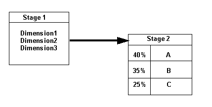

The diagram follows the direct flow of allocations, from one stage to another.
Direct allocation data is used to calculate the percentage for each step along the flow using the following formulas:
  • For drilling forward:
    % = ASSG CostReceivedPrior(orIntra)Stage / SRC NetCostForAssignment
  • For drilling backwards:
    % = ASSG CostReceivedPrior(orIntra)Stage / DEST NetCostForAssignment
For each stage, the percentage of each allocation contributing to the next intersection is displayed, from highest to lowest. The percentages displayed for a stage will not equal 100% if the following conditions exist:

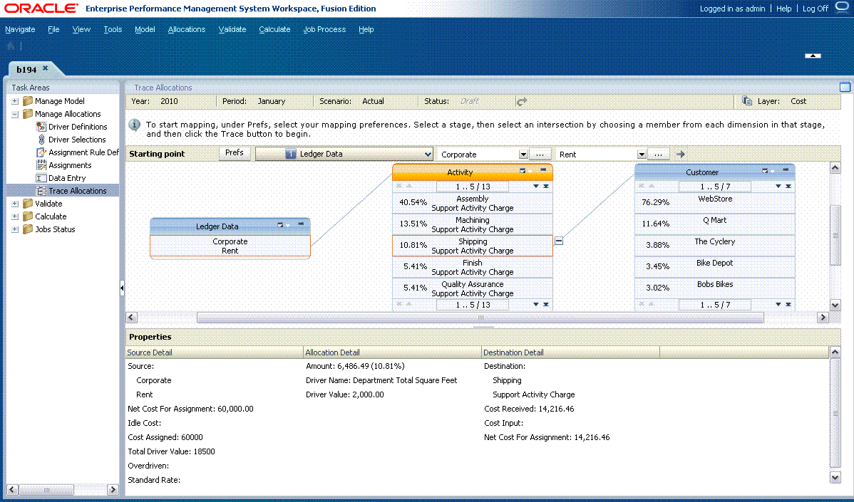

    The selected intersection is displayed on the screen, showing the name of the stage, and the members selected for each dimension in the intersection. The Properties for the starting point of the selected intersection are displayed at the bottom of the screen.
    The selected intersection is displayed, and you can expand the plus icon on either side of the icon to follow the flow of allocations forward or backward in the model.
    You can drag the entire flow diagram to position it for a more effective view. Depending on the number of dimensions in the model stage, you may need to stretch or scroll the window to see the Trace button on the far right side of the task bar.
  9. Optional: On the intersection header, select the Trace Allocation Context Menu Trace Allocation Context Menu , and then select the maximum number of nodes that you want to display when the selected intersection is expanded (3, 5, 10 or 20). You can repeat this selection on any intersection.
  10. Click the intersection to highlight the source node.
    Expand node Plus Sign icon is only displayed on the intersection after it has been selected.
  11. Under Properties, review the Source Detail that pertains to the selected intersection .

  12. Select the next intersection to view, and click expand Plus Sign Icon to view the incoming or outgoing allocations for the selected intersection. You can navigate either upstream or downstream by expanding the nodes on either side of the intersection.
    The intersections that contribute to, or receive value from, the starting point show the stage and associated members. The percentage for each allocation is displayed, from highest to lowest.
    • If there are idle costs on an intersection.
    • If there is cost input at a destination when drilling upstream (back to the source).
    The Trace Allocation Detail displays the direct allocations for the selected intersection.
  13. Double-click the stage header to expand and view the intersections that are included in the allocation. The source and destination intersections are highlighted.
  14. Click any intersection to view its details in the Properties pane at the bottom of the screen.
