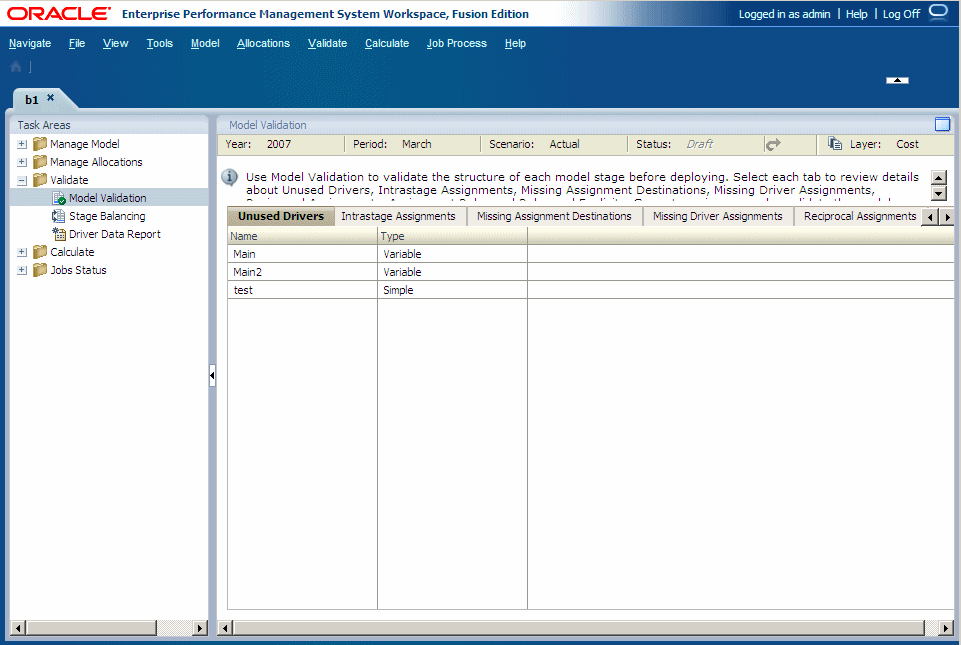

  1. In an open model, from Task Areas , select Validate, then Model Validation.
    The Model Validation screen is displayed.
    Use the Model Validation window to validate the structure of each model stage before deploying the application.
  2. Select the POV for the model to be validated and then click Go Go Button .
  3. From Layer, select the cost or revenue layer to begin the validation process.
    When the validation is complete, the screen is updated to reflect the results.
  4. Optional: Select the Unused Drivers tab to view any unassigned drivers in the model, and determine whether these drivers should be part of an assignment.
