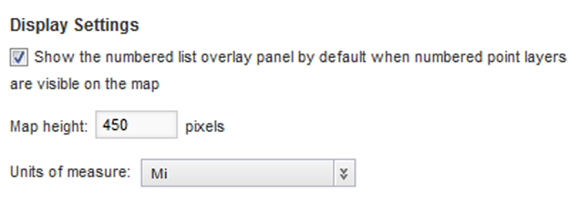

Under
Display Settings:
If the map includes a numbered pin layer, then to display the
numbered pin list by default when the component is first displayed, check the
Show numbered list overlay panel by
default check box.
In the
Map height field, type the height in
pixels for the
Map component.
From the
Units of measure list, select the unit of
measurement to use for the map.
To use the preferred unit of measurement based on the current
locale, select
use locale default.
Otherwise, you can have the map always use either miles or
kilometers.
