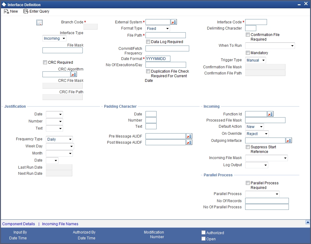

In order to enable the interface, you need to define the interface details for Oracle FCPB in FCUBS. You can define the format details and properties of interface files using ‘Interface Definition’ screen. To invoke this screen, type ‘GIDIFTDF’ in the field at the top right corner of the Application tool bar and click the adjoining arrow button.
You need to define the interface details.
External System
Specify the code that identifies the external system. The interface details defined on this screen are applicable to the interface between FCUBS and the external system selected here.
For FCPB interface, you need to specify ‘FCPB’ as the external system.
Interface Code
Specify a unique code that identifies the interface between the above external system and FCUBS.
Interface Type
Select the interface type from the following options:
File Mask
Specify the file mask for the outgoing interface file. The system decides the name of the handoff file based on the file mask defined here.
Format Type
Select the message format type. Choose one of the following format types based on the data length:
If you select ‘Delimited’, the system enables the field ‘Delimiting Character’.
File Path
Specify the directory in which the interface file is stored.
For further details on the fields on ‘Interface Definition’ screen, refer to the section ‘Specifying Interface Definition Details’ under chapter ‘Generic Interface’ of Generic Interface user manual.

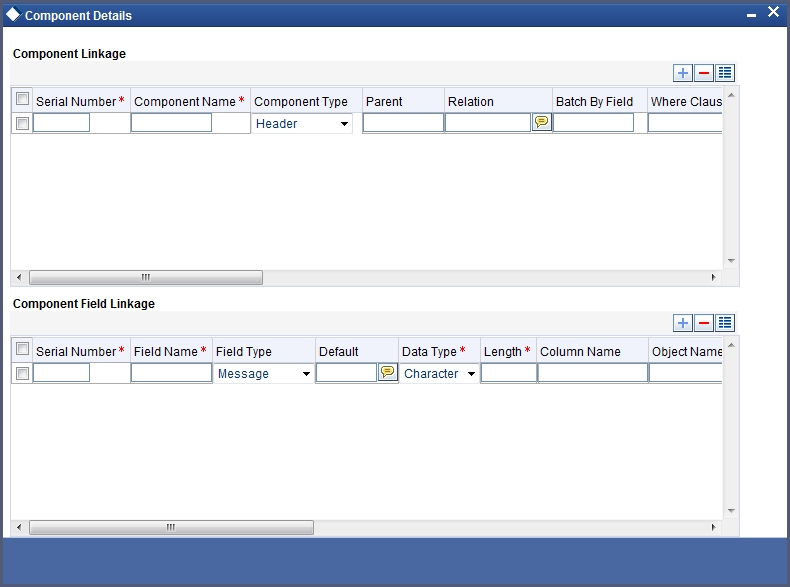

As part of interface definition, you need to capture specific component details for both handoff and upload. Click ‘Component Details’ button on the ‘Interface Definition’ screen.
You can capture the details of the header, body and footer under ‘Component Linkage’ section. Below that, under ‘Component Field Linkage’ section, you can define the details pertaining to table columns, field type, field length, field name and other relevant details.
For more details of the fields on this screen, refer the chapter ‘Generic Interface’ in the Generic Interface User Manual.

In ‘Component Details’ sub-screen, you need to maintain the following details:
