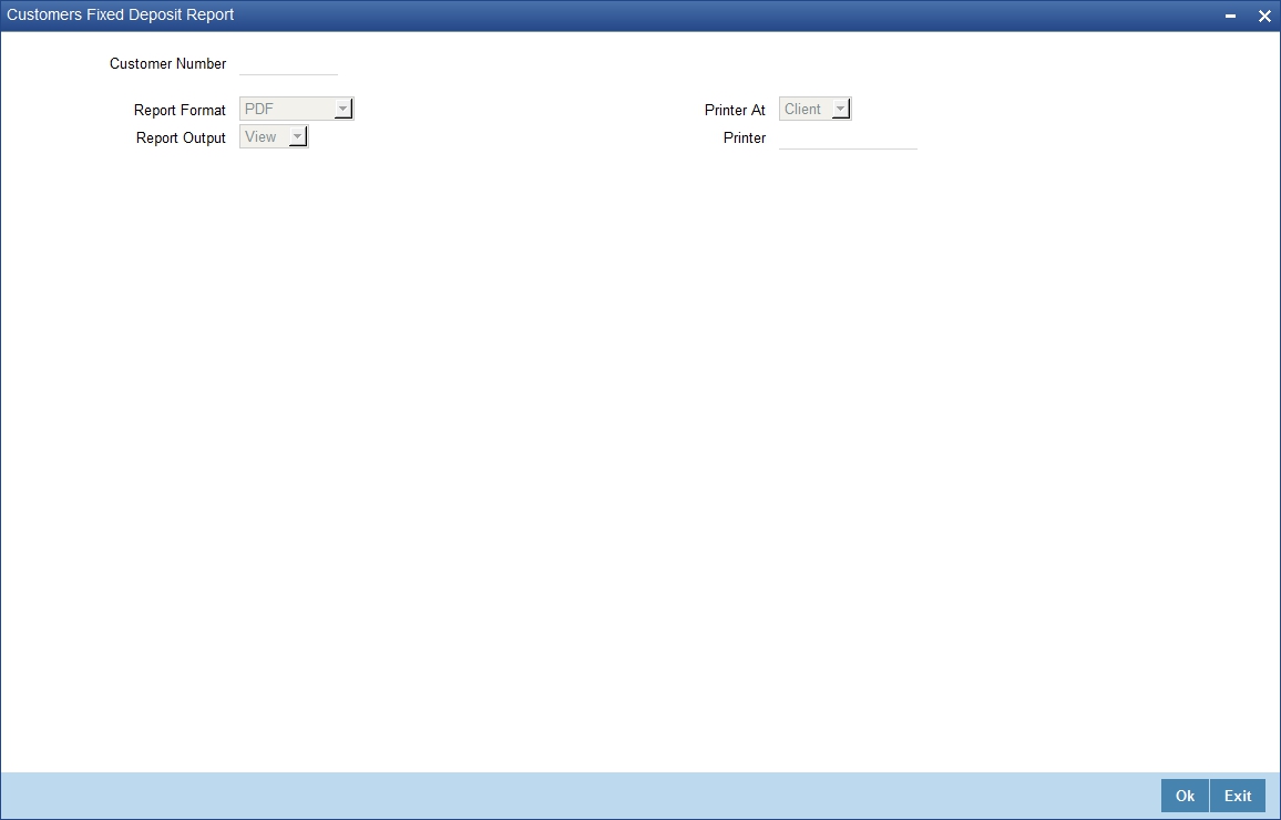

10.2 Customers Fixed Deposit Report
This report lists out all time deposit accounts for a given customer. This report also provides additional information of whether lien is marked or not. You have an option to print and view the report in PDF, HTML, RTF or Excel format.
You can invoke ‘Customers Fixed Deposit’ screen by typing ‘TDRFIDEP’ in the field at the top right corner of the Application tool bar and clicking on the adjoining arrow button.
Specify the following details here:
Customer Number
Select the customer number from the adjoining option-list. The list displays all valid customer codes. On failure to provide the value, the report fetches records for all available customers and accounts across the branches.
Click ‘OK’ button to generate the report. Click ‘Exit’ to return to the Reports Browser.

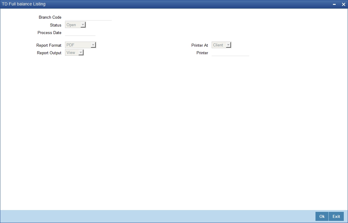

10.3 TD Full Balance Listing Report
This report gives a complete listing of time deposit accounts opened till the run day. This report gives account class wise grouping of accounts with totals. You have an option to print and view the report in pdf or excel format.
You can invoke ‘TD Full Listing Reports’ screen by typing ‘TDRFULBL’ in the field at the top right corner of the Application tool bar and clicking on the adjoining arrow button.
Branch Code
Select the branch code for which the report needs to be generated, from the adjoining option-list. The list displays all valid branch codes. You have an option to select all the branches or a single branch. If the branch code is not specified, then the TD accounts of all the branches are shown in the report.
Status
Select the account status from the drop-down list. The options available in the drop-down list are as follows:
Click ‘OK’ button to generate the report. For the selected branch, currency-wise deposit amount and number of deposits for the previous month and current month will be displayed along with the cost %.
Process Date
Select the date for processing the report from the adjoining calendar button. The open or close TD accounts till the process date is displayed. If the process date is not specified, then the open or closed TD accounts till current system date are shown.

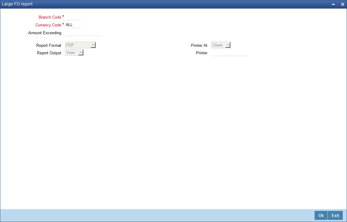

10.4 Large FD Report
This report provides customer-wise details of large time deposits beyond the given amount criteria. You have an option to print and view the report in pdf or excel format.
You can invoke ‘Large FD Report’ screen by typing ‘TDRFDREP’ in the field at the top right corner of the Application tool bar and clicking on the adjoining arrow button.
Branch Code
Select the branch code for which the report needs to be generated from the adjoining option-list. The list displays all valid branch code s. You have an option to select all the branches or a single branch.
Currency
Select the currency code from the adjoining option-list. The list displays all valid currency codes maintained in the system. By default the value ‘ALL’ will be displayed.
Amount Exceeding
Specify the deposit amount here. The report generated will include only those accounts which exceed the deposit amount specified here.

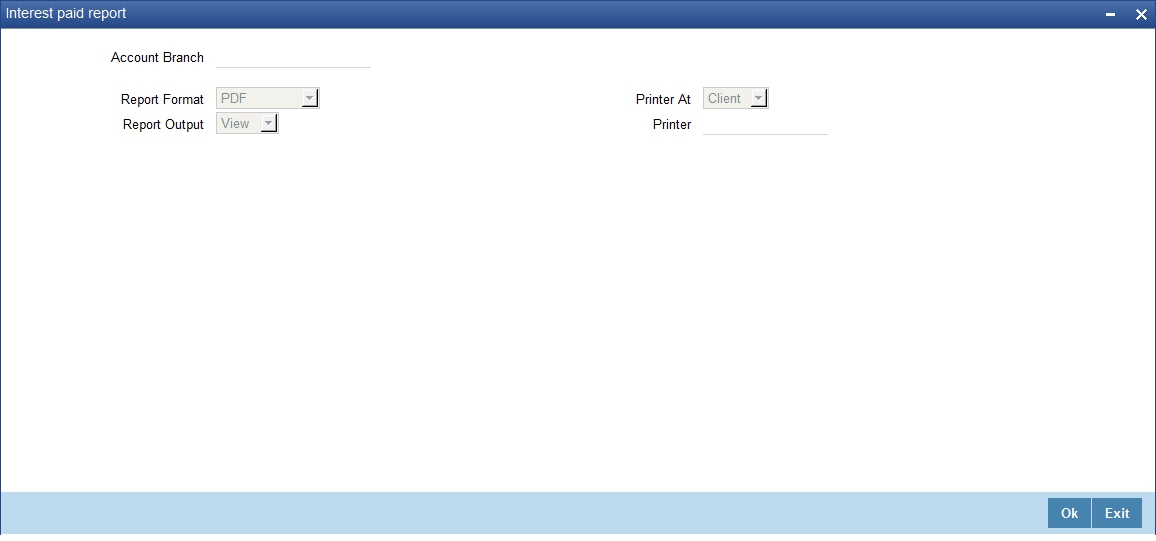

10.6 Interest Paid Report
This is a report of term deposits interest paid for the day. In this report accounts are grouped Account class wise and interest type wise. This report is generated at BOD.
You can invoke ‘Interest Paid Report’ screen by typing ‘TDRINREP’ in the field at the top right corner of the Application tool bar and clicking on the adjoining arrow button.
Branch Code
Specify the branch code. The system will generate the interest paid report for the branch code that you have selected. If the branch code is not specified, then all the branch accounts are shown in the report.

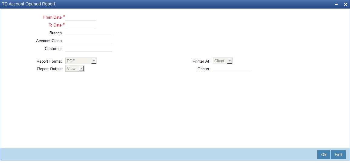

10.9 Term Deposits Opened for the Period Report
This report list the term deposit accounts which are opened for the given period, and that are currently on open status.
You can generate this report using ‘TD Account Opened Report’ screen by typing ‘TDROPEN’ in the field at the top right corner of the Application tool bar and clicking on the adjoining arrow button.
From Date
Enter the TD accounts which are opened from this date. However by default the system displays the current application date.
To Date
Enter the TD accounts which are opened till this date. However by default the system displays the current application date.
Branch
Specify the branch code of the TD account. The adjoining option list displays the list of all the valid TD/RD branch codes maintained in the system. You can choose the appropriate one.
Account Class
Specify the account class of TD account. The adjoining option list displays the list of all the valid TD/RD account classes maintained in the system. You can choose the appropriate one.
Customer
Specify the customer number of the customer. The adjoining option list displays the list of all the valid customer numbers maintained in the system. You can choose the appropriate one.

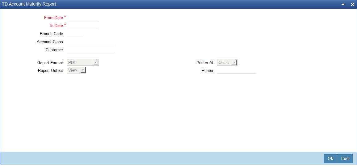

10.12 Term Deposits Account Maturity Report
This report lists the term deposits that will be matured for the given period. You can generate this report using ‘TD Account Maturity Report’ screen.
To invoke this screen, type ‘TDRMATR’ in the field at the top right corner of the Application tool bar and click on the adjoining arrow button.
From Date
Enter the From date. This should be greater than the current application date
To Date
Enter the To date. This should be greater than the current application date
Branch Code
Account Class
Customer
10.12.1 Contents of the Report
The parameters specified while generating the report are printed at the beginning of the report. The contents of the report are discussed under the following heads:
Header of the report
The header of the generated report will have the following information:
Field Name
Field Description
Branch
Current Branch Code and branch Name
Branch Date
Current Branch Date
Run Date & Time
Current Run Date and Time
User ID
Operator generating the Report
Module
Module of the Report
Page No
Page No. of the Report
Body of the report
The generated report will have the following information:
Field Name
Field Description
Account Number/Deposit Number
This indicates the TD account Number
Customer Name
This indicates the Name of the TD account holder
Date of Open
This indicates the TD account opened date
Value Date
This indicates the Value Date of the TD account
Deposit Amount
This indicates the Deposit Amount
Maturity Date
This indicates the Maturity date of the TD account
Deposit Term
This indicates the TD Tenor (Maturity Date – Interest Start Date)
Total Interest Payable
This indicates the Interest Amount
(This will show interest amount on the maturity date)
Goal Reference Num­ber
This indicates the identification number of the goal provided by the external channels.
Interest rate
This displays the interest rate applicable for the account
Maturity Amount
This displays the maturity amount for the tenor of TD
Branch
This indicates the Branch Name
Product Code
This indicates the product code of the TD account
Product Currency
This indicates the Currency of the TD account class
Currency Total
This indicates the Currency-wise total for deposit amount, Interest Payable and Maturity Amount
Auto Rollover
Will indicate whether the TD is Auto Rollover or not
Stock Catalogue Code
This displays Stock Catalogue Code for the TD certificate number
Certificate Number
This indicates the certificate number
Duplicate issue
This indicates Y/N based on the duplicate certificate genera­tion for TD account
Interest Rate Based on Cumulative Amount
This indicates whether the interest rate for the deposit is arrived using cumulative amount or not.

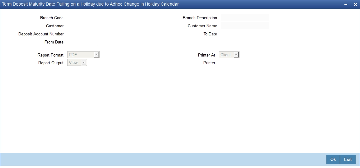

10.14 TD Account Maturity Date Falling on a Holiday Report
You can generate this report using the ‘Term Deposit Maturity Date Falling on a Holiday due to an Adhoc change in Holiday Calendar’ screen.
This report displays the list of Term deposit for which the maturity date falls on a holiday due to Adhoc holiday change.
You can invoke this screen by typing ‘TDRMDFOH’ in the field at the top-right corner of the Application tool bar and clicking the adjoining arrow button.
From Date
Specify the date from which the report for TD account maturity date change should be generated. By default, system displays the current Application date.
To Date
Specify the date till which the report for TD account maturity date change should be generated. By default, system displays the current Application date.
Branch Code
Specify the branch code of the TD account. The adjoining option list displays all valid TD branch codes maintained in the system. You can choose the appropriate one.
Deposit Account Number
Specify the account number of the term deposit. The adjoining option list displays tall valid deposit account numbers maintained in the system. You can choose the appropriate one.
Customer
Specify the customer number here. The adjoining option list displays all the valid customer numbers maintained in the system. You can choose the appropriate one.
Report Format
Select the format in which you want to report to be generated from the options provided in the drop-down list. This list displays the following values:
Report Output
Select the output for the report from the adjoining drop-down list. This list displays the following values:
Printer At
Select the location where you want the report to be generated from the options provided in the adjoining drop-down list. This list displays the following values:
Printer
Specify the name of the printer or select it from the option list provided. The adjoining option list displays all the configured printers.
This is applicable only if you have specified the output as 'Print'.
Click the ‘Ok’ button to generate the report. Click ‘Exit’ to return to the Reports Browser.
10.14.1 Contents of the Report
Field Name
Field Description
Branch
Branch Date
Current Branch Date
User ID
Report From Date
Date from which the report is generated
Report To Date
Date till which the report is generated
Body of the report
Field Name
Field Description
Customer ID
This indicates the customer ID
Customer Name
This indicates the customer name
This indicates the deposit account num­ber
Account Description
This indicates the account description
Account Branch
This indicates the account branch
Account Currency
This indicates the account currency
Deposit Amount
This indicates the deposit amount
Deposit Tenor
This indicates the deposit tenor
This indicates the deposit maturity date
Account Open Date
This indicates the account opening date
Account Class
This indicates the account class
Generate Advice
Indicates whether the advice should be generated or not.

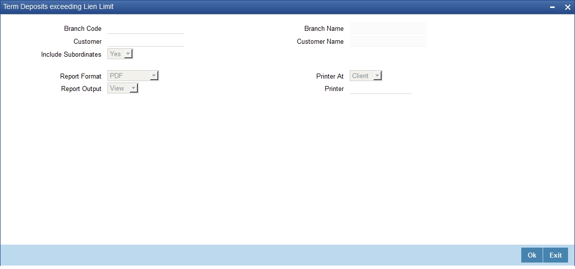

10.17 Term Deposits Exceeding Lien Limits Report
You can generate a report of term deposits exceeding the lien reports using ‘Term Deposits Exceeding Lien Limit’ screen. To invoke the screen, type ‘STRLELMT’ in the field at the top right corner of the application toolbar and click the adjoining arrow button.
Specify the following details:
Branch Code
Specify the branch code for which you are generating the report. The option list displays all valid branch codes available in the system. Choose the appropriate one.
Based on the branch code selected, the system displays the name of the branch.
Customer
Specify the CIF of the customer for whom the report is being generated. The option list displays all valid customer numbers that are applicable. Choose the appropriate one.
Based on the customer number, the system displays the name of the customer.
Include Subordinates
The relationship managers can generate the reports for the customers who are associated with their subordinate RMs. Choose one of the following options:
Once you have specified the details, click ‘OK’. The system generates the report based on the parameters specified.

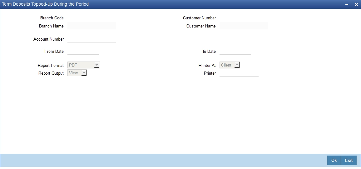

10.19 Term Deposits Topped-up During the Period
You can generate the Term Deposit Top-up report for TD accounts for which the top-up is made. This report can be generated for all branches or for specific branch for account.To invoke the screen, type ‘TDRTOPUP’ in the field at the top right corner of the application toolbar and click the adjoining arrow button.
Specify the following:
Branch Code
Select the current branch code from the adjoining option list.
Branch Name
The branch name of the selected branch code is displayed here.
Account Number
Select the account number from the adjoining option list.
Customer Number
Select the customer number from the adjoining option list.
Customer Name
The customer name of the selected customer is displayed here.
From Date
Specify the date from which the report for topped-up TD account should be generated.
To Date
Specify the date till which the report for topped-up TD account should be generated.
Report Format
Report Output
Printer At
Printer

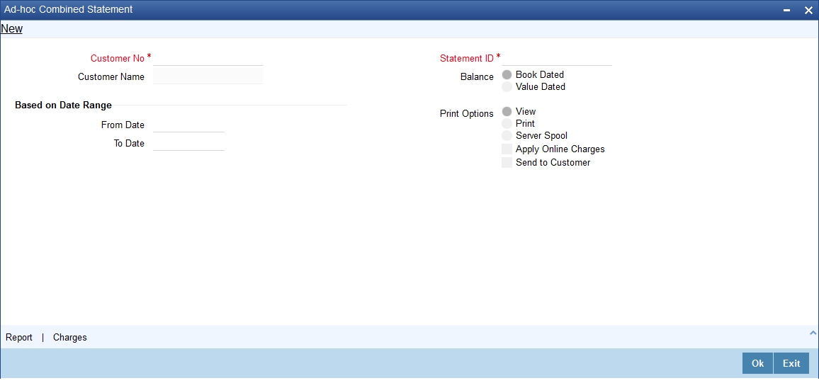

10.20 Ad-Hoc Combined Statement
You can generate ad-hoc combined statement through ‘Ad-Hoc Combined Statement’ screen.You can invoke this screen by typing ‘STDCDSMT’ in the field at the top right corner of the Application tool bar and clicking on the adjoining arrow button.
Customer No
Customer Name
The system displays the customer name.
Statement ID
Select the statement ID from the adjoining option list.
Balance
You can select the balance to view based on the book date or value date.
Based on Date Range
From Date
Specify the from date for the combined statement generation.
To Date
Specify the to date for combined statement generation.
Print Options
You can print, view or spool the statement.
Apply Online Charges
Check this box to indicate that the charges needs to be applied to generate the ad-hoc account statement.
Send to Customer
Check this box to send the statement to the customer.
Processing Ad-Hoc Combined Statement
You can process the ad-hoc combined statement by doing the following:

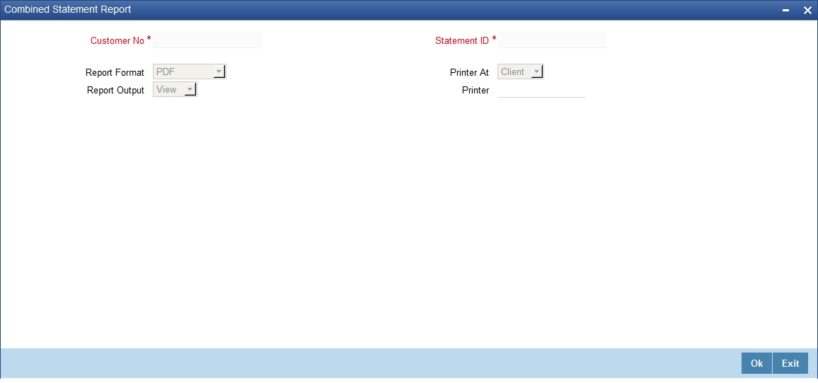

10.20.2 Combined Statement Generation Report
You can generate Combined Statement Report using ‘Combined Statement Report’ screen. You can invoke this screen by typing ‘CSRCSTAD’ in the field at the top right corner of the Application tool bar and clicking on the adjoining arrow button.
Customer No
The system displays the customer number.
Statement ID
The system displays the statement ID.
The parameters specified while generating the report are printed at the beginning of the report. Other content displayed in the report is as follows:
Header
The following details are displayed in the header section:
Field Name
Field Description
Report Name
Indicates Report Name
Branch Code / Branch Name
Indicates Current Branch code and Branch Name
User ID
Indicates the Identification of the User
Branch Date
Indicates the date of Branch in which report is taken
Page No
Displays Page No out of total No of pages in report
Module
Indicates the Module of the Report
Report Run Date
Indicates Current System Date
Report Run Time
Indicates Current System Time
Customer Name
Indicates the name of the customer
Customer Address
Indicates the address of the customer
Account Summary Details
Indicates the summary details for CASA, TD and CL
Body of the Report
The body of the report displays:
For further details on combined statement refer section ‘Maintaining Combined Statements’ section in ‘Generating Account Statements’ chapter of ‘CASA’ user manual.

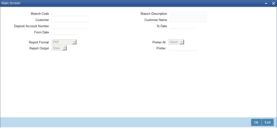

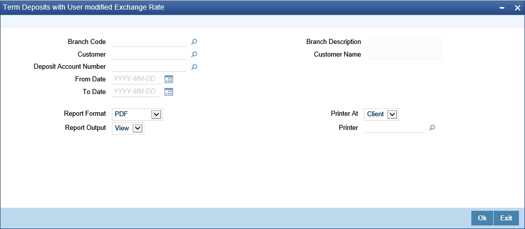

10.21 Term Deposit with User Modified Exchange Rate Re­port
You can generate a report that shows the details of all Term Deposits where the rate is modified by the user in the pay-out or pay-in grid. So all Term Deposits where Original and Applied Exchange Rate are different they are displayed in this Report. You can invoke this screen by typing ‘TDRRTMOD’ in the field at the top right corner of the application tool bar and clicking on the adjoining arrow button.
Enter the following details:
Branch Code
Select branch code of the account number from the list of values.
Branch Description
The description of the branch based on the branch code you select.
Customer
Select the customer from the list of values. The list displays all the valid customer numbers maintained in the system.
Customer Name
The customer's name based on the account number you select.
Select the customer's account number from the list of values.
From Date
Select the start date using the calendar.
To Date
Select the end date using the calendar.
Report Format
Report Output
Printer At
Printer
Enter the name of the printer or select it from the option list provided. The adjoining option list displays all the configured printers.
