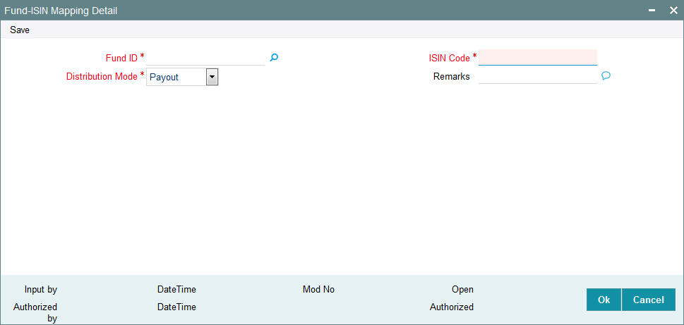

You maintain the association of each fund with the ISIN Code, in the ‘Fund ISIN Mapping Detail’ screen. You can invoke this screen by typing ‘UTDFNDIS’ in the field at the top right corner of the Application tool bar and clicking on the adjoining arrow button.
Select ‘New’ from the Actions menu in the Application tool bar or click new icon to enter the details of the Fund ISIN Mapping.

You can specify the following fields in Fund-ISIN Mapping Screen
Fund ID
Alphanumeric; 6 Characters; Mandatory
Specify the ID of the fund that you are associating with an ISIN code and distribution mode in this screen.
ISIN Code
Alphanumeric; 12 Characters; Mandatory
Specify the ISIN code to be associated with the fund that you have selected, for the selected distribution mode.
Distribution Mode
Mandatory
Select the income distribution mode applicable for the selected fund and ISIN code from the drop-down list. For a fund-ISIN association, you can only associate one income distribution mode. The options available in the drop-down list are as follows:
Remarks
Alphanumeric; 255 Characters; Optional
Specify any applicable remarks for the fund-ISIN-distribution mode association.

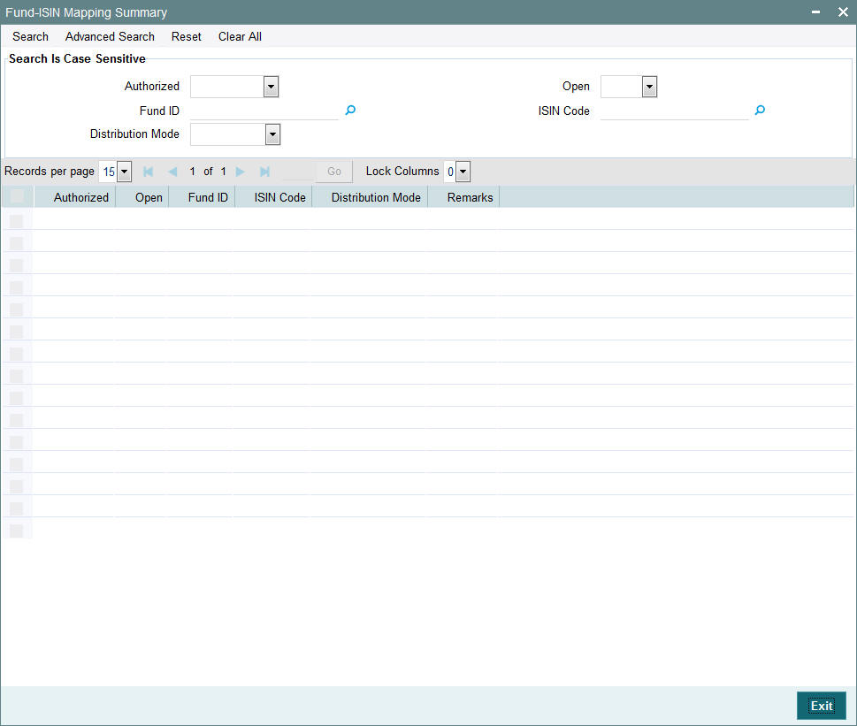

Invoke the ‘Fund ISIN Mapping Summary’ screen by typing ‘UTSFNDIS’ in the field at the top right corner of the Application tool bar and clicking on the adjoining arrow button. The following screen is displayed:
You can retrieve a previously entered record in the Summary Screen, as follows:
In the Browser, select Fund ISIN menu and click on Summary, specify any or all of the following details in the corresponding fields:
Click ‘Search’ button to view the records. All the records with the specified details are retrieved and displayed in the lower portion of the screen.
